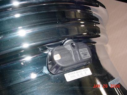

We run into this all the time and separate "TPMS" wheels from "non TPMS" wheels for the same car in our system. Most of the wheels we carry will accept the sensor, which is a transmitter and part of the valve stem. Most cars we run into will not allow a dash light to be turned off unless a transmitter is installed into the wheel. So I doubt taking it to the dealer will help, but it's worth asking them. Here's one installed in a wheel....
