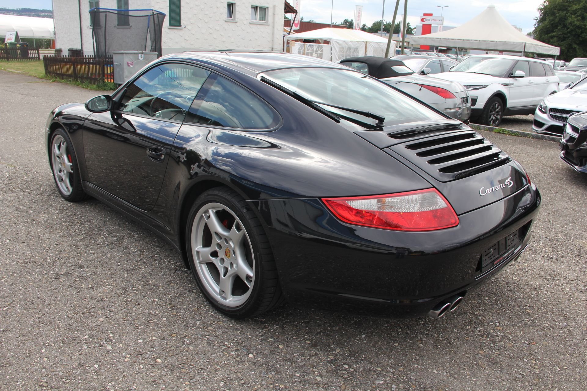

I have a 997 4S with sport chrono plus and code:
475 T Porsche Active Suspension Management (PASM)
XRP F Wheel spacers 5mm
This PASM option seem to be standard equipment according to the spec list on my swiss version. No sport suspension in spec list. Is this lower than a car without PASM?
What is the best option for a lowprice lowering? I dont want too stiff / too low. But maybe 10-20mm lower.
Pictures of my car
