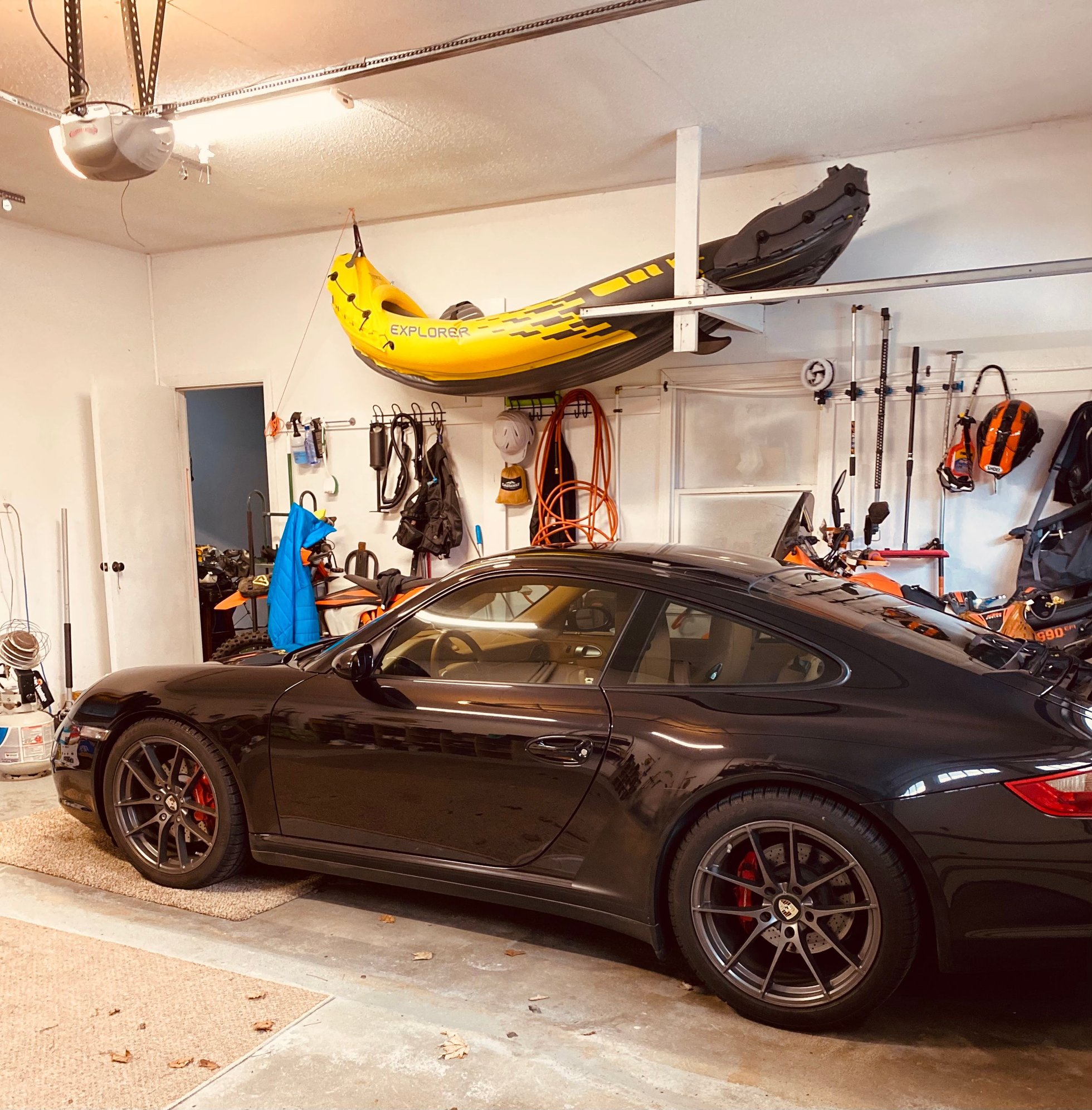

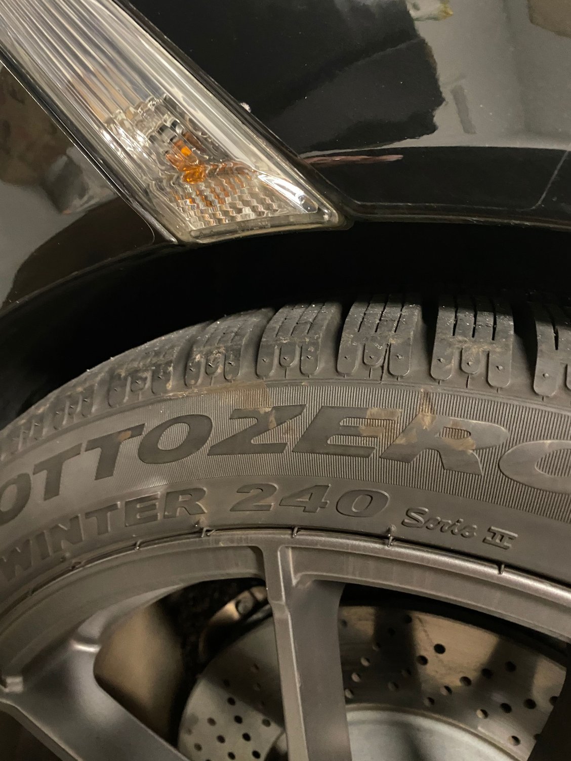

they will definitely fit BUT you need 7mm spacers up front or the 240 tire will rub on the strut base. Ask me how I know
I have a winter set of Stark 19” with Sotos on my 997.1 C4S in these exact sizes from a 991.2 C4S
my summers are HRE 19’s with the same specs you listed from Tire Rack.
