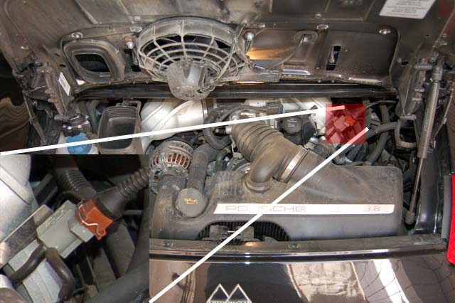

I took a picture:
Push the pin on the orange/brown plug; and then pull out the plug.
PSE always on .. been running it this way for over a month, no issues.

I never noticed if the exhaust cuts out in sport mode. I should try it today; I believe with the unplugging of the brown cable, the PSE is always on (no cutoffs) regardless. Maybe they are using a different system to enable/disable the loud part.

On my car (removed the brown cable); the exhaust is always on .. always loud regardless of sport button.
