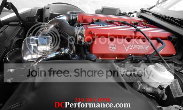

In the past it has been really difficult to make good power and pass emissions here in California. We wanted to come up with a package that would pass the strict visual and tailpipe emissions and make super car power. We used our EED forced induction ready engine package and Paxton smog legal supercharger package to meet this criteria.
We used a 2002 ACR for our first test. The 2002 models have the most stringent emission standards for the Gen 2 cars. We had to use a short overlap blower camshaft, to pass the miss-fire monitor, an exhaust and O2 sensors that would allow for quick 02 and catalyst warm-up and an effective sealed crankcase ventilation system.
The results were impressive. With 11-psi boost we achieved 890rwhp. The car has a lumpy idle and makes very linear power. Some other upgrades that really improved this build are our fresh air intake system and dual pusher fan upgrade.
Thanks to Greg Stocket for allowing us to do this build. We are excited about seeing it run at Mopar’s at the strip next week!

the build
We started with our forced induction engine build. This consists of a forged bottom end, better rods, bearings, pistons, balancer, timing chain, blower cam, low bleed lifters, oil pump modifications, head studs and JM head work. This is a pretty good foundation for up to 900rwhp. The fuel system is upgraded with a modified tank module, external pumps, regulator and bigger fuel injectors. The exhaust is an E.O header with heat shields, factory cats and Corsa Catback. The SC System is an off the shelf Paxton E.O legal kit with a pulley change. In order to reduce intake temperatures we added our fresh air intake system and pusher fans.
Here are the results...

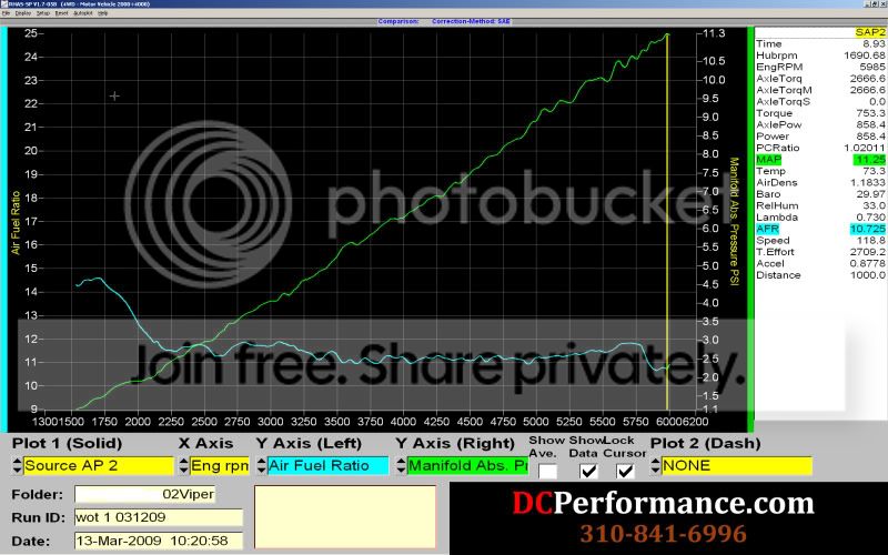

The production catalysts are pretty stout even when you double the hp of the engine. The key is to keep the air fuel ratio right so you do not overheat them. If used on the track for continues wide open throttle sessions their service life would diminish. For a track (off road) application we would delete them. Here is the air fuel and boost information for this build:

On the forged bottom end cars we feel comfortable with power levels up to 650rwhp for the street. Higher numbers are possible but reliabilty could suffer without better parts.
