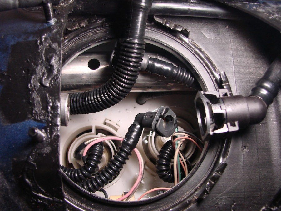

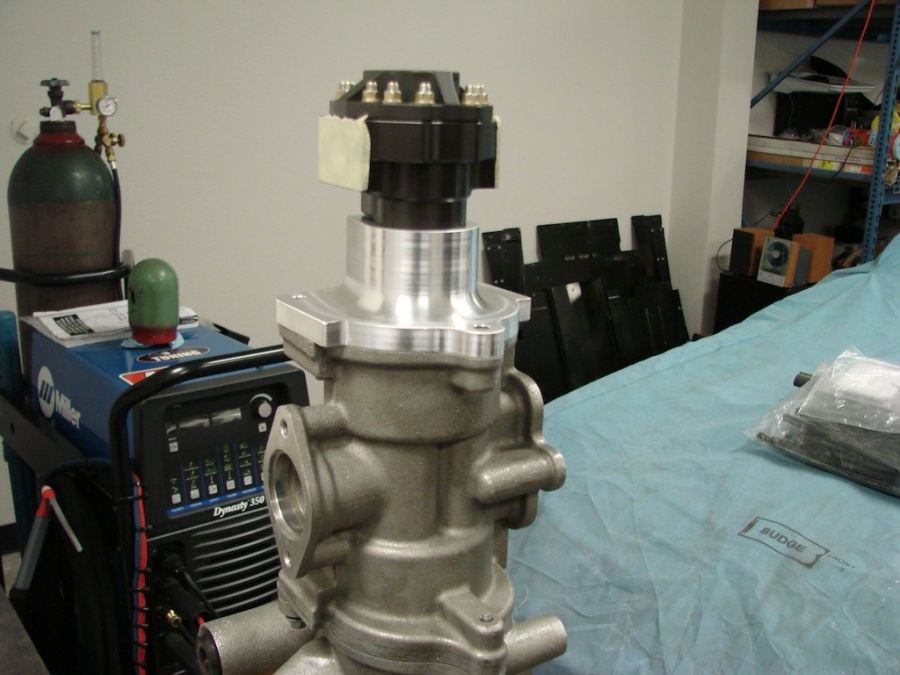

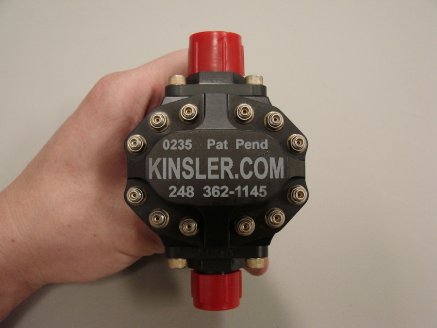

Mechanical Pump seemed to be the option that offered the most long term flexibility. A Kinsler Tuff Pump was the choice for me. Kinsler offered a lot of technical support and experience for us to lean on as the build progressed.

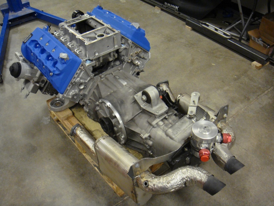

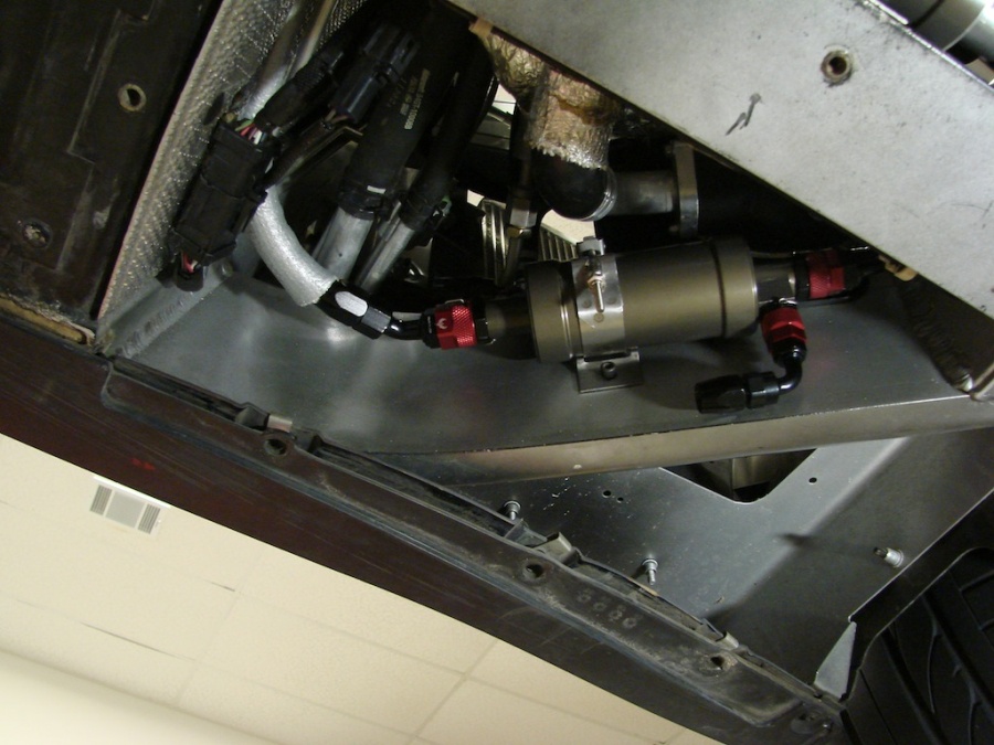

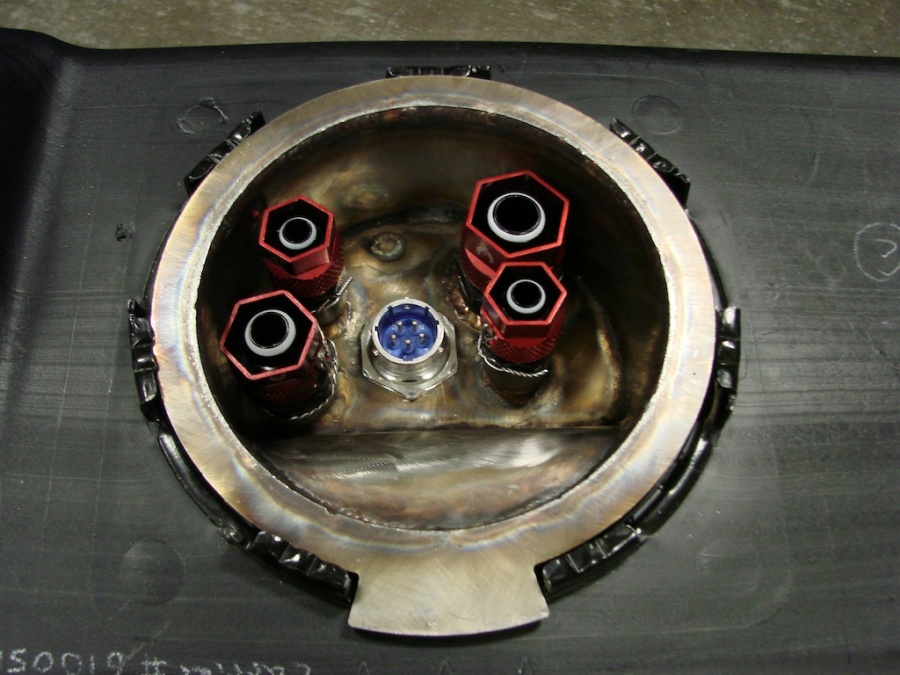

Among many changes, this new fuel system required a return style fuel system and some heavy duty inconel heat shields.

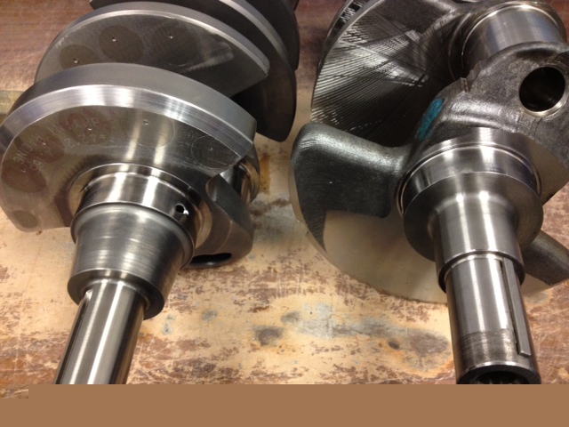

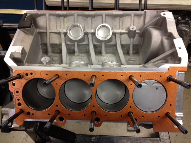

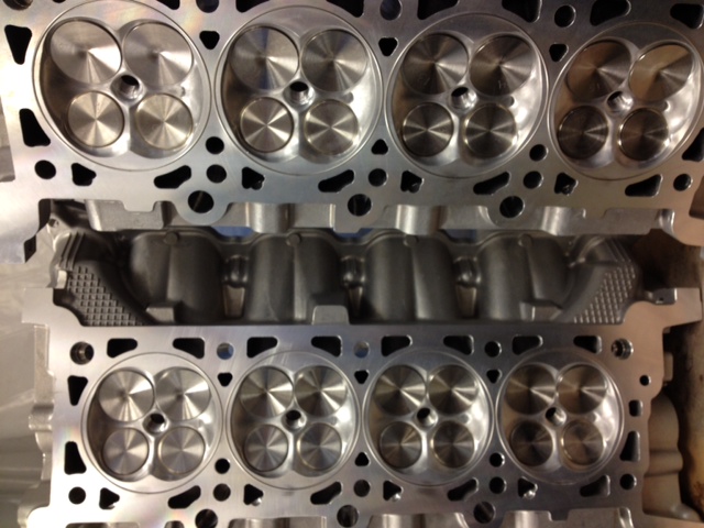

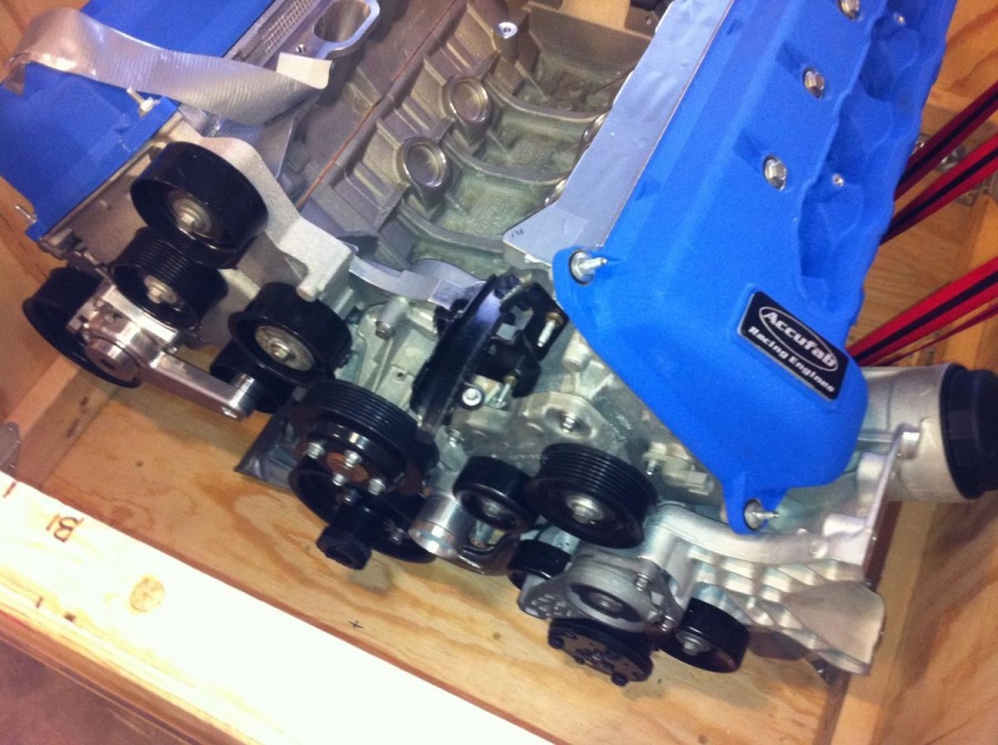

I sent the motor to Accufab for the engine build. John Mihovetz seems to have a pretty good handle on the Ford mod motor. We did the full workup. He said the motor was good for 1700hp via turbos but couldn’t say what it would do with a big meat grinder on top. Billet Crank - J&Es - big ports - racing cams - you know, the works…

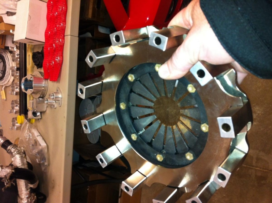

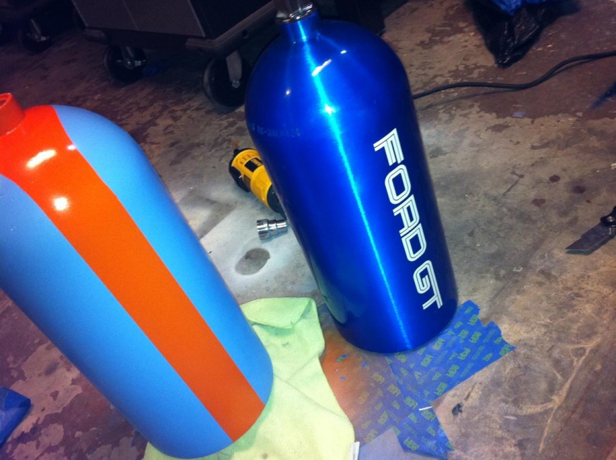

We threw a Tilton 4-Disc Carbon clutch in there and a little blue pill, just for good measure.

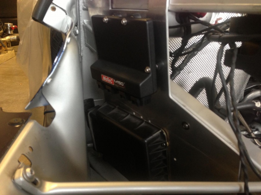

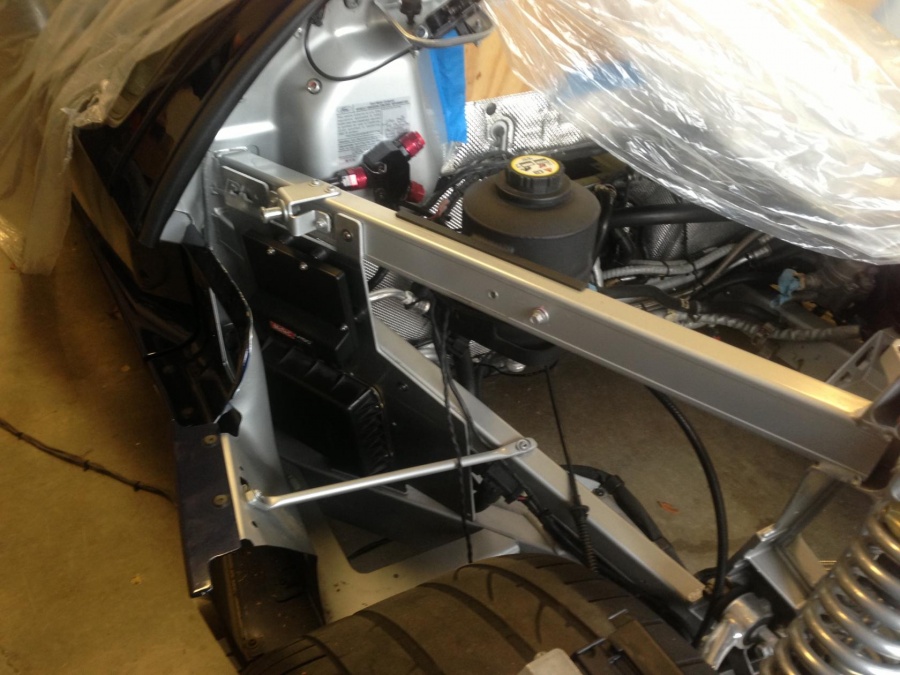

Had to walk out for lunch. Here are a few of the MoTeC stuff. Added: traction control, boost by gear, knock sensors, launch control, flex fuel capabilities. It should be really trick when its all done.

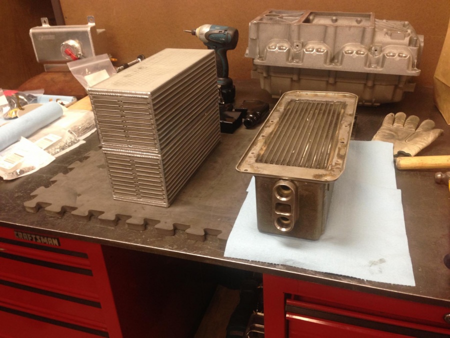

Also bumped up to a 4.5L Whipple 2000cc injectors and 2x1000hp honeywell intercooler cores.
