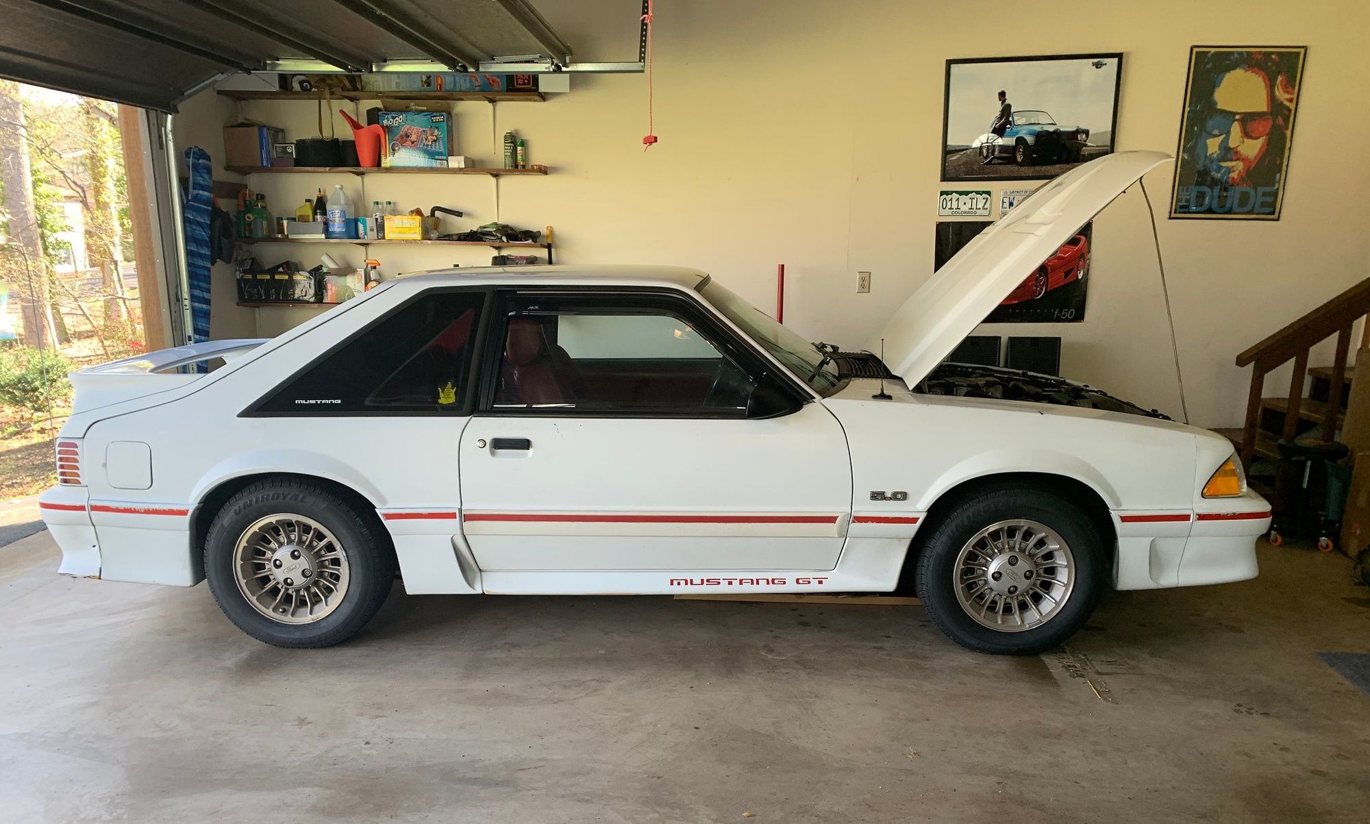

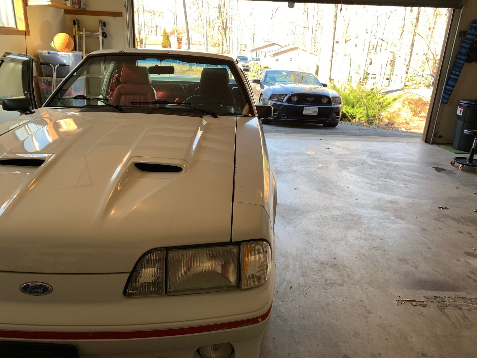

The Fox is a five speed...so hopefully that doesn't mean it doesn't qualify for inclusion on these forums.
I've always been a huge fox body fan. First Mustang I ever rode in was a Fox Body. First Mustang I ever drove in was a Fox Body and when I first really got into cars as a teenager, I hung out with a few guys who had modified Fox Bodies and needless to say, I've wanted one ever since. Well, in January I finally picked up my first Fox Body. It's a 1988 GT, white with the red stripe around the middle (Vanilla Ice style-ish, lol). I've been trying to do some small things when I have time to work on the car.....like fixing the horn, replacing some minor exterior and interior pieces, returning the CAI to stock, etc. It definitely needs some more work like fixing some oil leaks and addressing some rust but overall I'm pretty happy with the car and I'm looking forward to continuing work on it as sort of a resto-mod/occasional weekend track car, in the coming months and years. I've documented my progress in some threads on other forums but trying to cast a wide net so I can get as much insight and guidance as possible from other auto enthusiasts (and to shamelessly plug the project as I document it on my YouTube Channel).

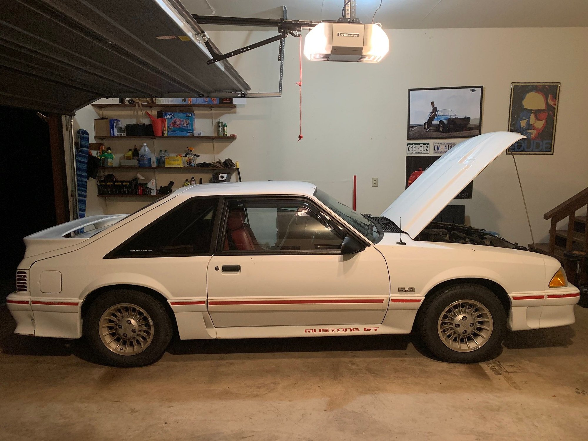

Anyways, here's the car (along with my 2014 GT):

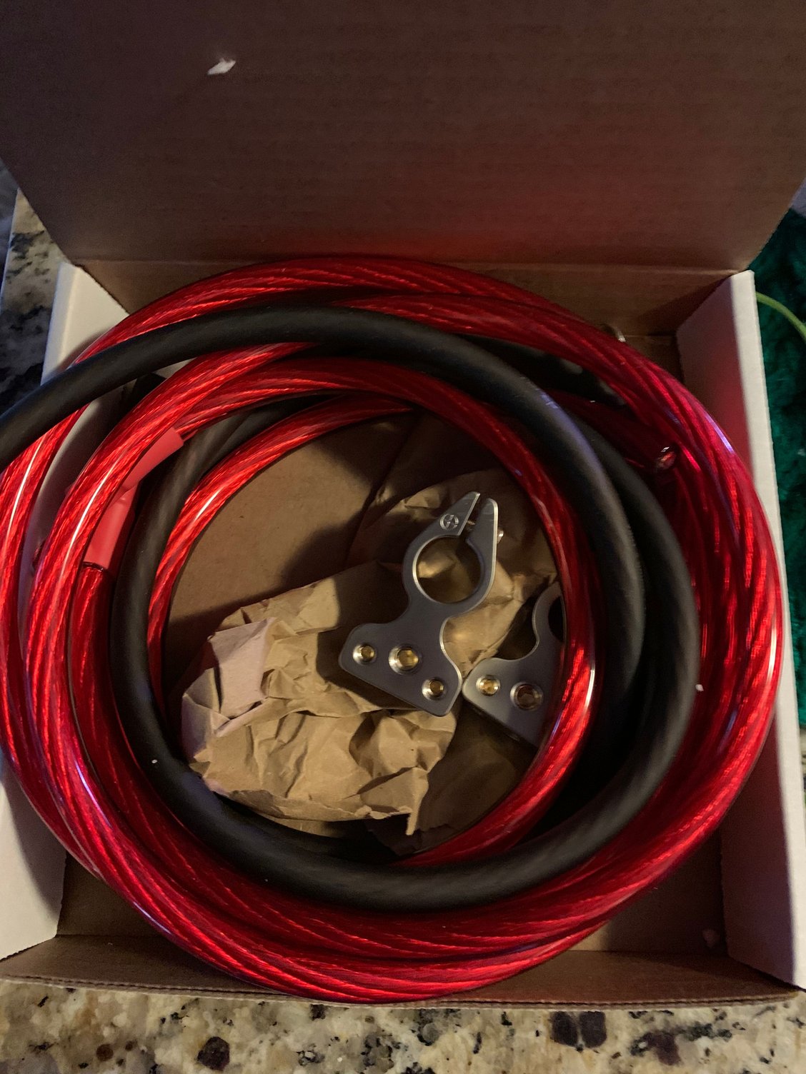

In other battery-related news, my PA Performance battery cable kit arrived a couple of days ago. The current positive battery terminal has a crack in it which I didn't notice until very recently.

Last night I replaced the old battery cables, which were in even worse condition than I thought, with the PA Performance kit. I couldn't figure out the alternator cable yet because I couldn't see where it was routed exactly...but I will try to get that installed sometime in the next few days.

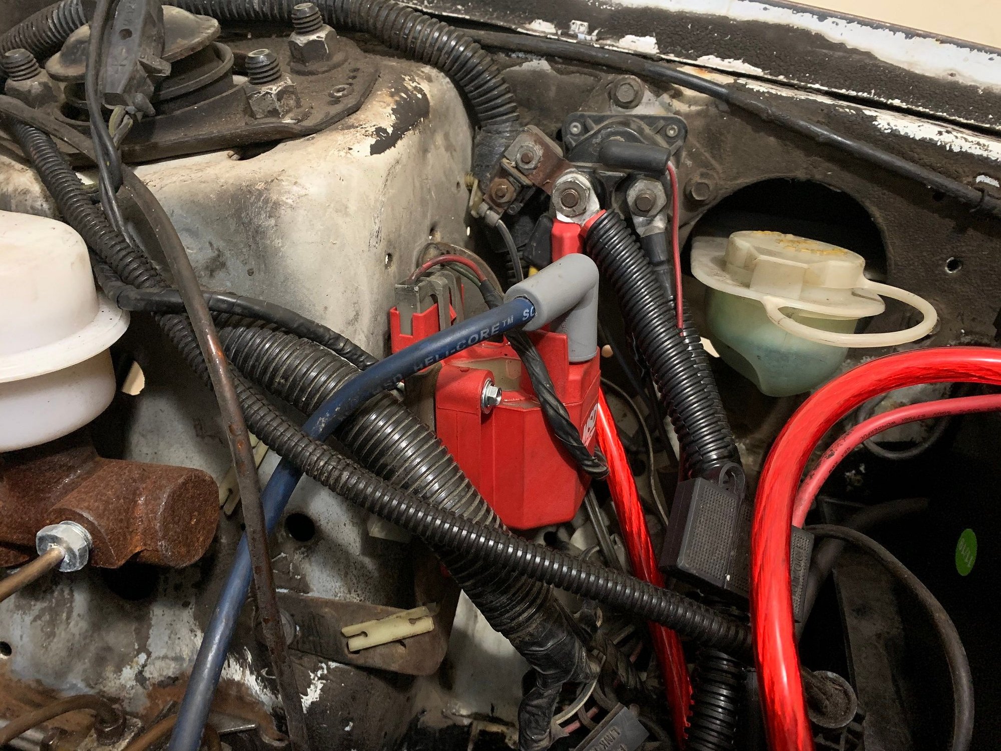

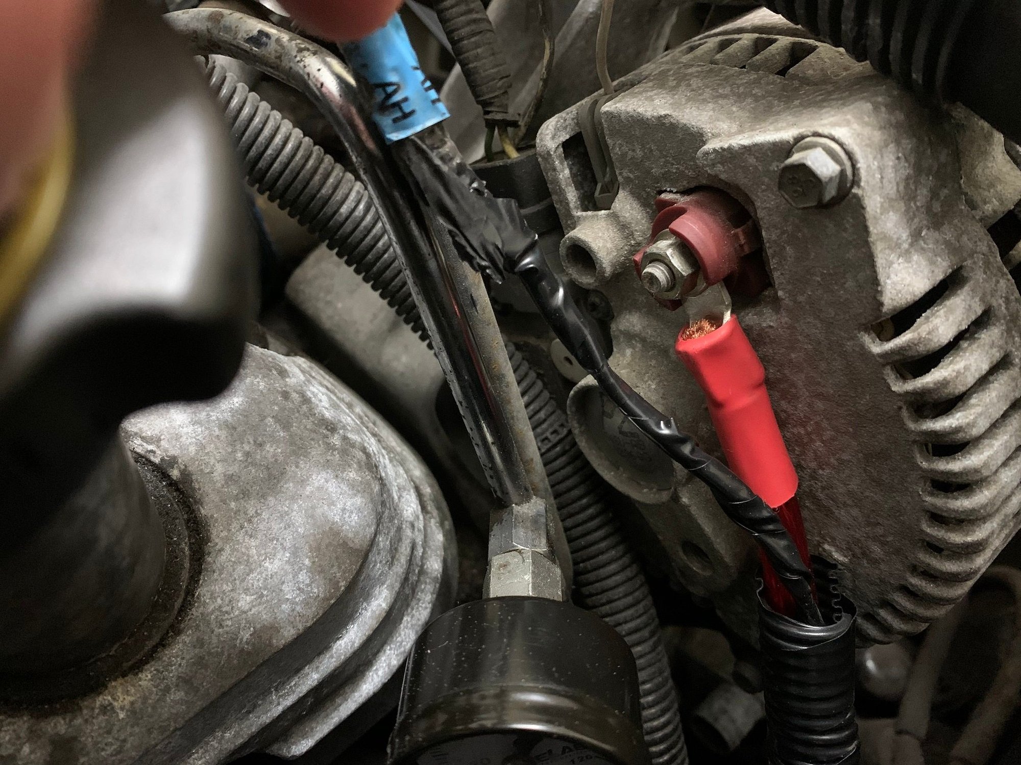

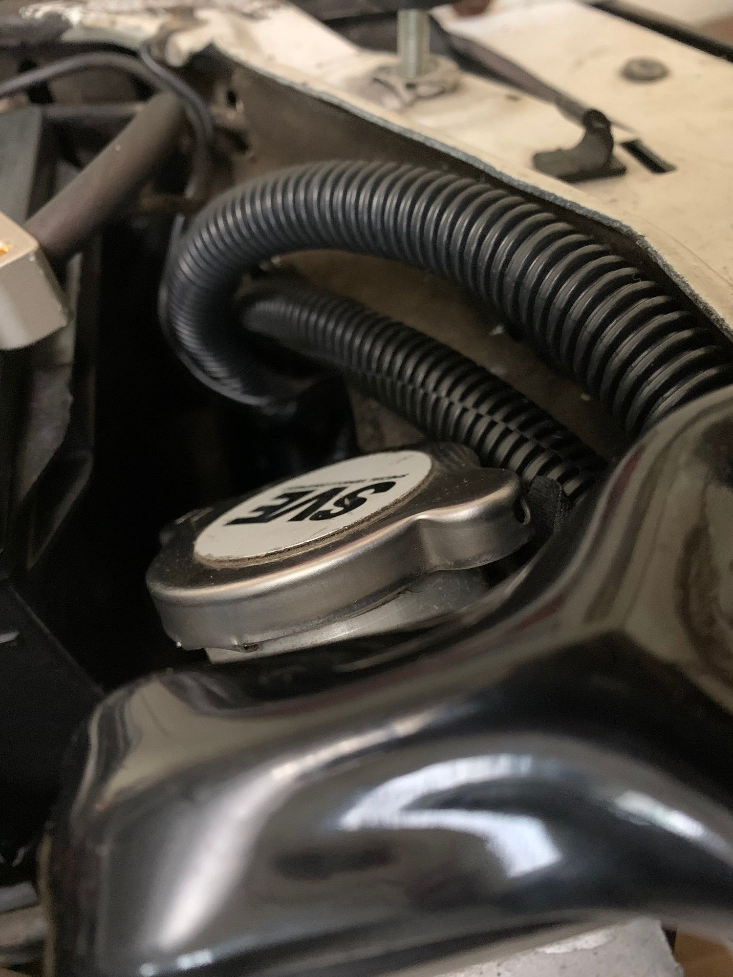

Happy to report that I finally got the alternator power cable finished. I ended up running the power cable in one loom and the rest of the wires in a separate loom. It took a while but I got it looking how I wanted it, for the most part. I might need to redo the tape around some of the clips but for now, I'm pretty happy. Trying to get both looms to sit well and fit underneath the battery tray took the most time.
The car has been running pretty well since I got this taken care of. No issues starting/turning over. In the meanwhile, someone pointed out that it looked like whoever did the brake upgrade on my car may have used copper brake lines, which is apparently a no go. So after some research on the forums, I ended up recently ordering a 1993 Cobra master cylinder and a brake line kit. I believe I have everything I need for that but I do still need to pick up another can of POR-15 to use on the shock tower so I can do both of those at the same time.

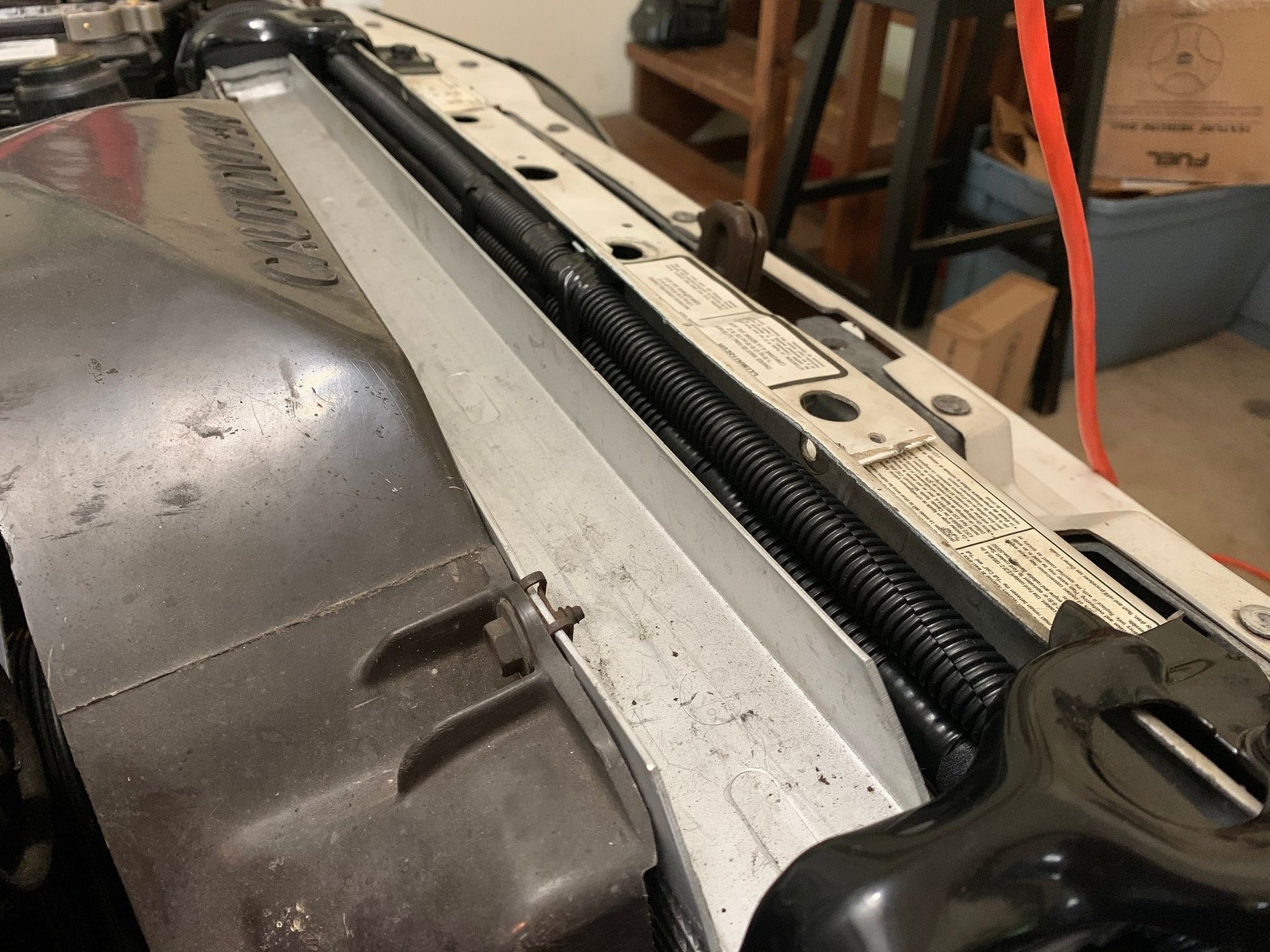

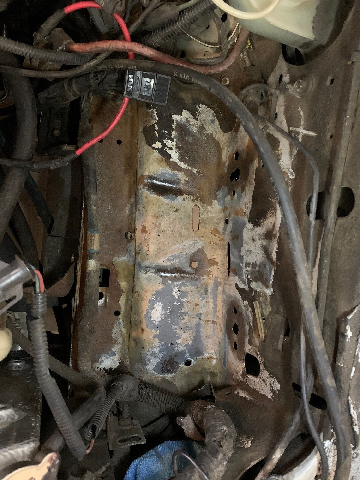

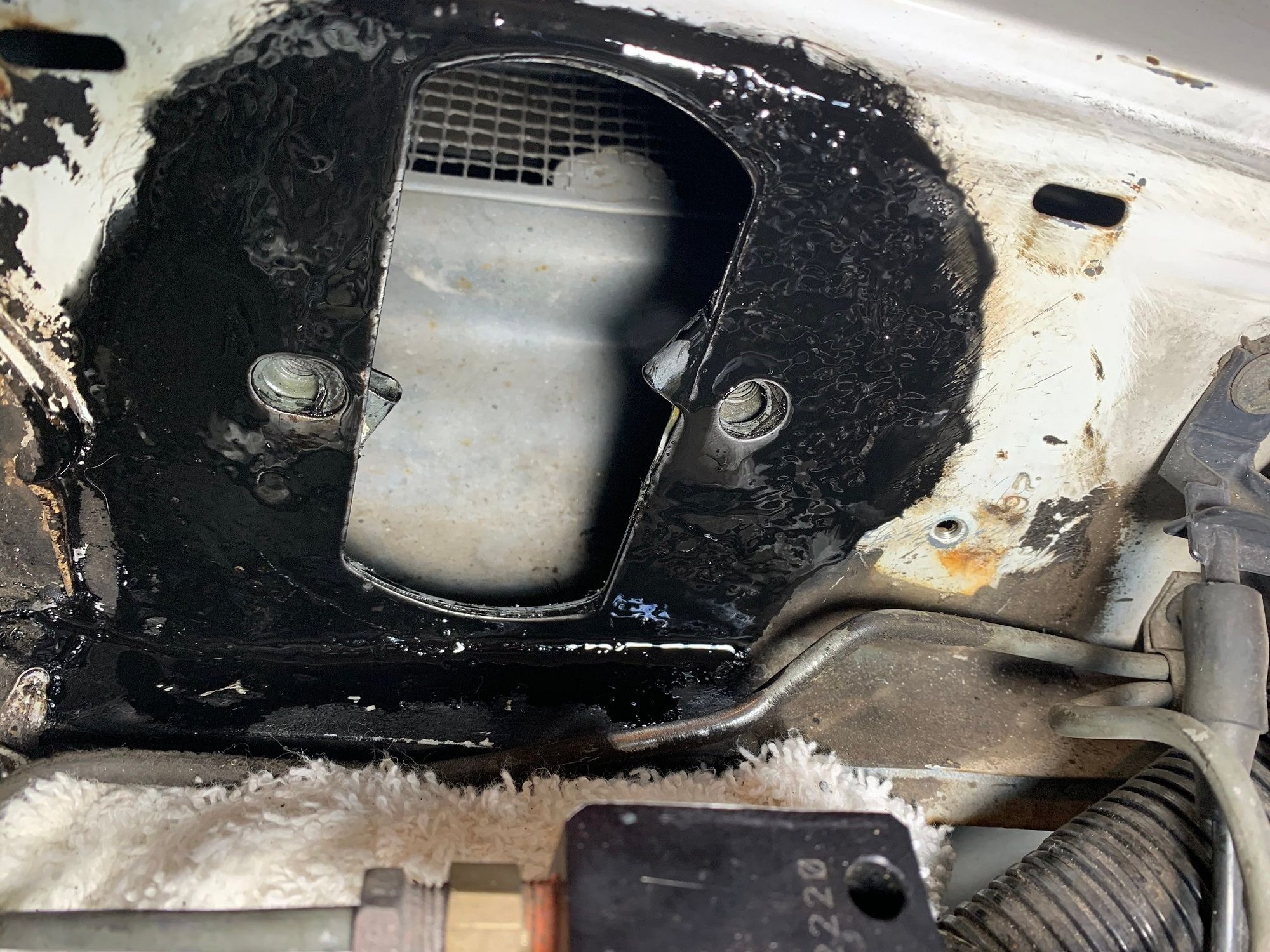

My latest efforts on the fox body - I replaced the lower door hinge tension spring so now the driver side door is actually able to stay open without having to prop it up with a jack stand or cinder block. Kind of hard to explain without a video or gif but it did the trick.

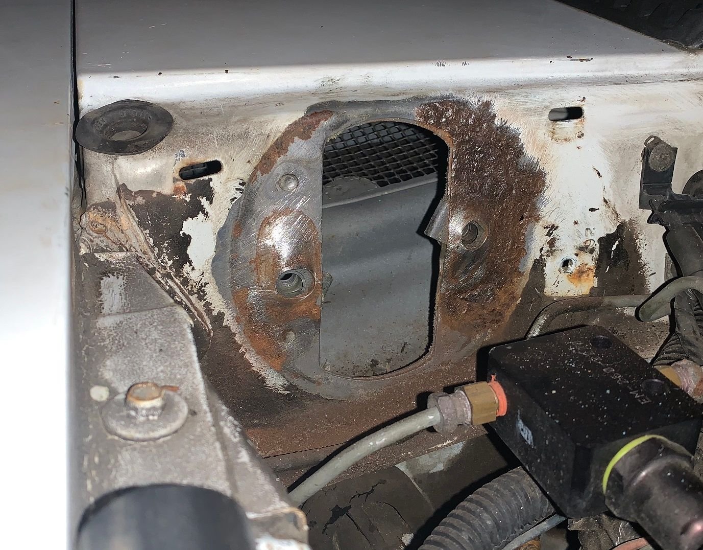

I removed the hood, which was easier (and lighter) than I expected because I was planning to replace the hood hinge cups. Ended up discovering some more rust in that area so I've been working on that with my drill/wire brush bit.
Here's how the passenger side looked after I pulled that side out:
And here's how it's looking after my first pass at cleaning up:
I'm going to be working on this and removing the brake master cylinder, then brushing/cleaning/treating/painting both these areas and the shock tower, before putting in the new brake MC (1993 Cobra), brake lines, hood hinge cups, and a hood to firewall seal. Depending on when some recent parts I ordered arrive, I will hopefully also be getting started on replacing valve cover gaskets and cleaning/painting both the valve covers and the upper intake manifold.

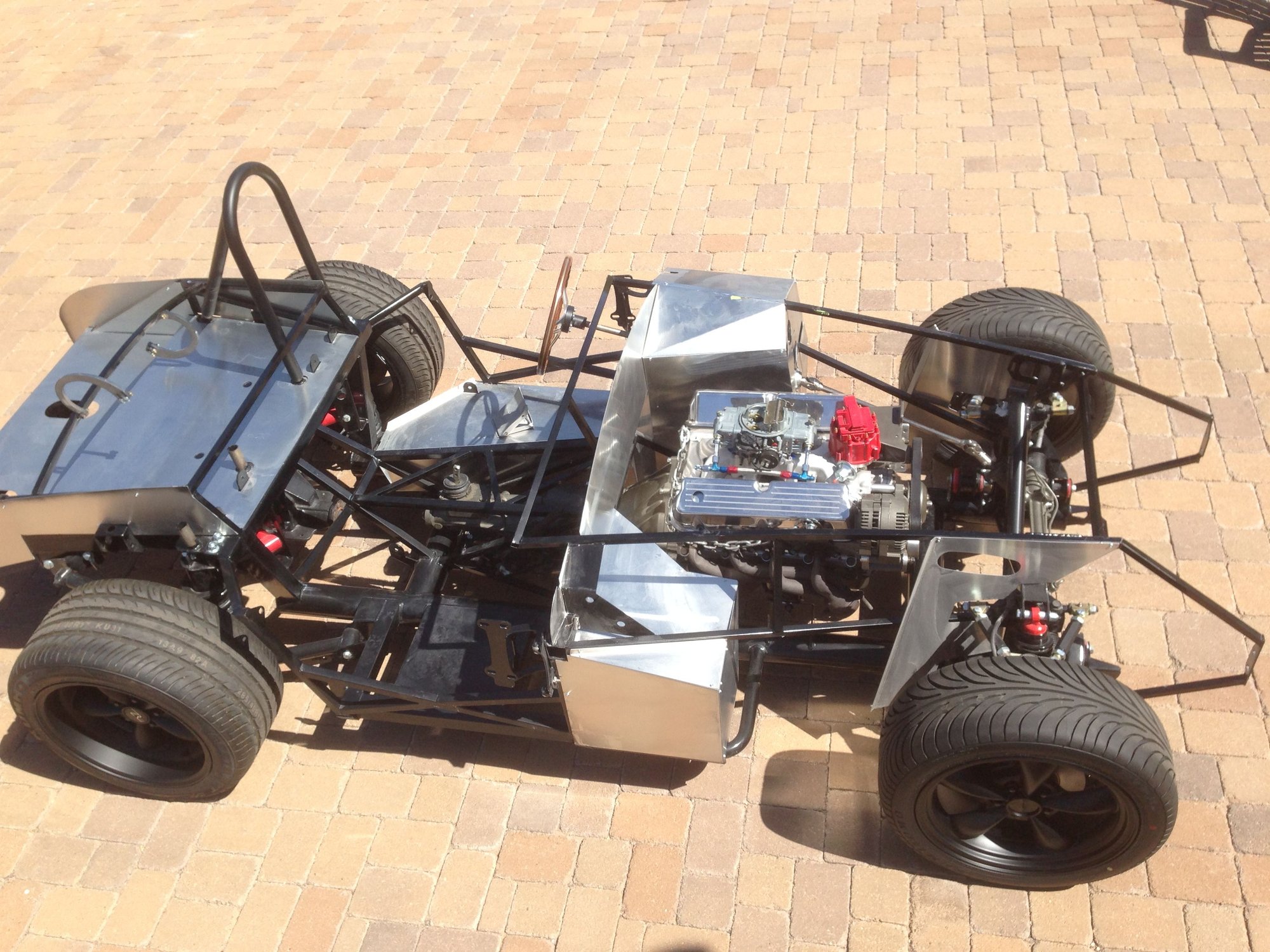

I never thought about the compatibility with FF Cobras but it makes sense...what sort of engine/drivetrain does your use? Does it share any suspension parts with the Mustangs?
Factory Five Cobras (Roadsters are they officially called BC of a Lawsuit from Shelby using a tradmarked name) were originally designed as a kitcar utilizing the Mustang Fox Body years. The kits are pretty flexible and you can decide how much or little of a doner car you want to use. The aftermarket parts world can also supply more custom or competition parts. If you want to go economy, the kit frames are designed to accept the entire suspension/steering directly from the doner car. This includes the entire rear diff/axles. Most builder will use aftermarket steering/front suspension parts.for a more updated geometry. I did.
For engines, these kits can go in a lot of different directions - Ford old school, modern Ford using the Mustang's EMS. or even Chevy format V8s. I went with a Ford 302 old school. Here is a pic of my chassis and finished car.

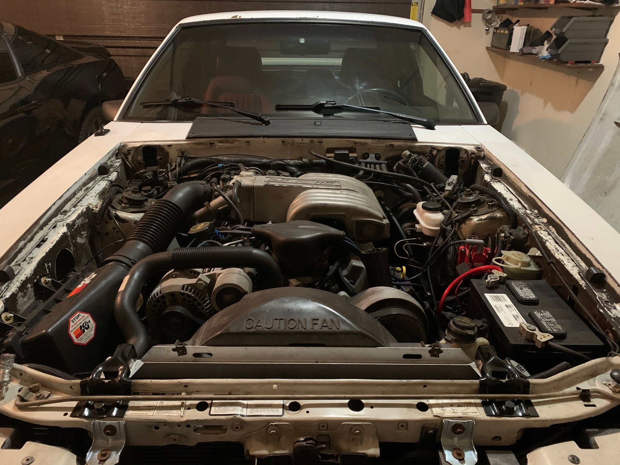

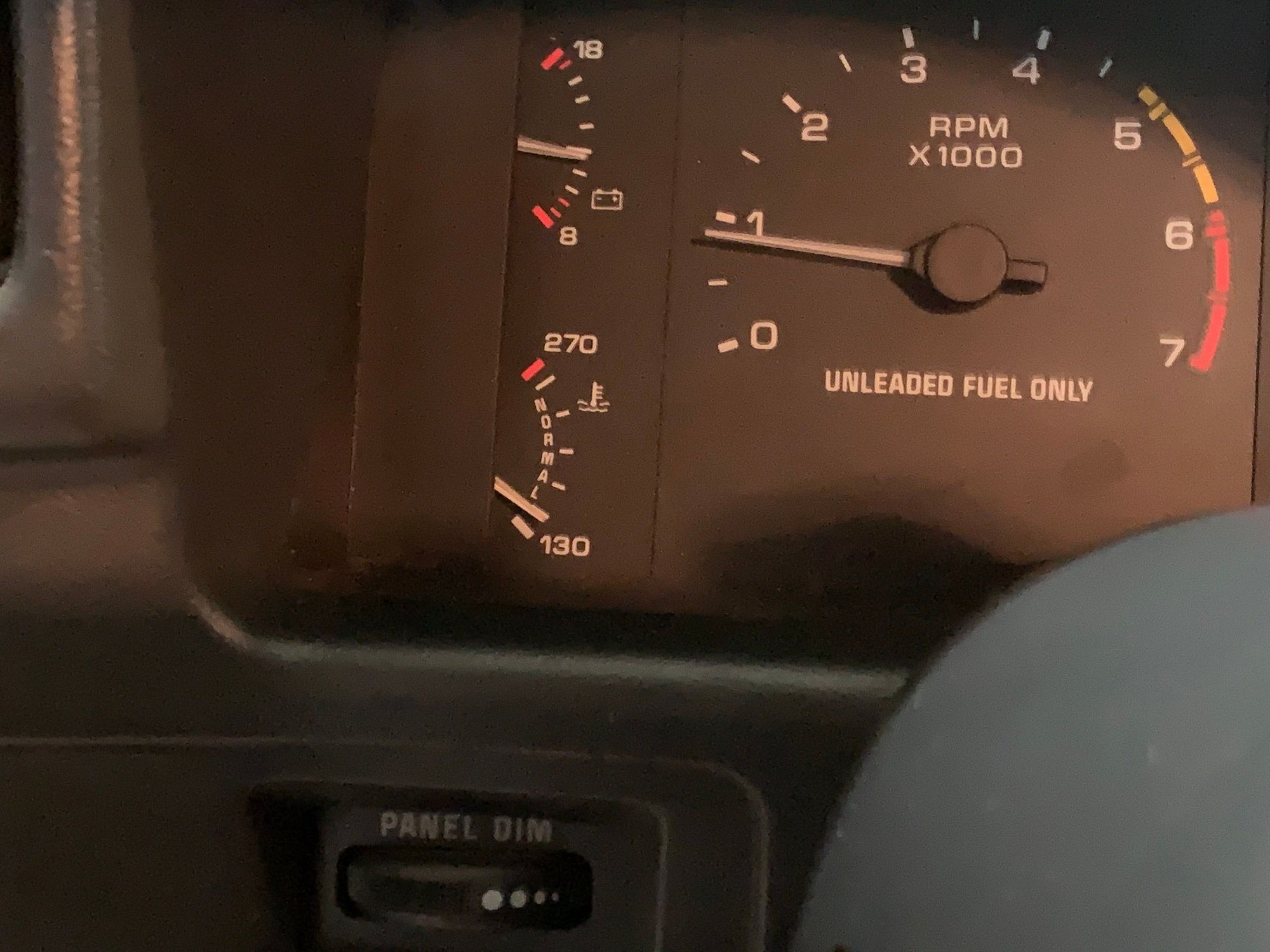

Latest on the Fox Body....I got the temperature gauge working, after replacing the temperature sending unit.
I got the POR-15 kit applied to the areas around the hood hinge cups and on the driver side shock tower behind the factory proportioning valve.

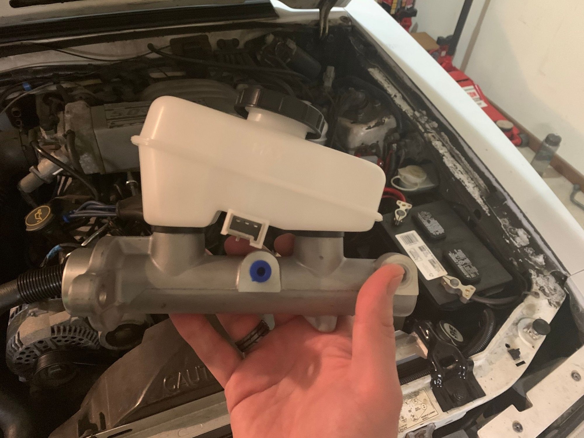

Also finally got the brake master cylinder out, but had to go a very painful route of pulling out the brake booster as well. It ended up being a good thing though, since I found that the bottom of the brake booster is looking pretty rusted, presumably from having brake fluid leaking on it over the years.
I ended up ordering a reman unit from Auto Zone, which is supposed to be here next week *fingers crossed
Once that arrives, I will double check and make sure I have everything I need as far as hardware, then I need to bench bleed the new 93 Cobra master cylinder, get everything put back together and get the brakes bled.
I am planning to replace the valve cover gaskets and intake manifold gaskets, and also clean up and paint the valve covers and intake manifold. I've got some cleaning to do underneath the car as well, to see if I can better identify some of the oil leaks (assuming rear main seal at least, possibly the oil pan gasket as well). Beyond that, I'm waiting for my Koni shocks to arrive and then will continue piecing together the suspension.
