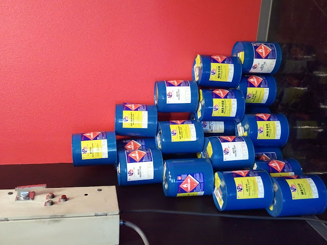

Are you running Q16 at this power level?
Congrats on the sick numbers, btw!!
