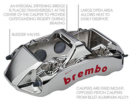

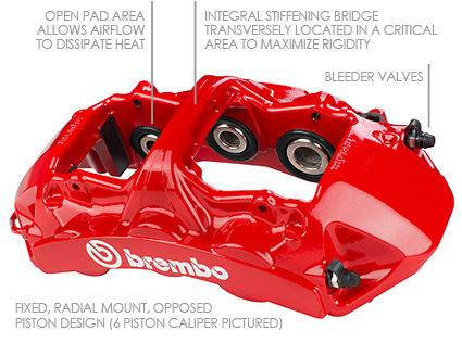

Most OE calipers are of a sliding design, with piston(s) only located on the inboard side of the disc. While this type of caliper is inexpensive to manufacture, it is generally extremely heavy, and inherently flexible under braking, which significantly degrades performance. Conversely, Brembo's calipers are a fixed radial or axial mount design with opposed pistons and constructed from aluminum alloy. Despite being much larger and many times stiffer than the sliding OE caliper, they are also much lighter which benefits overall vehicle dynamics.
The caliper body has been designed to be as light as possible while meeting stiffness criteria.

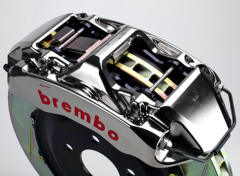

The GT-R option
The Porsche 997 Turbo kit is available in the GT-R option. GT-R stands for Grand Turismo Race and monobloc calipers are machined entirely from billet with a nickel plated race finish to provide both the features and benefits of a racing brake system. This includes improved stiffness and thermo-mechanical resistance which is critical in high-performance applications.
GT-R's twin seal design provides race level performance without compromising the low maintenance aspects of a Brembo OE system. Ventilated stainless steel piston inserts are incorporated for heat rejection. The unique recessed dust seal design provides increased protection at elevated brake temperatures....another Brembo innovation.

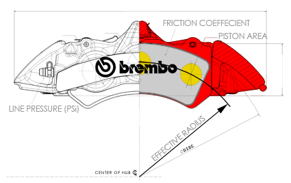

DISC THERMAL CAPACITY
A. Mass: The area located in the outer ring of the disc (shown in orange), dictates thermal capacity. This consists of annulus, width, diameter, air gap, and vane design.
B. Annulus: The area between two concentric circles. This dimension directly correlates to the friction surface area of the brake pad.
C. Disc Width: The overall thickness of the disc. Calipers are designed for a specific width.
D. Air Gap: The area located between the rotor plates surface is airgap. The amount of airgap is a crucial factor in channeling airflow.
E. Vane Design: Exclusive venting system that improves cooling capacity which increases resistance to brake fade.
Brake systems are designed to operate best within a prescribed temperature range. While modern high performance friction materials broaden this temperature range, it is critical that the brake disc in a system has adequate thermal capacity.
Thermal capacity, or heat storage capacity, is determined by how much weight or mass is located in the outer ring section of the disc. This is the area where the friction surface of the disc meets the internal vanes (orange colored area in the diagram shown). The more mass located in this area, the more thermal capacity a disc has.

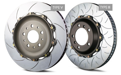

Type V and Type III discs are an option for enthusiasts seeking to improve rotor longevity.
