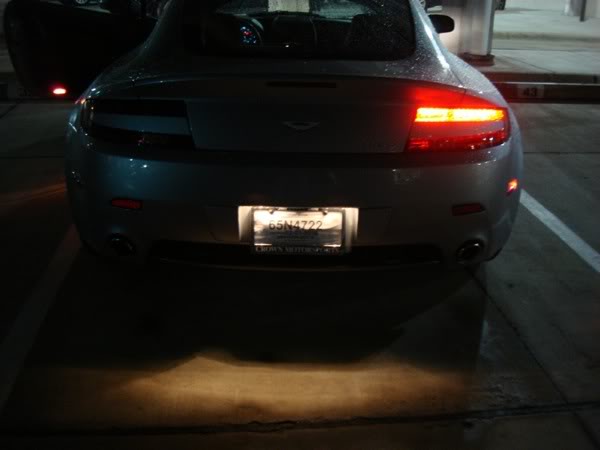

Last week the “Bulb failure Left turn indicator” warning came on the dash of my out of warranty Vantage and then a day later I noticed that the LED strip on my right front headlight was not coming on. I am not sure if both problems occurred on the same day or not. Has anyone here seen this before?
Thanks in advance!!!!!
Here is the rear with the light switch in the 2nd position
Here is the rear with the light switch in the 2nd position and the left indicator on....notice the faint blink

Thanks for your input and kind words!! Upon closer inspection I see some condensation in the rear light housing so I think it was the moisture that caused the failure of my rear taillight. In addition, when I turn on the headlights the front right led strip comes on for two seconds so I know that it’s not dead.
I am crossing my fingers that purchasing a new rear taillight will solve both problems. It was not a planned mod but I purchased the DBS style rear brake lights and 3rd brake light from RSCTuning today and they shipped overnight it to my office. A Big Shout Out to Hershel @ RSC for fantastic client service!!!!!!! I will update my post with install pics and let you know if my problems are over.

Yup! I installed the left and right rear and the front right led popped right back on. I will snap some pics when I install the 3rd brake light.

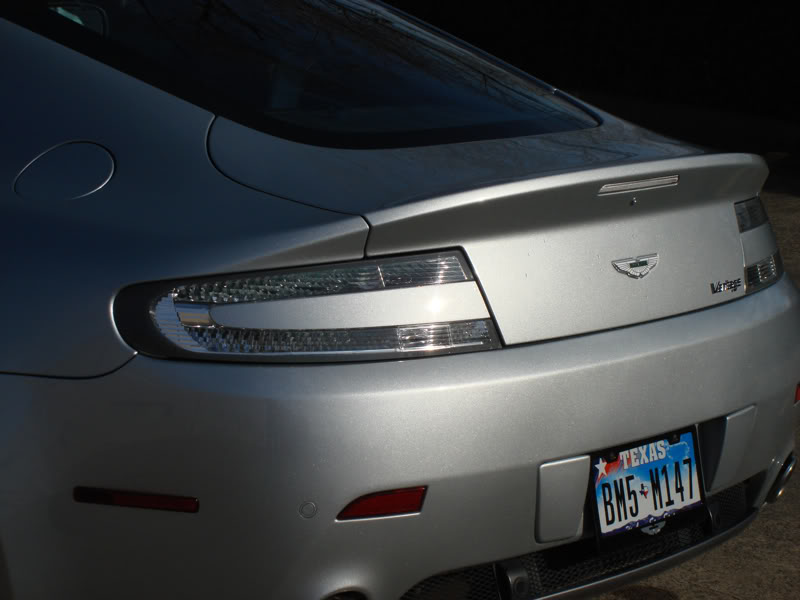

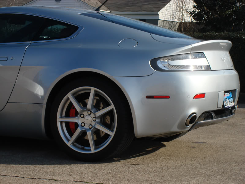

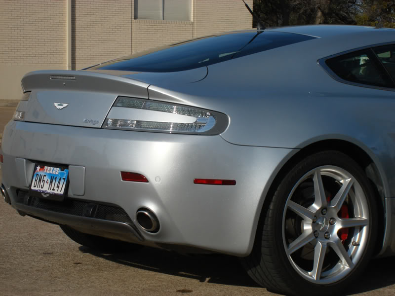

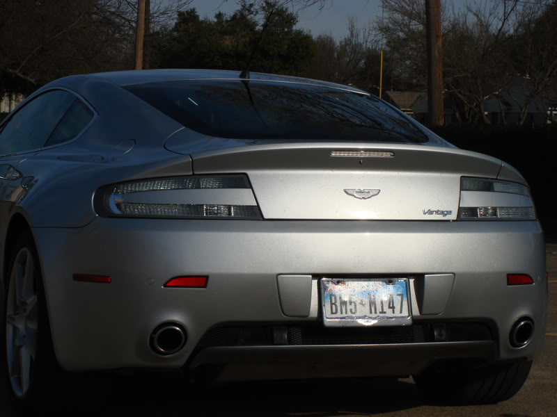

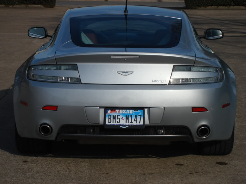

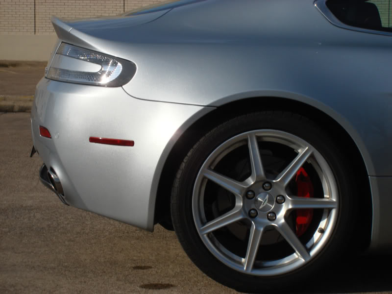

Great weather in Dallas today so I installed the 3rd brake light and snapped some pics.
Old Mar 6, 2010 | 05:02 PM
markesq's Avatar
Joined: Jul 2006
Posts: 659
Rep Power: 47
markesq has a spectacular aura aboutmarkesq has a spectacular aura about
They look great. I like them the best on a silver car.
