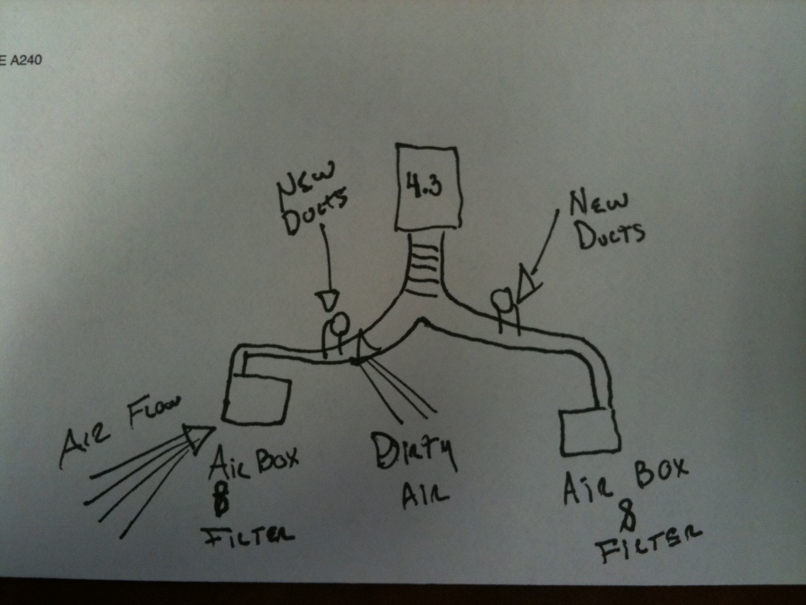

RPVantage's Avatar
Joined: Jun 2009
Posts: 388
From: Texas
Rep Power: 40
RPVantage is a splendid one to beholdRPVantage is a splendid one to beholdRPVantage is a splendid one to beholdRPVantage is a splendid one to beholdRPVantage is a splendid one to beholdRPVantage is a splendid one to beholdRPVantage is a splendid one to behold
Talking
This is the way i understand this sorry for the ugliest drawing that has been posted on this forum.
Please let me know i missunderstood
Old Jul 8, 2010 | 03:33 PM
  #38
ZedEx's Avatar
Joined: Jul 2010
Posts: 20
From: Wilmington, NC
ZedEx is infamous around these parts
If that's the case, there is unmetered air entering the engine, as the MAF sensors are still directly off the air boxes. This would cause major issues with drivability and engine safety (i.e. incoming air without fuel to supplement = lean condition).

vince_1972 is just really nicevince_1972 is just really nicevince_1972 is just really nicevince_1972 is just really nice
The just ugliest draw :
Old Jul 8, 2010 | 04:02 PM
  #40
ZedEx's Avatar
Joined: Jul 2010
Posts: 20
Good to know that's how it was executed, that will yield great results especially at speed.
