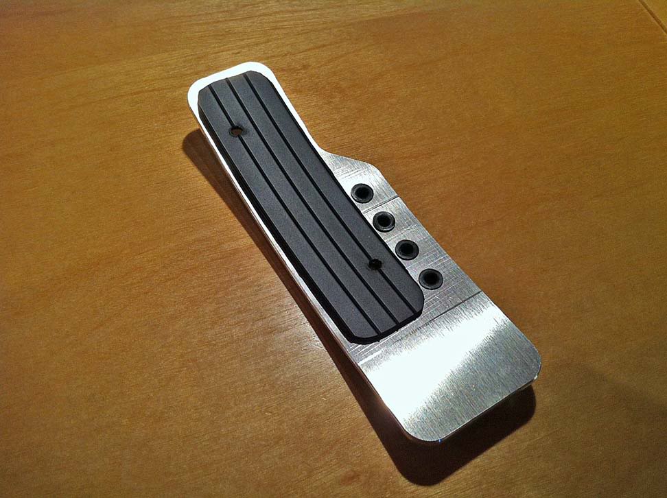

Received my pedal a while ago and finally got around to installing it this weekend. It really does work great. It's amazing that just an extra 1/2 inch in the width of the pedal can make such a difference.
While Seattle used cardboard to fill in the depression in the pedal arm (the rubber substrate for the cylindrical nubs seats in that depression), I wanted to use a resilient element similar to the original. I wasn't sure where to get rubber sheeting, so I just went to Home Depot to see what I could find. What I found is vinyl garage door weatherstripping that is about the same thickness as the OE substrate. It cost about $7. All I did was cut out a shape similar to the OE substrate. Worked perfectly. Pics below.

If you want to move the pedal closer, it'd probably be better to use the one rubber insert to fill in the depression and then a rigid spacer, possibly an aluminum one. Otherwise, the pedal would likely pivot side to side due to the flexibility of the vinyl. Also, you'd need longer screws. Not sure if it's possible, but it might be better still to adjust the pedal arm. BTW, one interesting thing I learned is that the pedal arm is plastic, not metal.

Hmmm, I guess the whole 'bend the pedal arm' strategy is a no go then ... Good point on the rigid spacer or thicker pedal idea. Do you find that the simple widening of the pedal is adequate for smoother throttle blips? At the moment I feel like I've really accomplished something if I happen to make a 5th/4th to 2nd heel-toe shift smoothly with the stock pedal set up :-s

I haven't tried it out on the road yet, I only gave it a try while the car was parked in my garage. That said, it was really easy to press the gas with the side of my foot while covering the brake, whereas I'd completely miss the gas with the OE pedal.

I bought one of the Ultimate Pedals after the recommendation of several here on the forum. I used the 1/2 inch extension, but I feel that the pedal is still too far away for proper heel and toe. Maybe I should've gone for a 3/4 or 1 inch extension. My Esprit's pedals are very close together which makes it much easier, but you can't use wide shoes or you'll press the brake every time you push down on the throttle.
Also, ISTR that Mike Bamford mentioned the Vantage uses one potentiometer on each side of the pedal for its throttle by wire. It compares the values from each pot and , if they exceed a certain threshold, it will put the car in limp-home mode. His concern was that putting a larger pedal extension on one side would cause the pedal to rotate slightly as it travels down because you aren't applying pressure squarely on it. If this happens, the limp-home mode could be triggered. Just FYI.

Interesting, didn't catch that one from Mike. Well, several folks have done this mod without issue, so I'm willing to give it a shot. Also, keep in mind that although there would be a moment applied to the pedal when only hitting the extended edge, the extension is only 1/2" so not that much of a moment arm and it's likely that you'll still hit a part of the center of the pedal anyway. Also, note that there should be little or no moment created when the pedal is used as normal and the whole pedal is depressed.

Thought I'd post an update. Haven't had any problems with the pedal, but also haven't found it easy to heel toe in actual driving. While I can reach the pedal with the side of my foot, it's still a bit difficult and I find myself missing the pedal with lower part of my foot by the heel. I actually find it easier to heel/toe with my M5, which has a gas pedal that is mounted to the floor. Considering ordering another pedal that is maybe an inch or 1.5 inches longer as the existing pedal is a bit short. Will let you guys know if I try this.
