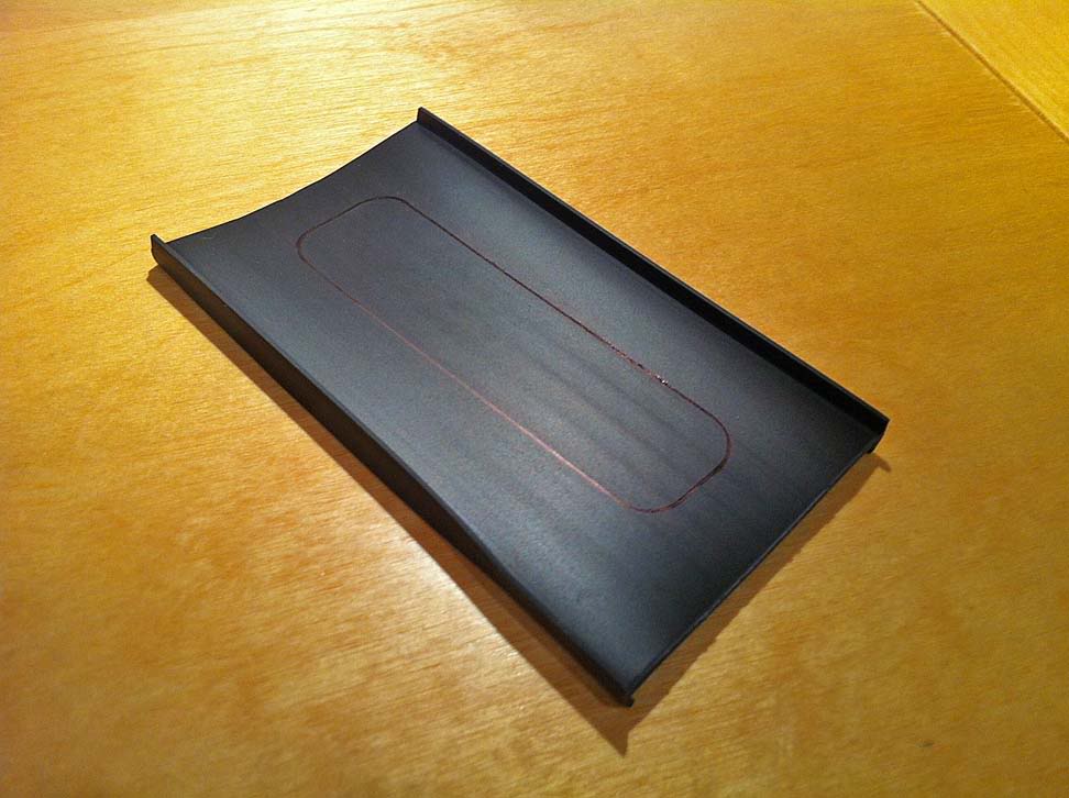

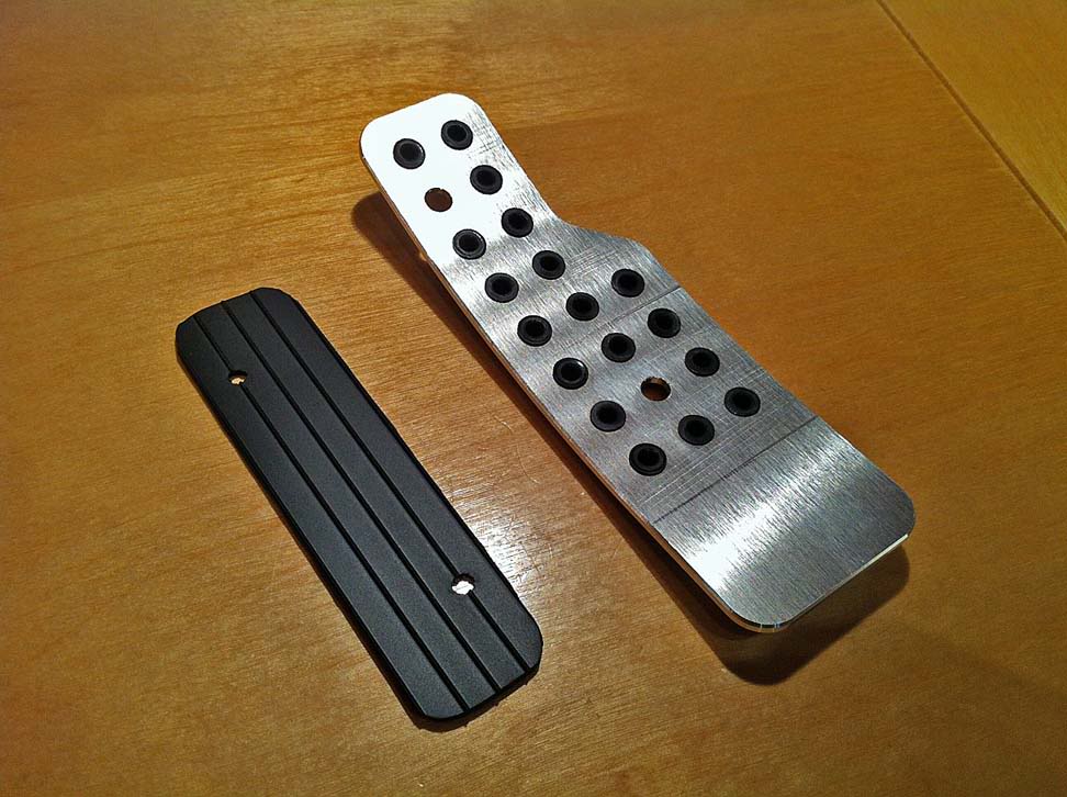

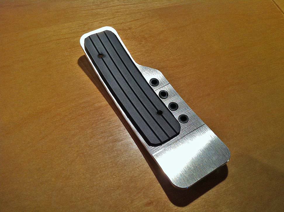

Originally Posted by Racer_X
Received my pedal a while ago and finally got around to installing it this weekend. It really does work great. It's amazing that just an extra 1/2 inch in the width of the pedal can make such a difference.
While Seattle used cardboard to fill in the depression in the pedal arm (the rubber substrate for the cylindrical nubs seats in that depression), I wanted to use a resilient element similar to the original. I wasn't sure where to get rubber sheeting, so I just went to Home Depot to see what I could find. What I found is vinyl garage door weatherstripping that is about the same thickness as the OE substrate. It cost about $7. All I did was cut out a shape similar to the OE substrate. Worked perfectly. Pics below.
Attachment 494819
Attachment 494820
Attachment 494821
Attachment 494822
Attachment 494823
Hi,
I talked to Rob from Ultimate Pedals and he says it’s not necessary to add a piece of carton / rubber. Why do you reckon it’s better?
