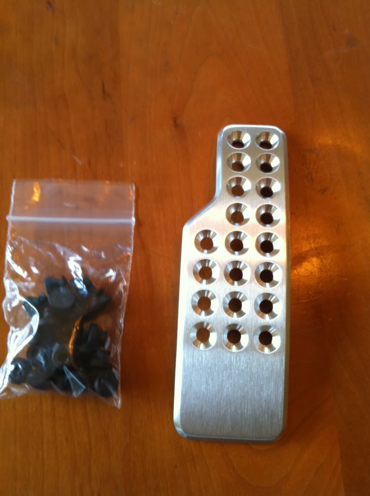

So, I don't go to the track anymore, but I still love to blip the throttle and match the downshift rev. I found that the AM's pedals were just a little wider spaced than the Porsche's pedals. I could still blip the throttle, but it took a little more careful placement of my foot on the brake and sometimes I would miss the gas.
I had Ultimate Pedals in my Carrera and was very pleased with the quality and fitment. I saw that a member here, obssesed, had used Ultimate and was pleased with the result. He was kind enough to pass me along information that he had used to make the pedal:
2006 AM Vantage gas pedal extended for heel toe shifting:
- Use your "gas db9 05" template
- Add 1" of plain undrilled surface to left side of pedal
- Brushed finish (vertically/lengthwise)
- Bevel outside of pedal 45 degrees (to about 2mm in from edge and about 2/3 of pedal depth)
- Flat grip inserts
What I changed to this was to add only 1/2 inch to the pedal, continue the grips in the extension, and start the extension lower down. If you look at the pedal design in the '08, the pedal arm extends over the top left side, so I don't think that a full pedal on the left will fit. I believe I had him start the extension 3/4 inch down.

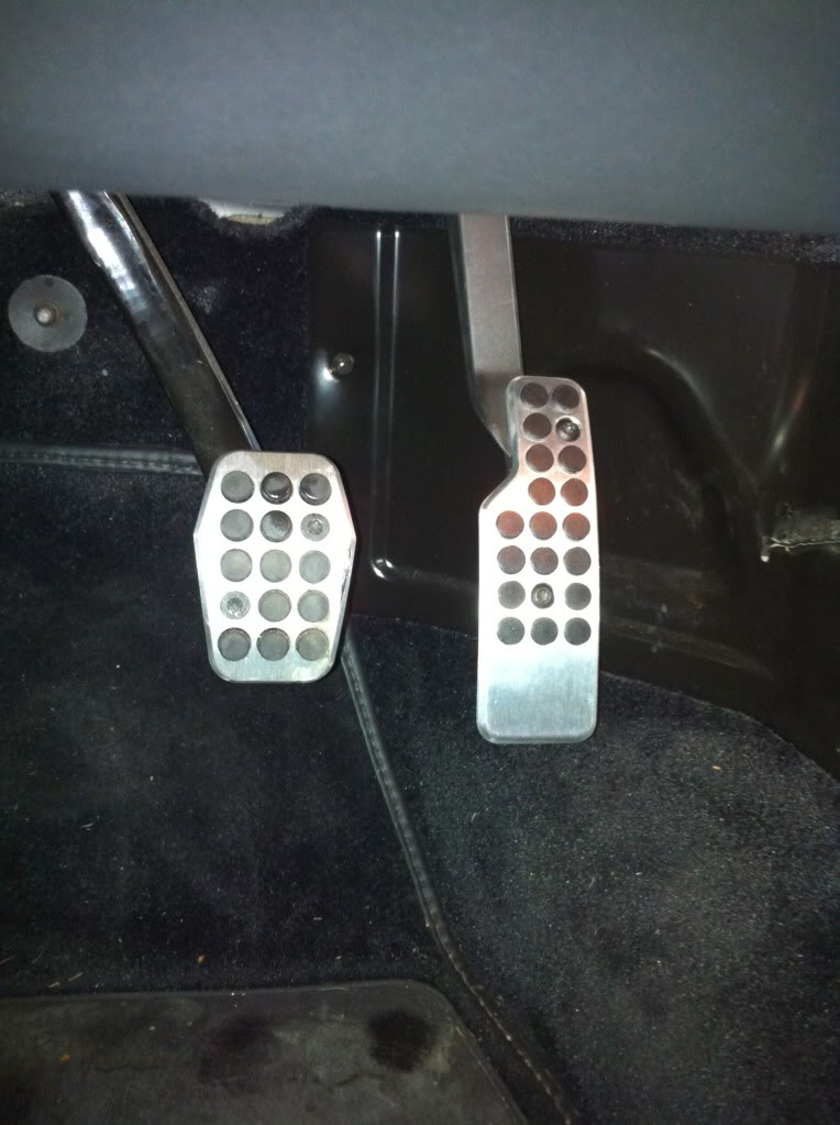

So, out of the box it looks like this:

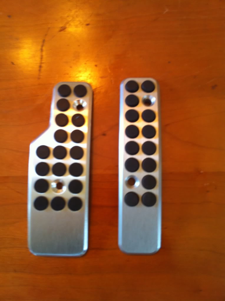

Here's a comparison between the stock and Ultimate Pedal

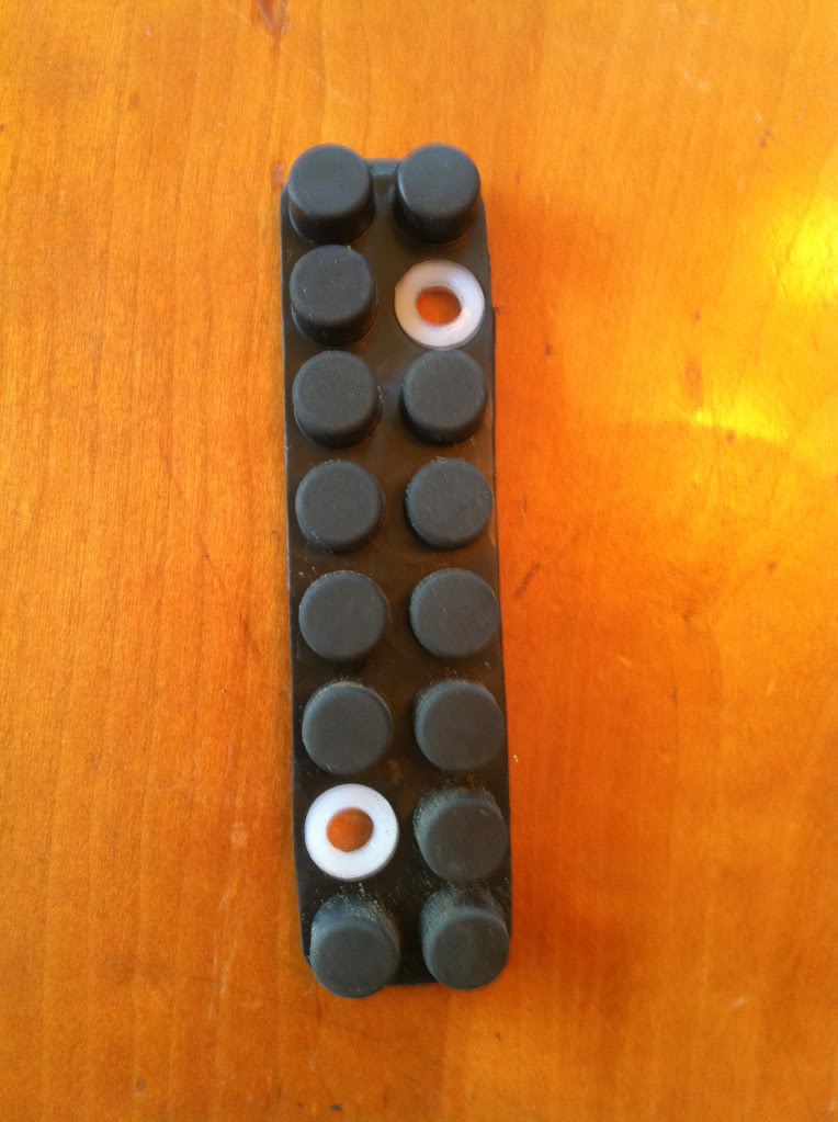

The design of the stock inserts is different and consists of a piece of rubber that fits into the pedal holes

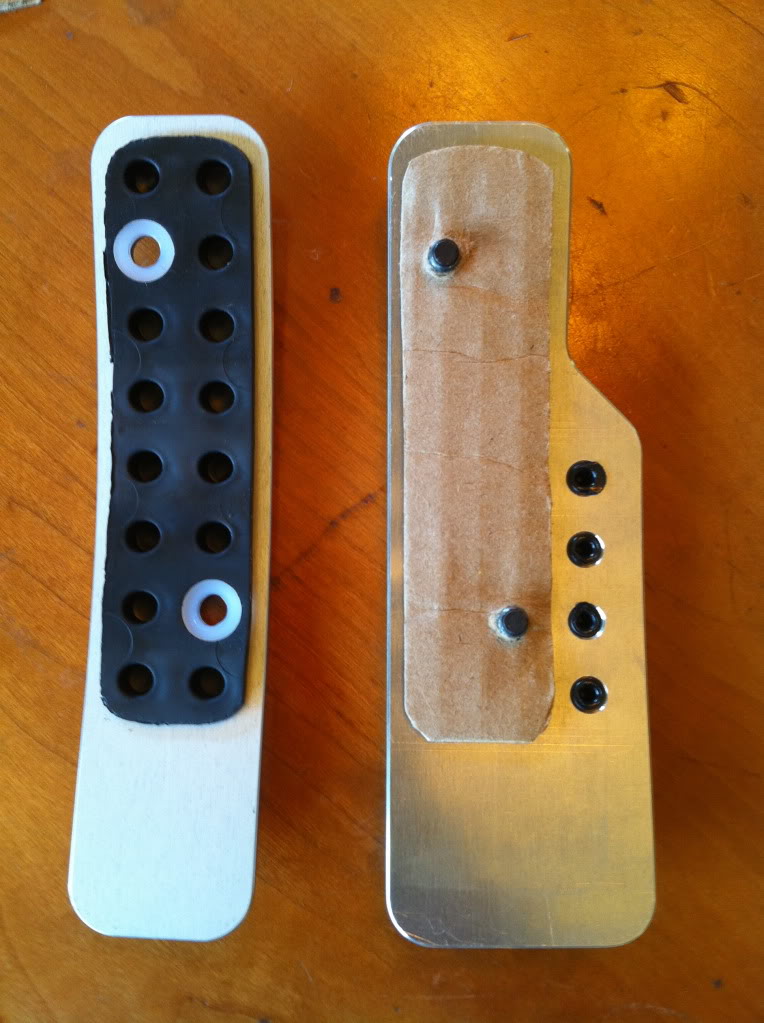

The shape of the rubber fits into the pedal bed, so I traced it and cut out a piece of cardboard that would fit into the bed.

Here's a final picture. The fit is perfect and the pedal screws directly in with the stock screws.

Seattle_Sun, do you have the measurement for how far down the pedal you started the extension? In addition, are the rubber treads they provide the same size as the originals? The reason I ask is because I am wondering if it would be possible to use the original rubber pad and have them provide plugs just for the 4 holes in the extension. If they are a different size it might feel strange though.

I just told them to start flaring out the extension at the third hole down. From an eyeball standpoint, the rubber pieces are the same size. I would take off your pedal and get an exact measurement of the holes and then give that info to Ultimate Pedals. Also, you'll be better able to see why I needed to cut out the cardboard piece. The guys at Ultimate Pedal are great and if you email them pictures and talk to them on the phone, you should be able to get what you want. They are in West Palm, so you may even be able to meet them if you go to the East coast.

seattle: I've read your original post a couple of times and can't figure out the purpose of the cardboard. The pedal appears to come with individual rubber dots, not a sheet of dots on a substrate. Can you explain what the cardboard is for?

I also thought it was individual dots, but it's not. If you look at the picture above, it shows that the dots really are a sheet of dots protruding from a rubber sheet. If you take off your pedal you'll see that the pedal has a bed for the rubber insert to sit in. The cardboard is needed to allow the pedal to sit flush against the pedal arm, otherwise the pedal will sink in too much.
Sorry, I know my explanation sucks, but if you take off your pedal you'll see. It really takes two screws and two minutes to take it off.
Oh I get it now. Wasn't understanding that there's a depression on the OEM pedal for the OEM sheet of dots. Thanks for the explanation.
