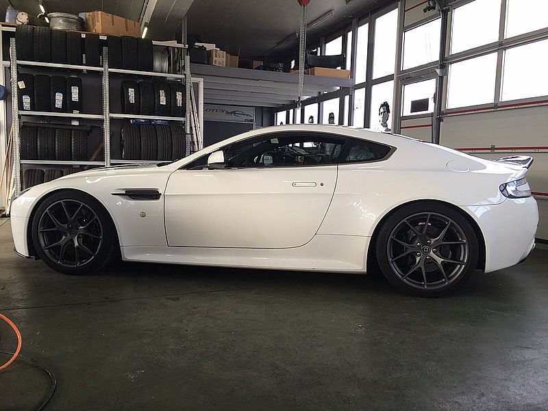

My new white toy :)

Finished soon...

Nice job Vince !
You car is fantastic !!!
Did you weight the dampers (OEM vs Nitron) ?
Did you reduce the ground clearance of your car ?
If yes, how many mm ?

Merci Bruno,
Nitro are lighter, but I do not know how.
For the height of the car, we did several tests with different driving on twisty and bumpy roads. Basically, compared to OEM, it was -25 mm front and - 40 mm rear.
Oem, the car is inclined forward, it's not level.
For now, it's the best setting. Perhaps i need to correct later. I need to drive longer to testing.

Vince,
Your Vantage looks great! Love the upgrades!
Do you know what spring rates you went with on your Nitron Kit? I went with their track recommendation. 575lbs front and 625rr - I believe their street recommendation is 375lbs ft and 425lbs rr - I also went with the pin mount adjusters and plan to use their extenders to make the adjustment more accessible.
Did you do a track based alignment? Any advise you can provide me would be helpful.
