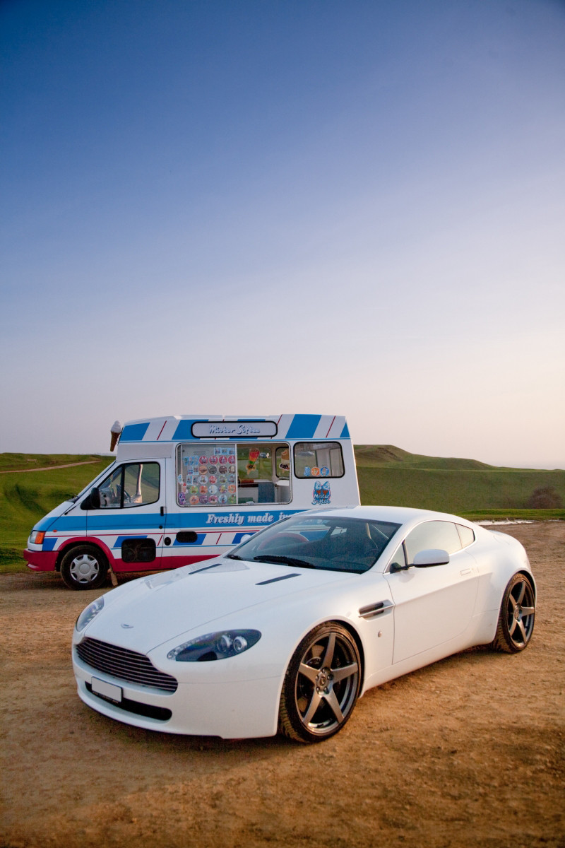

sorry for my absence, some personal problems to resolve ... Soon news with complete feedback and the power of the dyno.
pic from Michal

The wheels actually complement the car very well, I like them. Can't wait to see the dynos, hope everything is going well for you now.
