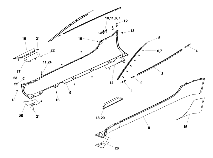

Karl-Franz - got a pic or more description of that clip you mentioned at the rear? Irish said above he spent an hour on one rear clip. I'm about 5 mins away from tackling this job & I don't fancy that at all. Is the clip you mention on this diagram?

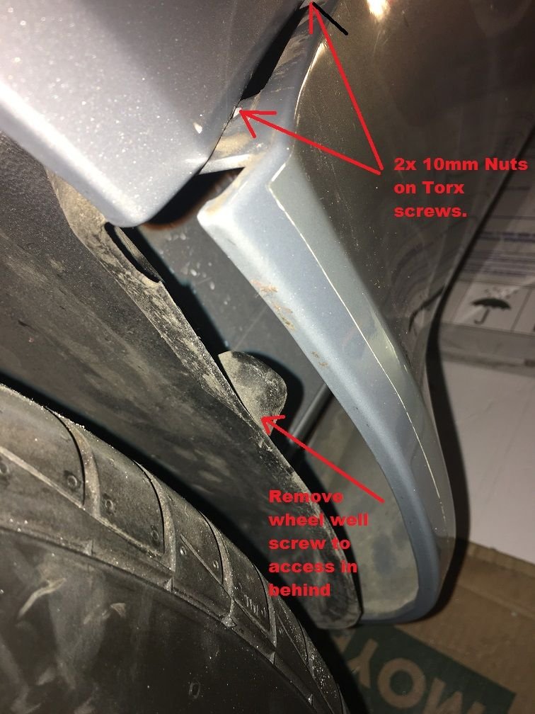

Ok I'm finished & I'll post a few pics of the removal as it was unlike anything I read on here. Firstly I'm working on a 2006 V8 Vantage so not sure if the specs were changed for newer models.
A member posted a link to a video for me but I just got back on here now so I'll look at it to compare it to mine.
I started by raising the car onto blocks so it was a little easier to work underneath the side of the car.
First off the rear clip was simple - it was the front clips I had difficulty with as I was expecting them to be the same as the rear. When I grabbed a mirror I could see they were actually quite simple.
The bottom torx screws along the side skirt are self explanatory and you should remove at least the first torx screw on each the front and rear wheel well to get your hand in there behind the skirt.
I started from the back - removed the lower wheel well torx bold to access in behind the skirt. There were 2x10mm nuts to be removed in addition to loosening the clip.

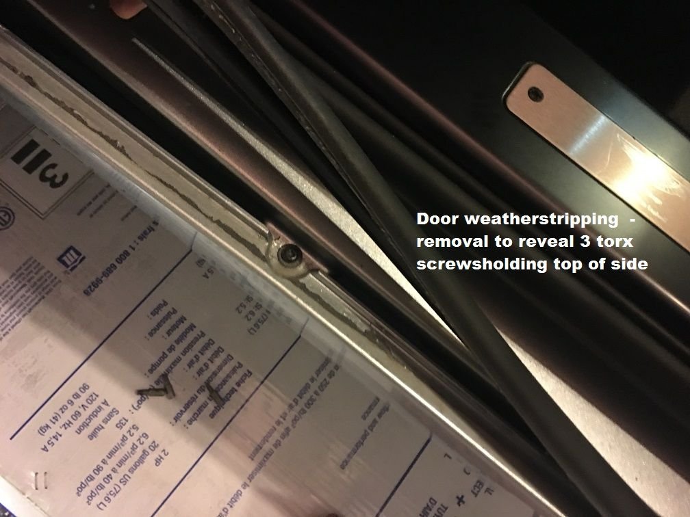

Working forward you also need to remove the door weather stripping along the bottom of the door frame. Mine appeared to be held on with a thin bead of adhesive. I used a plastic card to pry it off. This will require a cleaning and resealing with adhesive. Beneath this weather stripping are three screws that hold on the top of the skirt and at the front of the door jamb is an 8mm bolt with a rubber grommet that holds the skirt via a tab that is open at one end so it can slide off.
