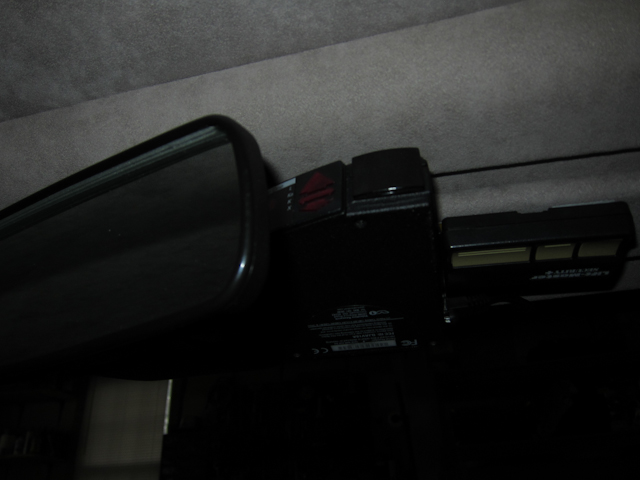

I chose to put the detector in front of the mirror, on the passenger's side. This blocks it from my view (pains me to have something dangling from a visor in a fancy car; at least this way I can't see it. That's the first image.

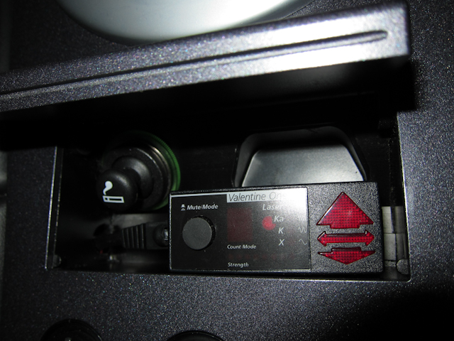

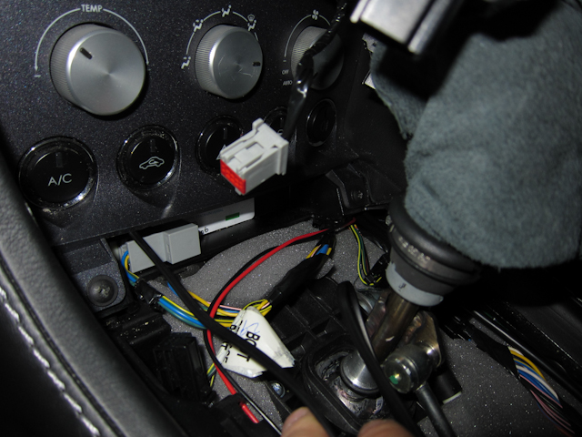

I chose to put the remote display in the ashtray area. That meant routing a wire up under the infotainment display. This was fairly easy (remove the center console, remove the bit around the shifter, then remove 2 screws holding the bottom of the infotainment display) except for reaching in from the front to grab the cable. Tight fit in there. I might've been able to loosen the display a bit more, but I didn't try. The cable is visible in the second image, just to the right of the left screw, going over the grey plastic connector.
Said cable needed to get into the ashtray area. There's a plastic cover hiding the spring that attaches to the tray cover; that required gently squeezing the clips on the bottom to pop it off. No drama. Then I drilled a 1/2" hole through the bottom corner. This is the third image.
I learned after doing that that the bottom piece of the ashtray area is aluminum. That got scratched a bit by the drill bit (and so is now shiny). It's not visible, however, with the remote display in place. These are the fourth and fifth images.

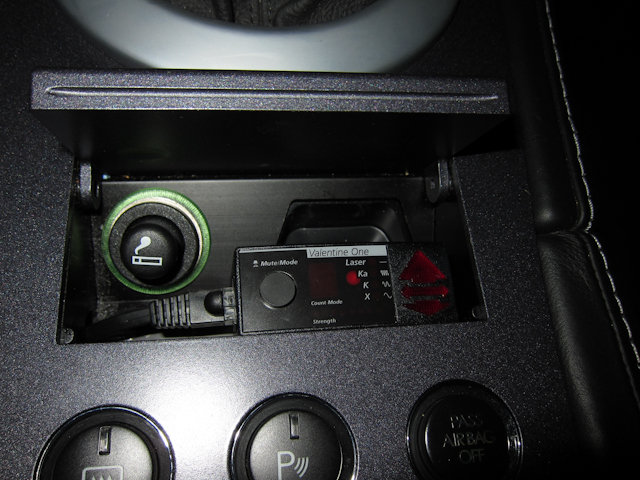

The remote display fits perfectly, so the ashtray cover still closes nicely. Image one.

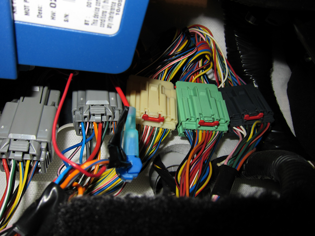

Finally, the question of where to get power. I got to cheat, as the K40 installer already grabbed the correct wires (or so I hope). The final image shows an orange with blue stripe wire all the way forward on the second grey connector (starting counting from the back, or left in this picture). The blue box at the top of the picture has a screw that's suitable for a ground wire.
