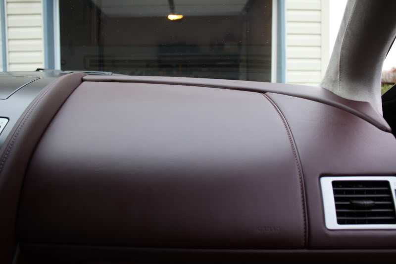

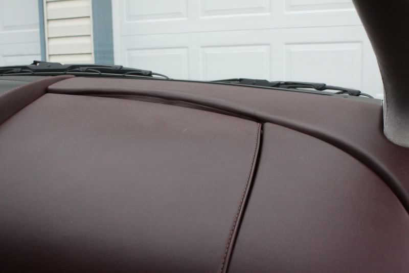

How do you take this panel out?
Seems like the leather has come unattached from this panel...I want to pull it out and have an upholstery shop re-glue it....does anyone know where the attachment points are, and the easiest way to pull it off?
TIA...

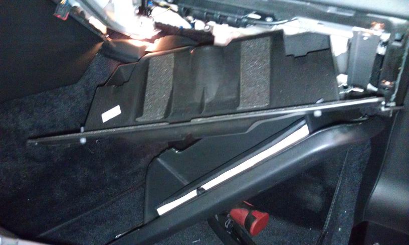

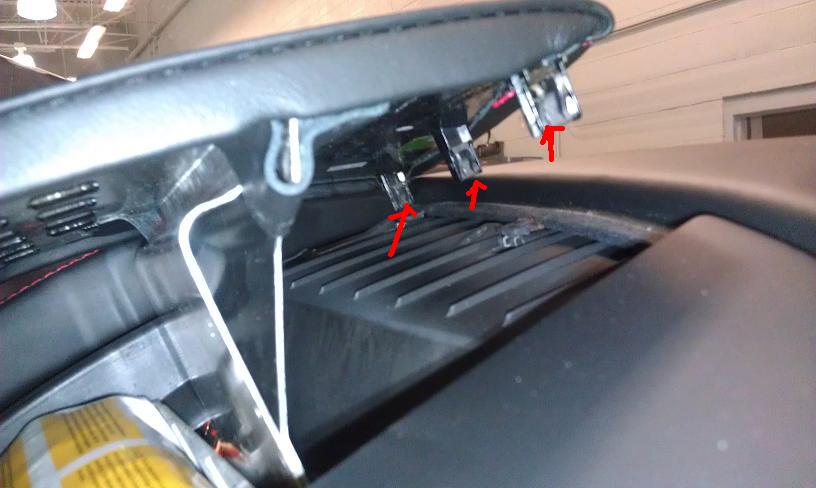

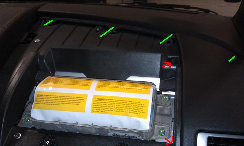

Panel Removal:
1: Remove glove box surround, glove box open switch is in this panel. It just pops out, no screws attach this. Start from the bottom pulling out from dash. Being careful of the switch once its out, the wires are short. (Glove Box Image)
2:Remove Glove box. There are screws at the bottom (3 or 2), either a torx or phillips screw head (Glove Box Image). They go into a metal bracket. Then then are 3 or 4 screws that hold in the plastic piece at the dash, phillips screws. Be very careful here, once the glove box is out there is a cable that attaches on the side. Do not disconnect this, as its a pain to get back on or you can break the clip realy easy. Just let the glove box hang, it wont hurt it. (Glove Box 2 Image)

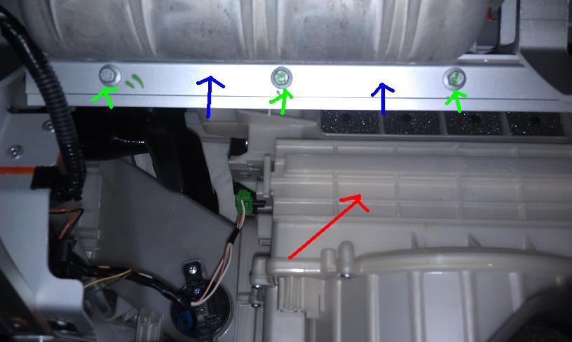

4. Airbag cover: Once the glove box is out. Look up under the dash there is a metal bracket with 3 8mm head bolts(Green Arrow). Remove these watch which way the metal braket comes out (Blue Arrow). When going back together make these tight. Then the airbag cover has clips that pop out. Be careful here and not break the clips. (Airbag 2 Image)
Also here is where the cabin filters are. There is a white panel that pops off, then the two filters are in there (Red Arrow). (Glove Box 2 Image)

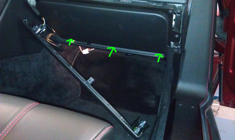

5. Once the airbag cover is out you can remove the 2 screws for thr side air vent. It pops out. (Trim Image red Arrows)
6. Then the four screw that hold the upper panel in. It also has some clips like the airbag cover, so be carful when removing it. (Trim Image Green Lines)
If anyone has questions let me know.
Same process for DB9, DBS too.

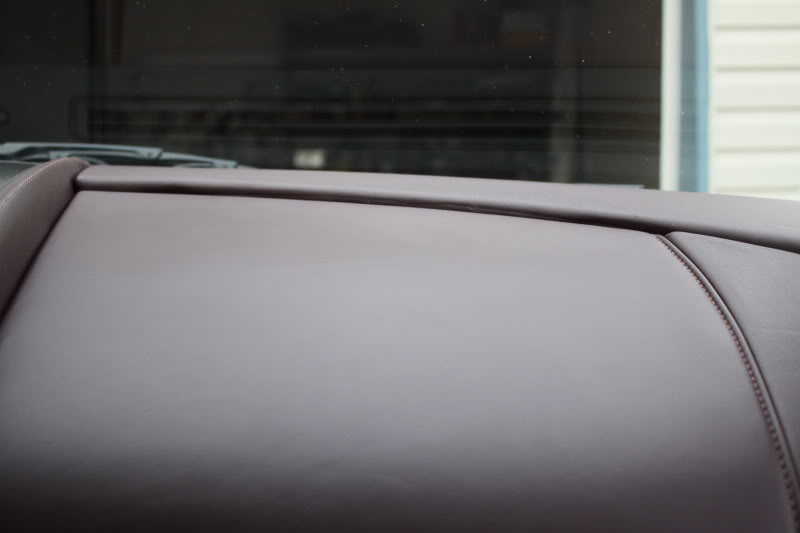

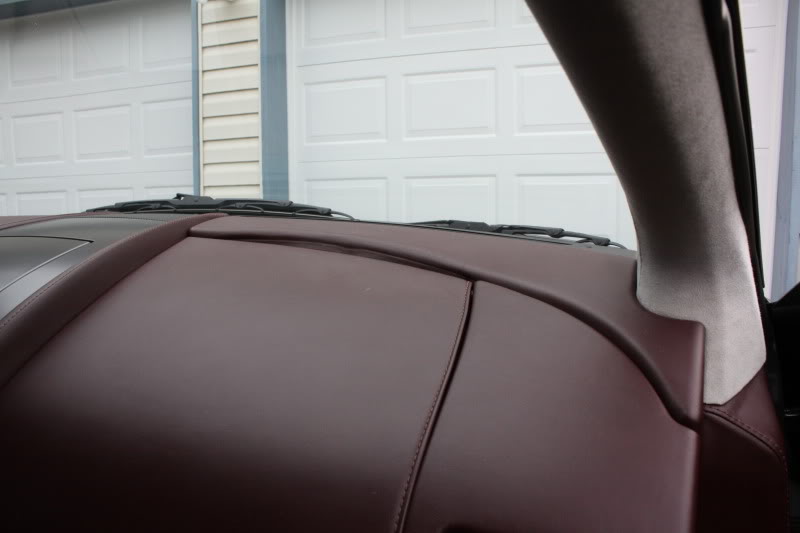

Here are the after pics..
AMfixer, thanks again, this was bothering me since I picked the car up
