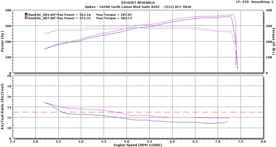

Before and after dynos
Here is the dyno with the best run (Highest RWHP) pre cats and the best run post cats.
Good to note the gains were across the power band in both HP and Tq.
As I guessed, the AFR is much higher now. It is close to optimal level, unlike the stock cars that fell off to 10 and beyond in high revs.

Originally Posted by 007 Vantage
I would love to see a before & after comparison chart of both HP & torque to see where the largest gains were (ask the shop they can provide that for you)
I think the change in the AFR will surprise you. After your tune, where were you at?

Hey, great results. It appears the gains in the mid range were even more, ask the shop to provide the maximum gain in the power band ( largest delta / change ) instead of just maximum peak gains. Low end to mid range torque gains are significantly improved.
It appears the cats significantly alter the AFRs more than a standard catback does. However it's still not perfect. With a good high quality tune, it will look as if you drew a straight like across all the way from 2500rpm to redline at 12.1. You are definitely much closer than you were, so it's a big step in right direction, great job!

Largest delta in HP
Here is the largest delta in HP. The gap was 18HP at 5400RPM pre and post cats.

Here is the largest TQ delta-16ft/lbs at 4,900RPM.

Hey Detomaso,
First off, Excellent job providing thorough scientific data for the Aston Community, providing both maximum peak & largest delta charts is a huge help to those looking to purchase cats down the road. Im so glad to see more and more aston owners doing proper scientific testing both pre/post mod, Great Job!
As I suspected, the gains were even greater in the mid-range of the power band. Typically with high flow cats, the largest gains will be at roughly the same rpm as peak cylinder pressures (aka peak torque). If you look carefully, both of the largest deltas occur right around peak torque (4900-5400rpm).
Very strong results, congrats on the great gains!

@007-Thanks, I could not agree more. I was looking for this for a long time but it did not exist. These are gains that were well worth the money IMO for this type of car. The peak you speak of is also around where the car drops to in the next gear when shifting if you are pushing it hard.
