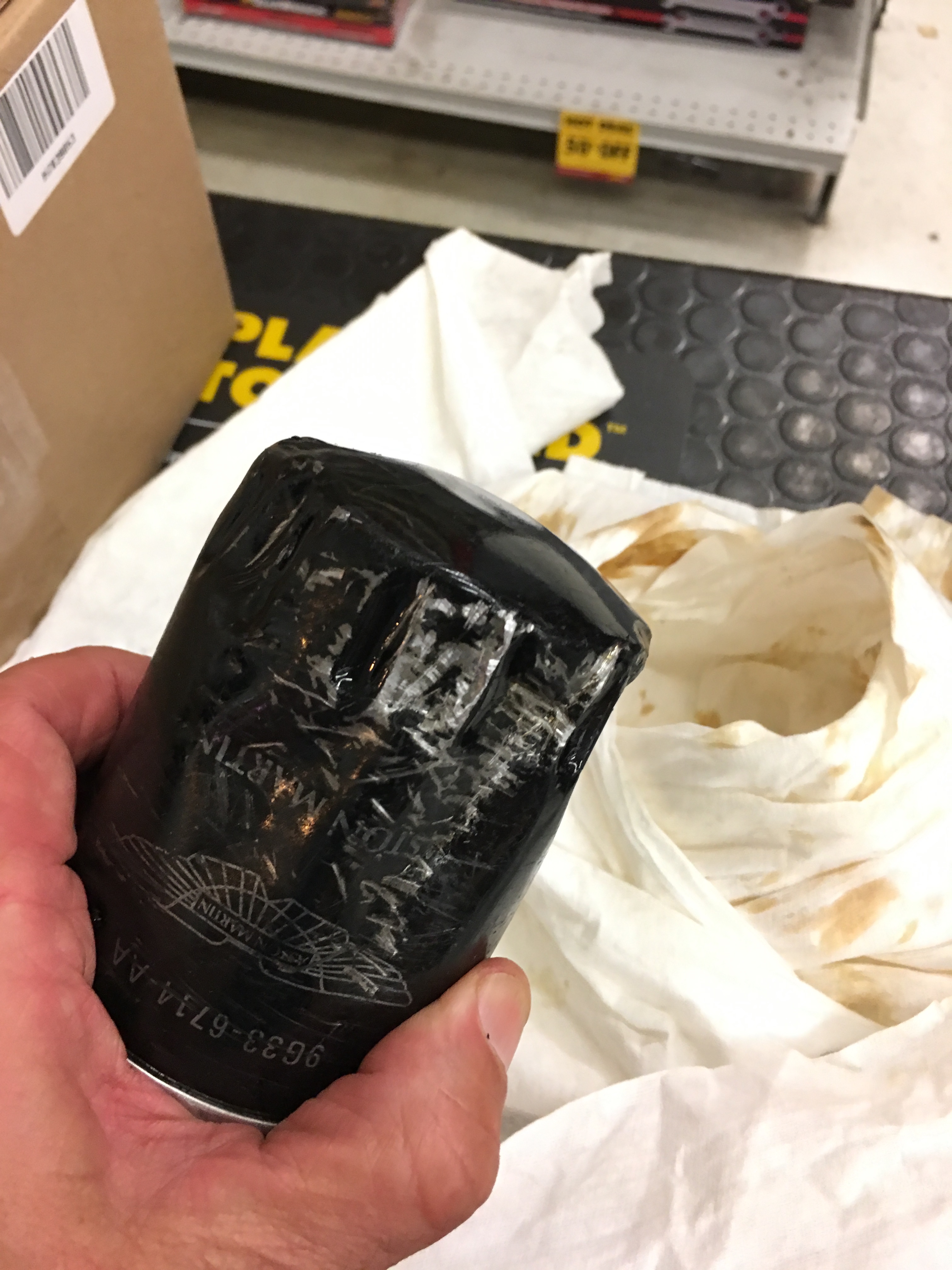

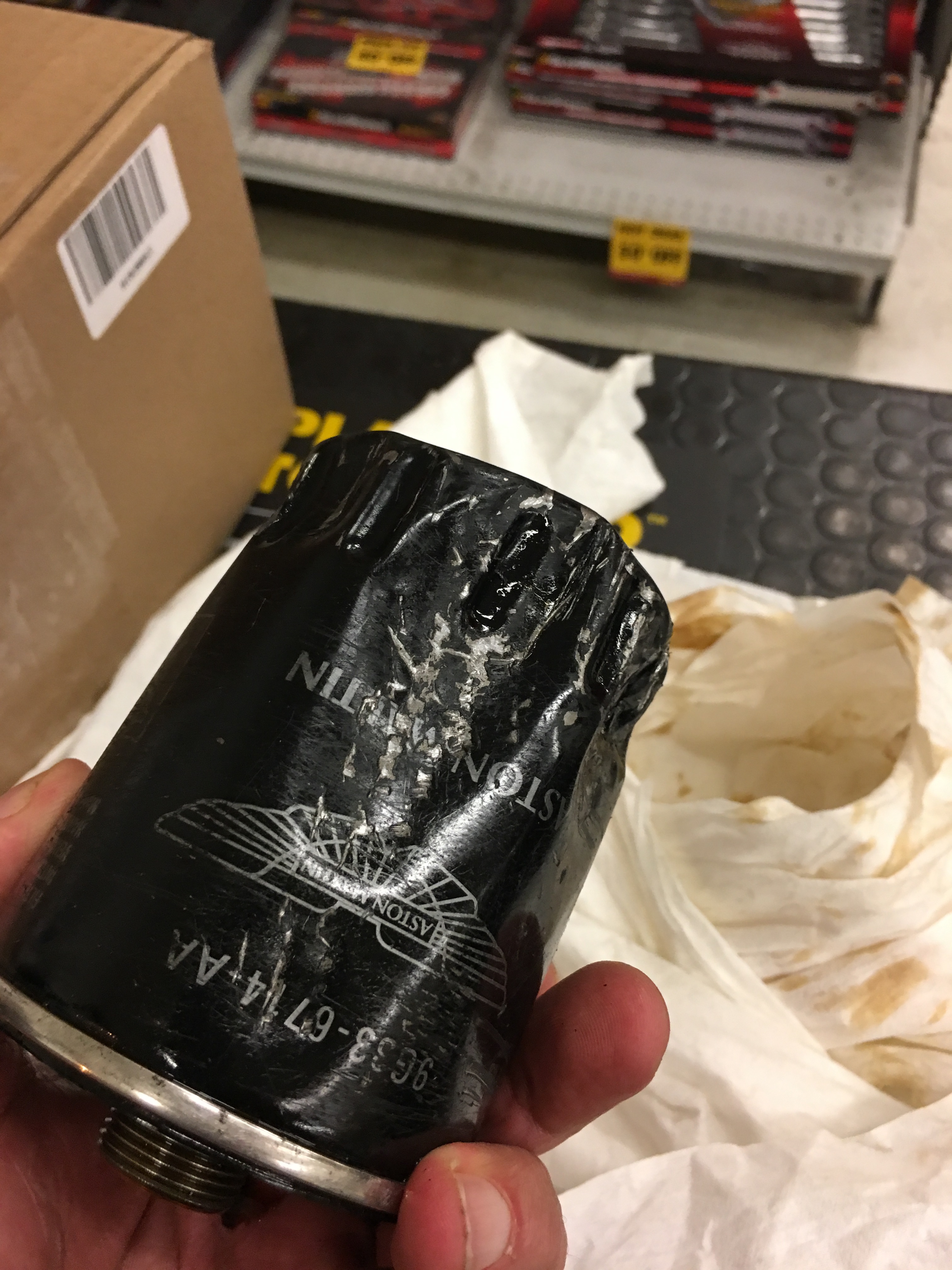

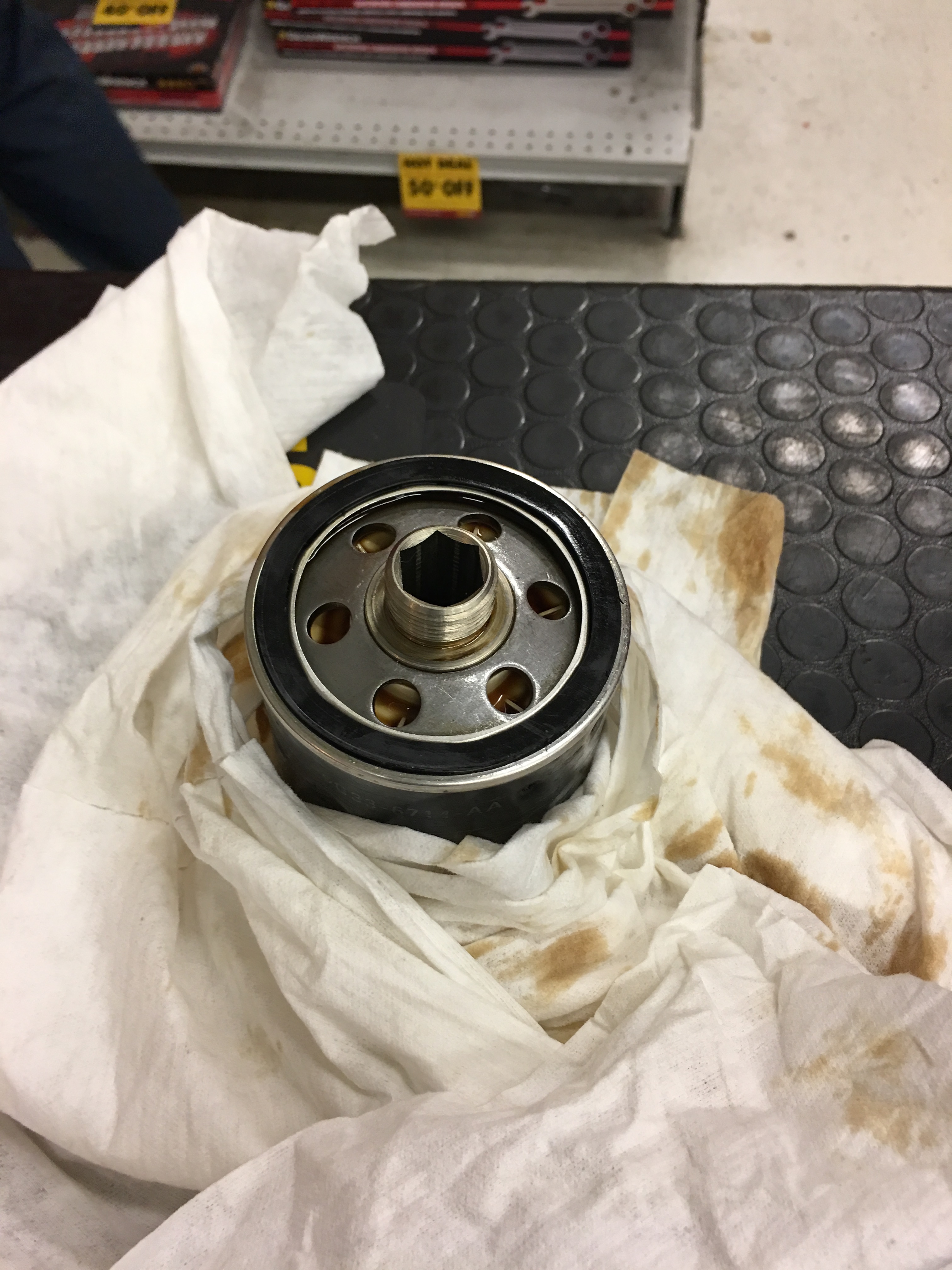

Just did my first oil change. Only took 3 days!
I feel just like a mechanic. With Telum's assistance, I was able to install a catch can and change my oil. It only took me three days and I only swallowed one nut. I got hung up removing the oil filter. I think the dealer must have superglued it instead of running a little oil around the gasket. I ended up trying four different wrenches, and was only able to get it out when a helpful person from the auto parts store came over and he pulled on one wrench while I pulled the other. We got it out but it pulled out the threaded part from the engine. We were able to get that out of the filter and reinstall it.
You can see from the photos that this was a real project getting the filter off the car. One of the wrenches I used gripped it like the terminator and still no movement.
I think that next time I should be able to change the oil in 6 or 8 hours.

You have a threaded fitting on the inlet side of your oil filter that doesn't look like it should be there.
Mm no he said the threaded bit came out the motor, normally that stays in.
On a sticky oil filter simply hammer a sharp screw driver through it then you can turn it a half turn lose to get it going, it's messy but works every time.
After all a used filter is going into the bin anyway.

I have great respect for real mechanics
I am also a wannabe Vantage mechanic.
Faced with a sticky, welded?, filter, two removal tools had partially collapsed my canister. What could I do?
I knew of Captain Greg's "drive a screw driver through the damn thing", but considered this a last resort. I wasn't there yet.
My fix was to take a putty knife with a thin flexible blade and to tap it, gently, between the interface of the steel filter and cast aluminum block. About 40% of the circumference was reachable. Followed up with a liberal squirt of penetrating oil and 5 minutes of patience.
Easy, peasy, out it came...could have removed it with my fingers.
Learned above, the Ford part, FL2021, is also available with a thicker steel can, FL820S. Should be more deformation resistant.
Senator Blutarsky, nothing is easy, if it was, everyone would do it. But doesn't it make you feel good when you succeed?
I've seen this happen on a couple cars now. It's probably from over-tightening the filter (the filter is tightened more than oil filter adapter so the adapter loosens from the engine before the filter loosens from the adapter).
Get an oil filter wrench. Off the top of my head, there are four kinds:
1) a handle with a rubber strap (these are crap)
2) a handle with a solid metal loop (used one of these for the first time last week and it worked great)
3) ones that look like a wide-open pair of pliers (these can easily damage the filter but work for removing old ones since you probably aren't keeping it)
4) ones that look like a huge socket that fit over the end of the filter (these need to be the exact right size to work)
I'd recommend option #2. If you google "oil filter wrench" you'll see each of your options.

I agree that the plastic handle with the rubber strap is mostly crap, but I have one (that's never worked previously, not sure why I haven't thrown it away) and it actually worked to turn my Vantage filter loose on my last oil change. I wouldn't suggest that anyone else buy one, though.
The method I've had the most luck with on tough filters that I don't have the correct socket style tool for is this:
These things are cheap, crappy and simply don't work as intended:
HOWEVER, if you buy a big hose clamp and tighten it around the arms of the clamp once on the filter, it will hold on to that filter with a death grip that would have made Bruce Lee cry.
Old Jan 2, 2017 | 08:29 AM
  #163
Senatorblutarsky's Avatar
Joined: Jul 2015
Posts: 129
From: Connecticut
Senatorblutarsky is infamous around these partsSenatorblutarsky is infamous around these parts
That three pronged wrench is pure power!
That 3 pronged claw is the one that gave me the best grip, and the one that grabbed so tightly that it crushed the oil filter. The harder you pull on the wrench, the tighter it grips.
I tried using the metal strap wrench and it slipped, so I folded some sandpaper and used it inside the metal strap. I got a decent grip but the filter was in too tight.
I had also tried the rubber strap and the pliers with the big lobster claw. None of them was strong enough to unscrew the filter. But mine was insanely tight.
I will definitely try the hose clamp method if I get stuck again. Thanks for the tip!
