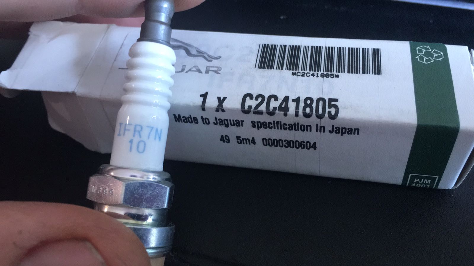

Hello to the Aston V8 Vantage enthusiasts!
I'm Cambo, one of the moderators at jaguarforums.com
You might well be interested in something I stumbled across while searching for a colder plug to run in our 4.2L supercharged Jags...
Colder sparkplug for s/c AJ-V8 ?
Have a look at this...
Yes you can buy the IFR7N-10 plug as a Jaguar part
Old Mar 3, 2017 | 06:53 PM

Ok that is a cool find, thanks for the tips
