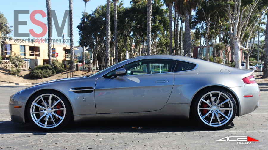

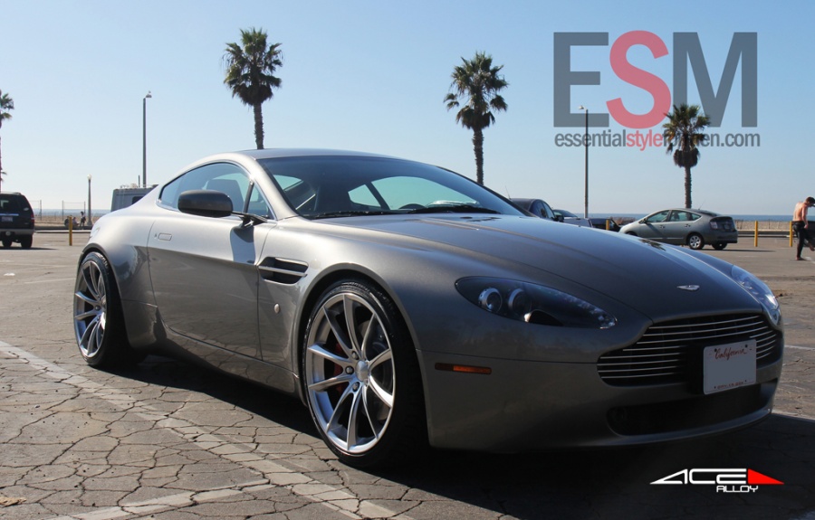

Ace 20" Convex w/ 007 Aston Martin Vantage
ACE Convex w/ 007 Aston Martin
Specs:
Vehicle: Aston Martin Vantage
Wheel Specs: 20x9 Front / 20x10 Rear
Wheel : Ace Convex - HyperSilver

Hello,

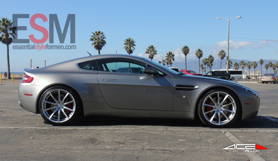

wheels look amazing. What are the weights? And can they be had in 19s with less aggressive offset in rears (too high IMO). 19" w/ 10.5" or 11's in rear would be excellent.

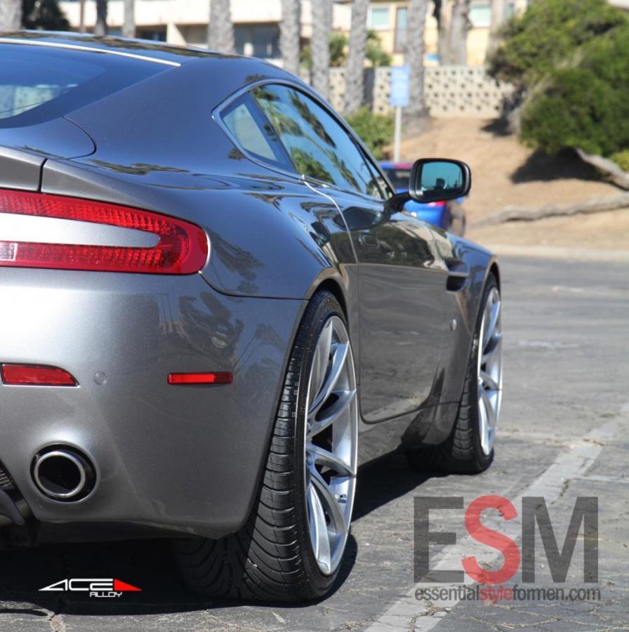

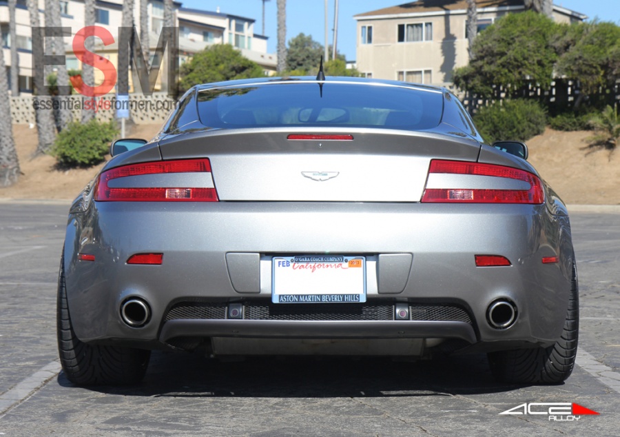

Wheels look great but they look like they are a little too aggressive in the offset. You are going to get tire damage.
Old Nov 23, 2012 | 03:47 AM
shadowhusky's Avatar
Joined: Sep 2012
Posts: 81
From: China, Michigan
shadowhusky is infamous around these parts
I agree, it has that 70's Musclecar offset going on. But I love the actual look of the wheels

Also,
what are the weights of the wheels for both 19s & 20s. Wheel weight is very important.
Other then that, they are one of the most gorgeous wheels I have seen on an aston, its very hard to make wheels look good on astons, not easy to match the character of the car. These wheels do a great job of that.

^^^ Agreed. The style of these wheels are perfect for the Aston's shape and curves.

Originally Posted by 007 Vantage
Hello,
19" Convex is offered in a 19x8.5 Front and 19x10 Rear Staggered Fitment.
Our 20" Convex is offered in a 20x8.5 Front and 20x10 Rear Staggered Fitment and also 20x9 Front and 20x10.5 Rear Staggered Fitment.
Convex Weight -
19x8.5 - 26lbs
19x10 - 27 lbs
20x8.5 - 28 lbs
20x10 - 29 lbs
Glad you loved the wheels! The Convex is also offered in a Titanium Finish/ Gloss Black w/ Machined Face/ Matte Black/ Matte Black w/ Machined Face and Matte Silver.

Hi Oscar - I called you yesterday about these wheels. I'm probably going to buy a set for my Vantage but as we discussed, I want to make SURE we get the offsets correct and sizes as I don't want the wheel protruding from the fenderwell as the ESM car does.
So we change the wheel in the back from 10.5" to 10" and change the offset from 45mm to 42 mm in the rear, to make sure the center cap will fit on the car without spacers and the wheel will stay within the fender. Can you double check all that and then verify the recommended tire sizes for a staggered wheel set up at 20" with no lowering of the car?
Once you can do that, I'm ready to pull the trigger and buy direct or through a recommended dealer that can offer a wheel and tire package. Let's be SURE the wheel doesn't protrude out like the ESM car, however.

You actually want to run a HIGHER offset to bring the wheel in. You need to be running a 48-49mm w/ 10" wheel to get the look you are going for. My Rennens were 49mm offset at 10.5" and they were almost perfect fit. I believe HRE official is also 49mm rear as well.
42mm will make it stick out more, not less. And if you are going from 10.5" to 10" thats 12mm total reduction, 6mm on the outside, so if you are going to 42mm offset, you are actually only bringing the wheel in 3mm, you won't even notice that, it will still look bad. You ideally want to bring the wheel in about 10mm for a better look. To achieve that from 45mm you should run 49mm w/ 10", that will effectively bring in the wheel 10mm (4mm offset + 6mm outer half of wheel reduction).
49mm on 10" is the proper size (same recommendation as per HRE as well). You could run 49mm on 10.5" as well for an even more aggressive look. Stock offset is ~52mm front 61.5mm rear. So compared to stock wheels, 49mm will run half inch wider @ 10" and an additional 12.5mm coming out to about 17.5mm further outward than the stock ones (which is pretty close to the 15mm spacers that most people run in rears). At 42mm wheels would be equivalent to over 25mm spacers, way too much.
Just saying, as I went through this entire debacle for almost a year....
EDIT: Just read off their specs 45mm is the highest they run ... its doable at 10" width.
