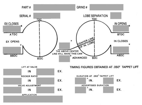

Did you get a chance to degree the cams?
I would be most interested in this data.

I have to look back in my notes for details. I checked camshaft lift and total duration. I did not check camshaft opening and closing. Static numbers do not mean much on these motors anyway since the intake camshafts have timing phasers and the ECU constantly changes timing. If total duration, both seat-to-seat and at 0.050", is known then the diagnostic scan tool can be used to check camshaft timing at different engine RPM and loads. (at least I hope it can be).
