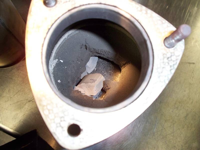

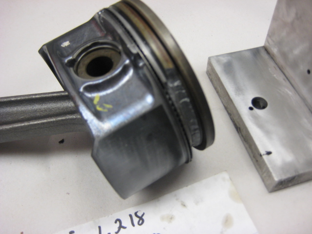

Here is an example of destroyed ringland on a AMV8 piston and gutted ceramics in a AMV8 catalytic converter. These were not my cars, but street driven only!

rmrmd,
Certainly, similar examples can be found for any engine. My understanding is that these failures are very unusual in the Aston V8 -- does your experience suggest otherwise? Were these from unmodified (in any way) cars? Do you know what caused the failures?
I think I saw that picture on PistonHeads in the Bamford Rose thread, http://pistonheads.com/gassing/topic...ord+Rose&mid=0
The context was a discussion of pressure charged engines. You said there that the problem was caused by lack of intercooler fluid, plugged cat(stock ceramic) and 91 AKI california gas. The piston clearly shows a classic detonation / over pressure failure which would be VERY surprising from a standard engine.
I think the pic shows that the engine isn't robust when supercharged, but when we consider the engines from Ford's stewardship, the current crop of aston engines are as bulletproof as you could find from any auto maker
You are correct. This was a supercharged (6psi) car. It is the only example of this kind of failure in the AMV8 that I am aware of. Engine does seem bulletproof in normal use. It is always interesting to see where the limit is. Seems to me that the motor will support over 550hp as long as detonation is avoided!
