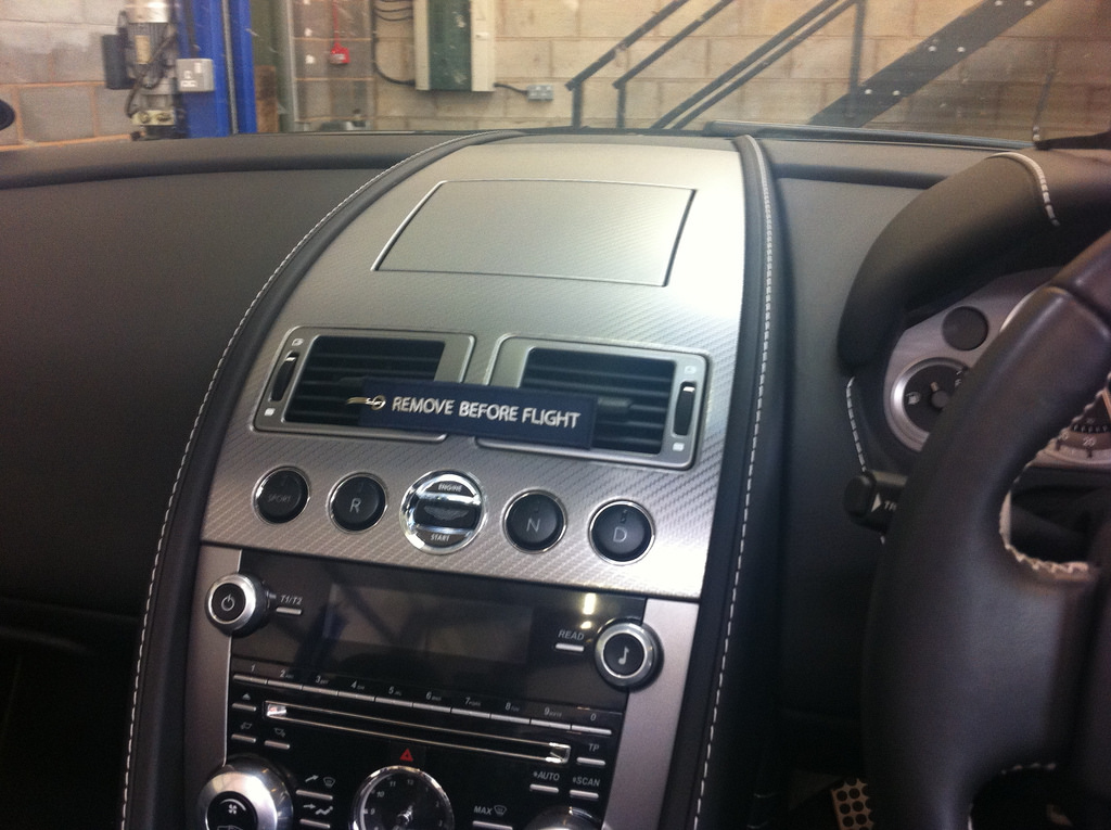

I believe this is compulsory now Off to do some more "preflight checks"
Untitled by mikey k V8VR, on Flickr
image by mikey k V8VR, on Flickr
Better pictures over the weekend

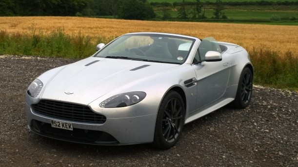

A couple of pics of the trip for you

Congrats on the car, Mikey. Sounds like a complete animal! Great shots too. Where was the second one, with the mountains in the background, taken?

He's coming along!
I'm not entirely happy with the wheels and stance (working on that )
I need to video a flyby because the noise has changed a lot and is EPIC!
The mountain/lake shot is Mont Cenis on the Italian/French border.
It has a LOT of history and was apparently the route Hannibal took through the Alps with his elephants when he tried to invade Europe many moons ago
It was also one of Napoleons strategic routes as well
