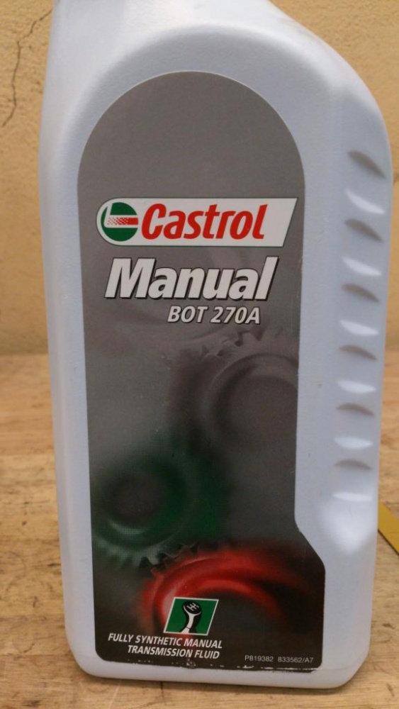

Here is a picture of BOT 270A from Castrol so you know what your looking for, or trying to match:
