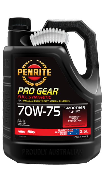

Added...An aftermarket BOT 270A lubricant has been released for Graziano transaxles by Redline called MT-LV 70W/75W. As some of you might know, I've changed employment and I'm part of the VelocityAP team. We've been using the Redline MT-LV lubricant in replace of the OEM Castrol BOT 270A, ease of access played a huge part. Here's a picture of the Redline MT-LV product:
Hi, I can only find Motul 300 or Motul 300 LS locally and it seems like they are GL5 instead of GL4. Is there any long term issue with going with the GL5? I note that the original Shell oil AM recommended was GL5 but the Castrol BOT 270A is GL4.
I would not run the 300 LS, you can run the 300 but it's not ideal.
If you cannot get Redline MT-LV from say Amazon and can only access some common Motul products, then I would select something like Motul Motylgear 75W-80 which is both GL4 and GL5 rated. It's also much closer to BOT270a which is 70W, or if you have access to all Motul then just get the equivalent as Redline MT-LV which is Motul Gear Power LV 70W.

Thanks for all the advice! Dodged a bullet and managed to find PENRITE PRO GEAR 70W-75 which is GL4+. I reckon this is the first transmission oil change in my 08 Vantage ASM (Still on single plate clutch), and what a big difference it has made with the 70w75. The gears behave so much better "cold" (It's perpetually 26-33c year round) at 1st 2nd gear, it shifts so much faster, smoother and gentler without that sudden jerky transition. It doesn't struggle coming down from 2nd to 1st gear as I'm slowing down, it used to try to guess if it should down shift or accelerate to prevent a stall. It shifts faster, accelerates faster, drives smoother too. It made a bigger difference than the last engine oil change.
