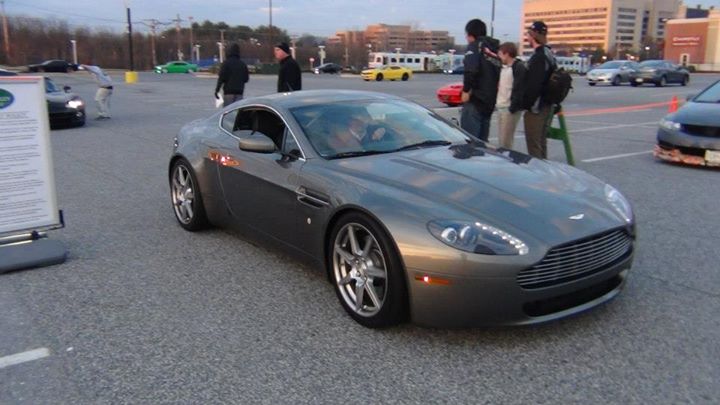

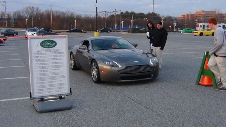

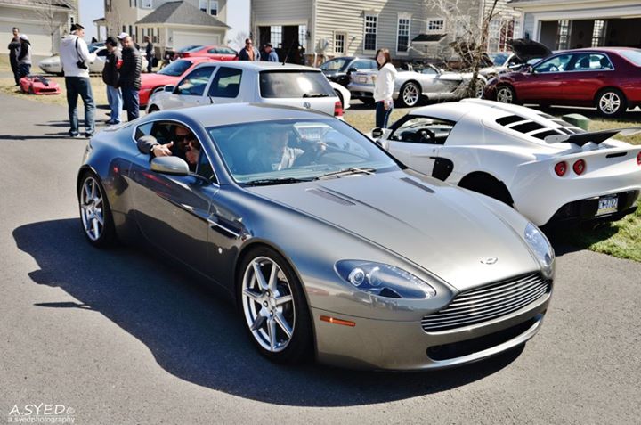

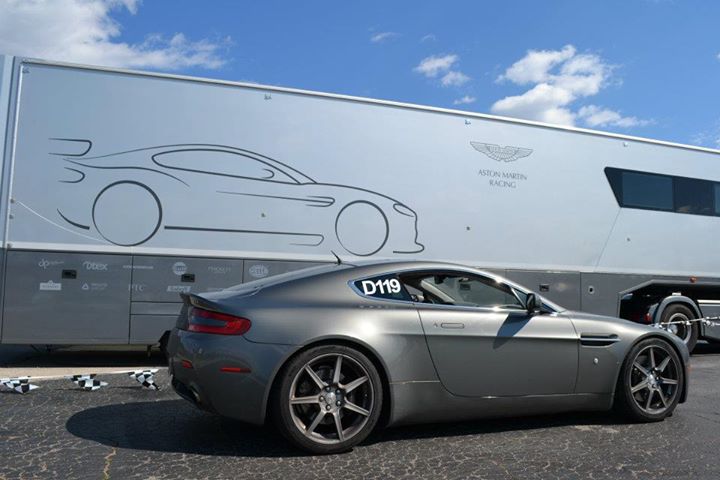

A couple more for ***** n giggles, a few different angles
Lol, taking Sunir for a spin
