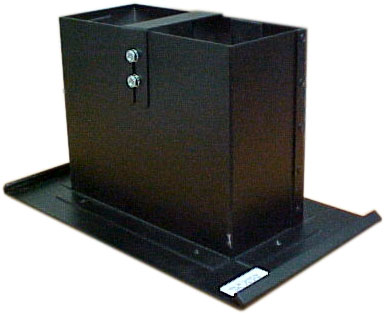

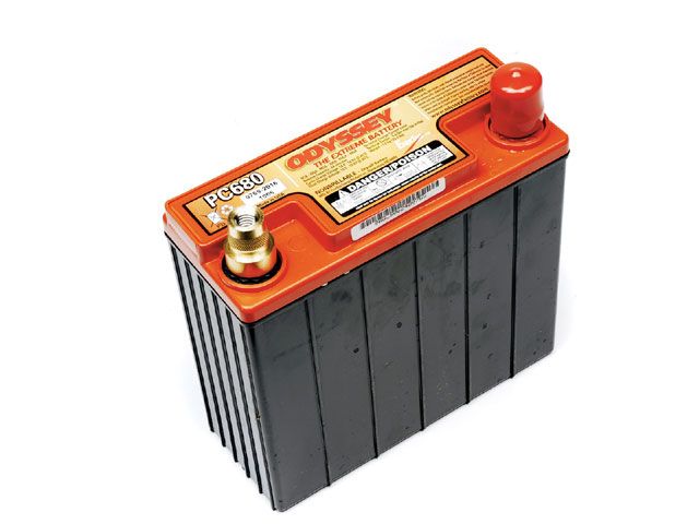

Battery: The best long term solution I have found for battery is the Odyssey PC680. Racers everywhere have been using this bulletproof battery. It is unique in that it is a solid state battery (meaning there is no liquid inside it at all). It weighs only 13lbs and is about $120 (versus lithium ion which is $1500+ or 10x price). Also, the benefit of drycell technology is you can run it down to zero 20 times and charge it right back up and it will not harm long term life of the battery, I had run down my old one countless times (old BMW track car that would sit for months) and as soon as I charged it up it was perfect. Optima batteries are the exact opposite, you run it down once... its a $150 paperweight. The only thing you need with the PC680 is a battery box (there are many available out there that provide very plug & place bolt on solution. The only thing about the PC680 you need to know is it's really only meant for cars you drive regularly. You can go about 2 weeks max before battery runs down. So as long as you drive the car 2x a month or more, you are totally fine (depending on your cars natural idle draw down rate). Also, I had no problem cranking the motor even as low as 30*F so it can handle quite a bit. Should def be no problem for the V8 and I suspect V12 would be fine too if you drive it regularly. Also, I noticed it had so much cranking power that it would actually start my car much faster than stock battery. Instead of taking 3-4 cranks, it would instantly fire on the first crank rotation, pretty impressive.
The PC680 is literally the size of a radio head unit (hard to believe I know)... You will need the brass SAE terminals (extra $12). The cranking amps listed below:
  • 680 cranking amps for 5 seconds
  • 595 cranking amps for 10 seconds
  • 525 cranking amps for 20 seconds
  • 17 amp hours
  • Short circuit current over 1800A
  • 25 minute reserve capacity with 25amp load
  • Female brass terminal w/M6 SS bolt
  • Length 7 1/16"
  • Width 3"
  • Height 6 9/16"
  • Weighs less than 15 lbs
Russ Wiles Battery Box is the perfect OEM solution for battery box as it can be held down by factory tie downs just like the stock battery usually. Its only couple pounds and looks very OEM compared to a lot of ricey aftermarket type battery box/tiedowns
