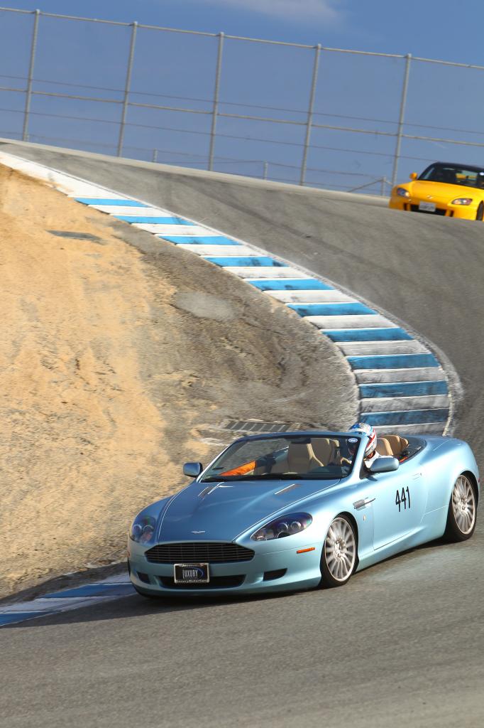

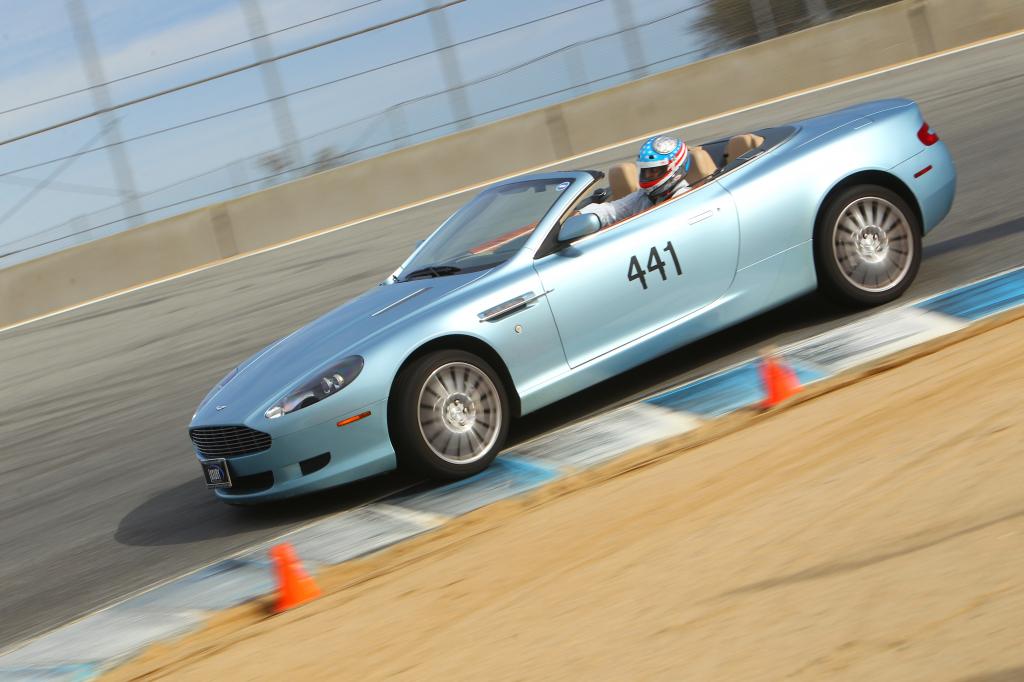

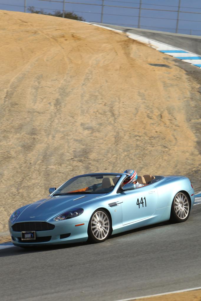

Here are some before pics of her at Laguna Seca...I won't have after pics until early 2014, but you can clearly see the suspension at both ends of travel in stock form...
Diving into the corkscrew...
Heading for bottom of corkscrew and suspension travel...
7 stories of drop nearly complete...
