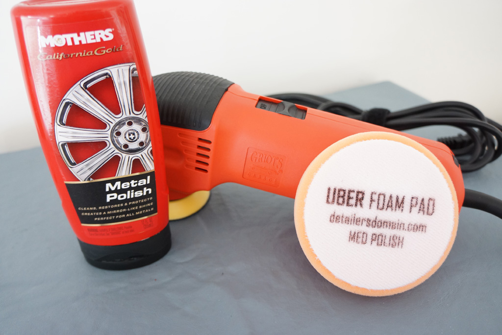

Supplies:
- Random Orbital Buffer (Bought Griots Garage kit from detailersdomain.com)
- UBER Hard Cutting/Compound Foam Pad (yellow), Medium Polish Foam Pad (orange)

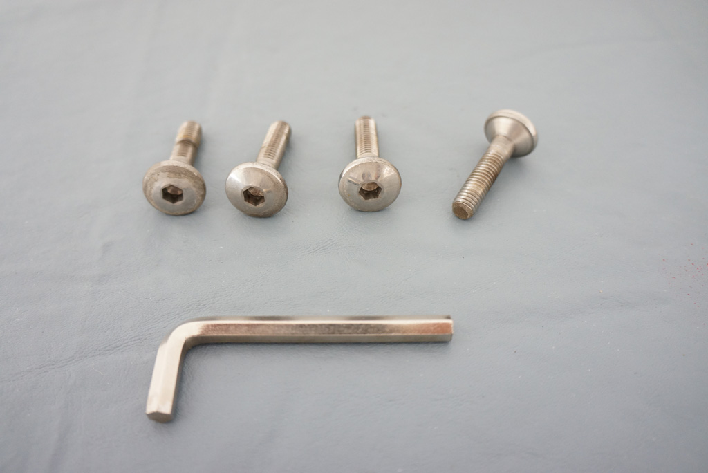

- Mothers Metal Polish (or Meguire's Metal Polish, switched later b/c its better) = $10
- 600 or 800 grit (preferred) wet sand paper = $5
- 6mm metric Hex Wrench = ~$5
- 10 microfiber towels just to be safe = ~$10
- old plastic disposable tupper ware filled with water
- old plastic spray bottle filled with water and tiny bit of dish soap shaken up
- some old carpet/mats or cardboard to lie down on as you will be on the floor most of the time
Prep Work:
First, MAKE SURE THE EXHAUST IS COLD (learned this one the hard way even an hour after I drove it lol). If you are impatient, just spray the exhaust down with an entire bottle of water and within 5-10 min it should be cool to the touch. You need the exhaust to be below 100 degrees otherwise the polish will harden on surface of the exhaust and make it harder to work with. Preferably do this after car has been sitting over night.

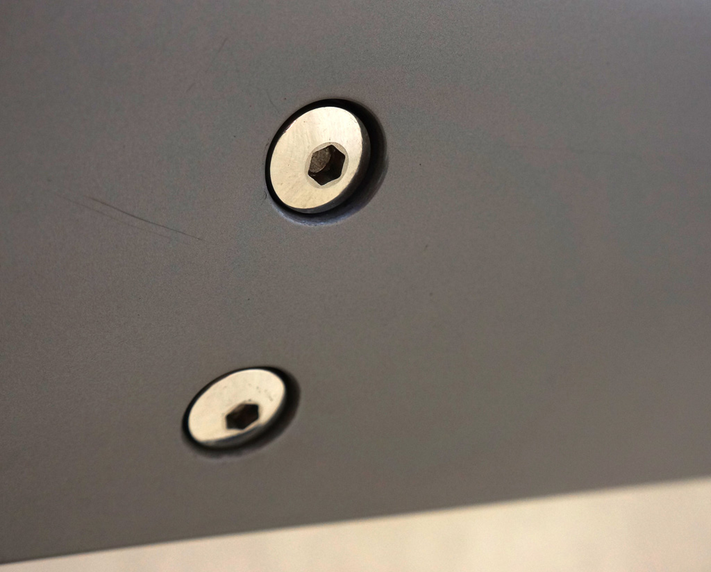

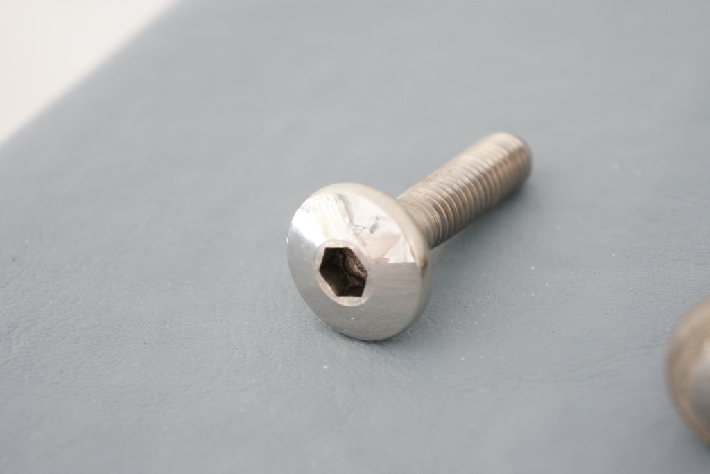

Second, In order to gain more access to the exhaust and have more room to work with I highly recommend taking the rear diffuser piece off. It literally takes 30 seconds, and since the rear bolts can also get nasty, you might as well take them off anyways to polish them up while they are off.

Once you have sanded down the exhaust and wiped it down afterwards with microfiber towel and ensure the surface is completely clean, you can move onto the next polishing phase. Setup your polisher by placing the Yellow Cutting/Compound foam pad firmly onto the velcro backing of the orbital buffer. I made the mistake of starting with just the Medium Polish pad first and wasted quite a bit of time as it was not "cutting" into the metal surface enough. Most pads are designed for automotive paint, not actual metal so you can go with a much more aggressive pad on metal than you normally would otherwise.
Once you have plugged in your variable speed orbital buffer w/ extension cord, shake up the metal polish bottle vigorously and then squirt a spiral of the polish on the pads surface. gently dab the pad (with the buffer still off) into 5-6 different places across the surface to spread the material around and prevent it from splattering everywhere. Once you have done so, then turn on the buffer at a slower speed (2 out of 6 in the case of the Griot's buffers). Work the polish into the paint in a rectangular grid pattern (think columns & rows). It make take a bit more polish at first to get started as the pad is completely dry, but once you have repeated this a few times the pad will require less polish as it is fully moist. You don't need to apply as much as you think, if you are doing it correctly you will get a nice grey glaze and the polish will eventually turn black. This is normal and is a good indication you are working the metal accordingly.

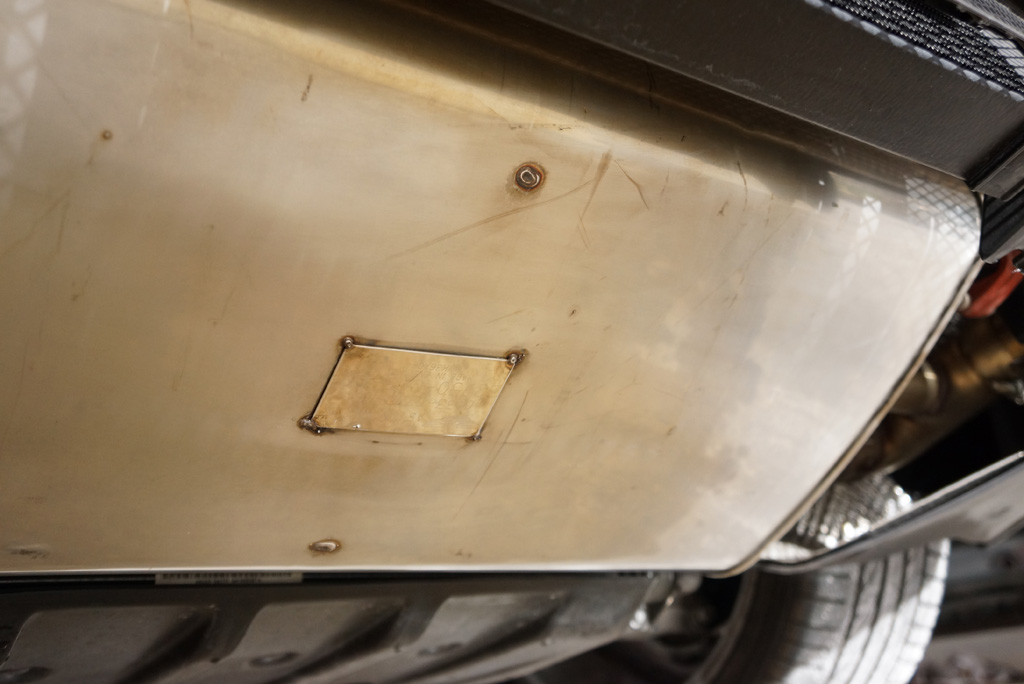

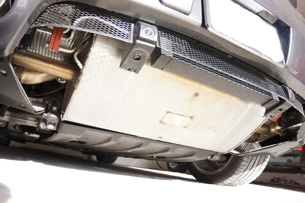

Although I have not fully completed this one yet, I will be finishing up the last hour of polishing when I get a chance in the near future. I have provided pictures of the progress so far to give you a comparison between before & after. Also, I have included closeups of the Aston Plaque to compare what a 100% mirror finish looks like compared to the 80%, its still not perfect, but heck of a lot better than it was. This is one of those modifications that simply has no shortcuts, you just have to put the hours in to get the results. The flip side to that is its extremely inexpensive to do, and you do not even need a lift to do it. You could take the exhaust off to do this, but that seems excessive as the only time anyone really takes off the boat anchor is to replace it with an aftermarket solution. This procedure is for those who fully intend to keep their exhaust. I did not include the cost of the orbital buffers and microfiber towels as most people already have these lying around their garages anyways and are already sunk costs. With that said, all it takes is a few supplies to make this job happen and it's something that ANYONE can do. The supplies may cost $30, but making the stock boat anchor look a lot less like a boat anchor is $Priceless$.
After having performed the polishing and removing Fuse 22, the exhaust feels, sounds, and now LOOKS like an exhaust worth of being on an Aston Martin. Its well worth the time for those willing to put in a little bit of Elbow Grease

(First Post has all the before pictures of exhaust to see the original condition of the exhaust, 2nd post has pictures of the supplies and bolts before & after, 3rd post has all the after pictures for your reference).
