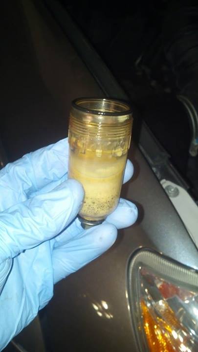

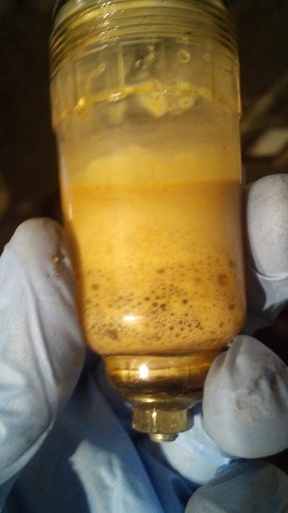

After reassembling my gas cap, I popped the hood on my 4Runner to empty out the makeshift catch can I installed on it. Apparently my engine is full of Starbucks latte.
The dark spots in the bottom are air bubbles, not debris. It's thick and foamy. I changed my oil only a couple hundred miles ago and it looked like normal used oil. It's probably just condensation built up in it and mixing with the oil it collected. Still, a bit disconcerting seeing as these engines have issues with their head gaskets as they approach 150k miles and I'm at 142k. My coolant level is fine, so it isn't sucking down coolant. So that's nice. I put the makeshift catch can on just to see how effective adding a catch can would be. Looks like it's doing its job quite well.
