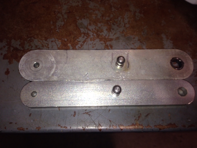

irish07, That makes sense. I think that when it does shift correctly in the cold, it somehow achieves proper alignment. Is the mod to the shifter surround difficult? Anpics of before and after?

The mod is SB0236, which includes updated transmission oil and the gearshift lever. Gearshift Lever part # is 6G33-7C270-AA.
Here's a poor shot of old and new levers
Attachment 326330
Awesome, thanks!
Attachment 326330
I had this service bulletin done to my car under warranty when new and it definitely made a difference.
