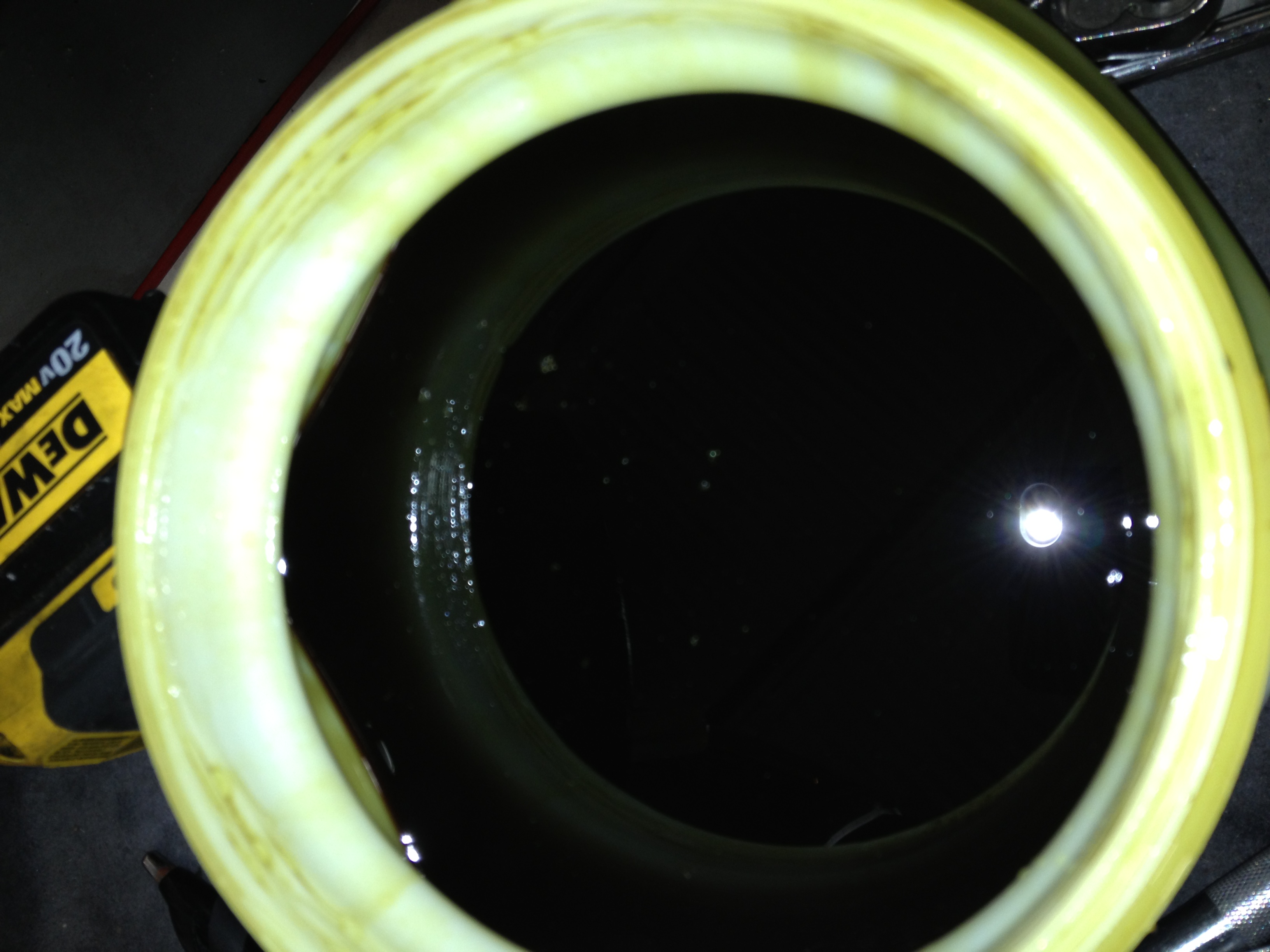

All,
Finally had chance to upgrade to Castrol SRF today. To my horror, the shop tech flushed out the stock brake fluid and you wouldn't believe it unless you saw it for yourself (picture attached below).
Brake fluid is supposed to be a golden amber like beer, what came out look like black sludge from the tarsands of Canada lol. As I has suspected, the fluid had not been changed in years, and the braking performance showed it. Any car that has not changed its brake fluid in the last 2 years will have similar looking brake fluid, and it will compromise braking performance more so than most people realize. It is by far the #1 most overlooked maintenance service of all.
I flushed the brakes and the clutch line and the effects are definitely noticeable as far as pedal feedback in both the brake pedal and the clutch pedal. Both the brake pedal & clutch pedal are about 10% firmer and the brake feedback is more linear and crisp than on the stock old fluid. Did a couple of very hard brakes in a row and there was zero brake fade. The clutch pedal feels much more like a conventional manual and definitely feels more like an aftermarket sporty clutch than stock (in a good way). Always felt the stock pedal was just a little too soft.
I was hoping it would alleviate the clutch pedal situation after a long hard high speed brake, and it did help a bit, but it still did not cure the problem completely. I know all the vantage brake lines are stainless steel, however I suspect the clutch line may be made of conventional rubber. The brakes never fade no matter how many stops I do, but the clutch pedal goes soft. So although they share the same reservoir something else is going on.
On the Ford Mustangs (which is the other car that most commonly exhibits this exact symptom as well), the forum guys claim its because the slave cylinder is so close to the headers that it gets super hot after a really long hard pull (2nd gear - 5th gear) thereby causing the fluid/hose to get too hot & soft. Usually after 30 seconds the everything returns back to normal every time leading me to believe the heat issue theory may have some legitimacy to it.
Not sure if the cure for this is a stainless steel hose or something else entirely, will need to investigate further...
Overall I am very happy with the change, even though it did not solve the high speed clutch pedal softness completely, it did help it and also significantly improved clutch pedal firmness and brake pedal feedback under normal driving. In addition, I performed some much needed maintenance with the peace of mind knowing I put liquid gold in the place of the stock black sludge.
Hope that helps,
007

Great post. I wonder if the discoloration is caused by the degradation of inside of the brake/clutch hoses.

Hey Aerome,
The discoloration is actually moisture (water) getting into the lines and breaking down the fluid. Has nothing to do with rubber. The stock brake lines are not rubber anyways, they are stainless steel mesh lines so it's not that. Brake fluid is hydroscopic (seeks water) so anyway it can get moisture it will. After roughly 1-2 years all average brake fluid looks like this, it has to constantly be replaced (which nobody ever does). Castrol SRF repels water the most out of all other brake fluids which is why it has by far the highest wet boiling point. Under normal city driving you could go 2-3 years probably without any moisture in the lines, under racing conditions at once a year is necessary. SRF is also 10% less compressible hence why it provides much more direct pedal feedback (less mushy pedal feel)
