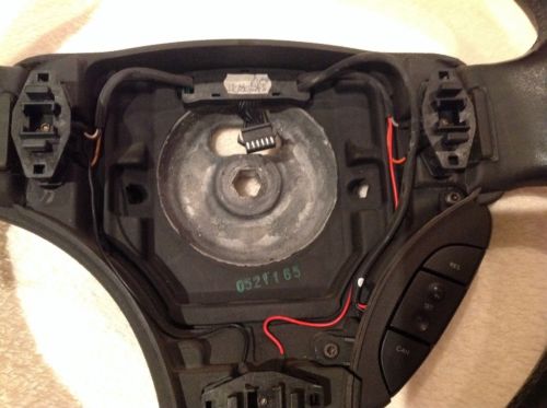

You can't get the loom, loom comes with the steering wheel...so you will have to get a steering wheel with cruise control, then have the PCM flashed by the dealer to activate the cruise option...I've done it a few times

Yes, buying the switch pack by itself won't help and the wiring is not sold separately. There is a different kind of wiring for every combination of switch packs. The wiring has the logic to communicate to the CAN bus built in, so it's not a matter of simply making your own wiring either.
Yes you can! You can order the wiringloom at AM factory for £154,60
I made them confirm it is the wiringloom inside the steeringwheel, the one with the 3 horn-buttons and CC-connector.
I too wandered down this road. My cable is in the mail, as we speak...
Regards. Ben

Irish was referring to the wiring inside the steering week itself. To my knowledge, this is not available for sale as a separate item. Are you claiming that you were able to get it separately? Please clarify. Here is a picture I took of the wiring in question along with the switch packs and horn switches:
Yup, the factory is sending me the wiringloom from within the steeringwheel; 3horn-button connectors and the CCconnector.
I was very surprised to learn it IS possible the obtain the loom seperately from the steeringwheel, since everyone is sure that you can't (incl. my dealer)....
Let's hope i get the correct wiringloom.
As soon as the mailman rings, I will reply
Regards. Ben

Update
Well it has been a bumpy road...
The wiring-loom from AML did not arrive. After a few weeks they told me some thing has gone wrong with the shipping.
In the meanwhile I bought a used steeringwheel with the cable, CC & telephone switches.
The AMdealer informed me the telefoon switches can be used in combination with the non-bluetooth phone unit.
This made me decide to cancel the not yet delivered new wiringloom and fit the (cheaper) compleet wheel from a second-hand-dealer....
Ofcourse this wheel also did not arrive.
The second-hand dealer told me some thing went wrong in shipping.
Come on guys, holland is only on the other side of the blue-stuff! No biggy?!
Since I allready payed for the used wheel I'll stick too that route, untill the boat sinks. Maybe than I'll give http://www.shop.britishracinggroup.com/ a second go...
Sorry for no news or to clearify the yes/no obtainability of the spaghetti inside a steeringwheel.
Regards. Ben.
