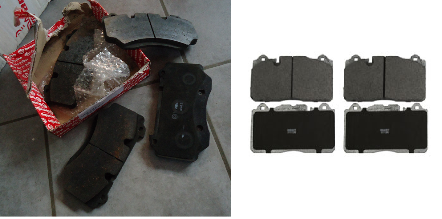

This is a picture that compares the OEM front DBS pads to teh AC Delco 171-1010 pads...
Something isn't right to me. The ZR1 disc looks identical to the DBS and so does the caliper. The pads on the right side of the photo would never fit the ZR1 front caliper. Maybe the P/N is wrong or the photo you posted?
I did a search online for AC Delco 171-1010...that's the image that came up when I did the search.
The pads on the left came off of a DBS...
Just a generic image. Those are not ZR1 front pads. You'd have to visit an AC Delco supplier and compare the DBS pads directly, unless you can get one of the ZR1 boys on CorvetteForum to snap you a real good photo.

rscultho Ive been doing research and even though the pads look different they will work. Take a look at the two links below. Both are talking about converting to steel rotors from carbon on a zr1 and f430. Pay attention to the pictures of the stock and aftermarket pads. You will see that they all look diffrient but fit the set up nevertheless.
http://cantechautomotive.com/2011/12...or-conversion/
http://forums.corvetteforum.com/c6-c...onversion.html
