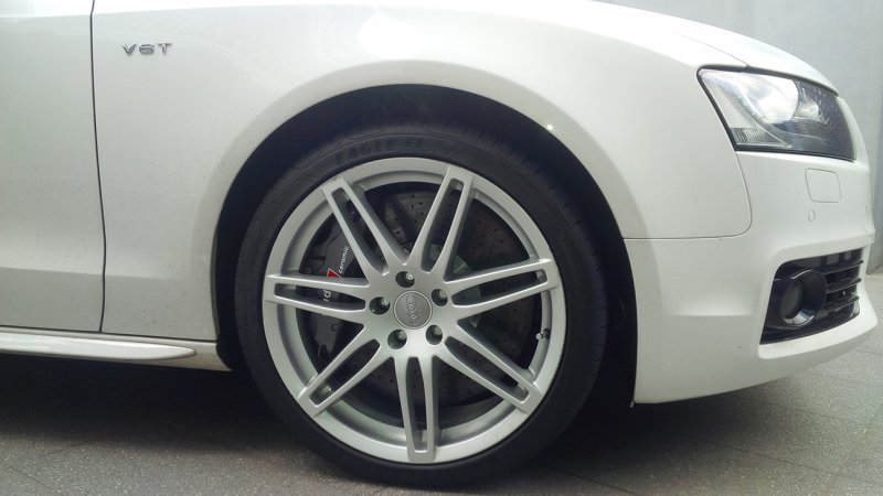

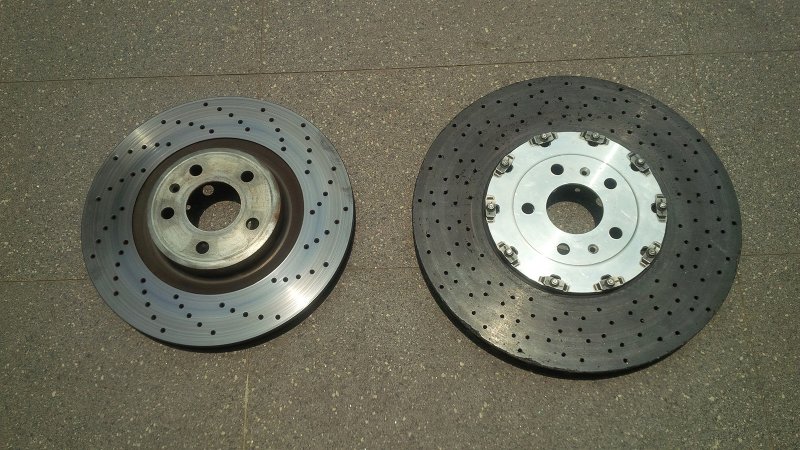

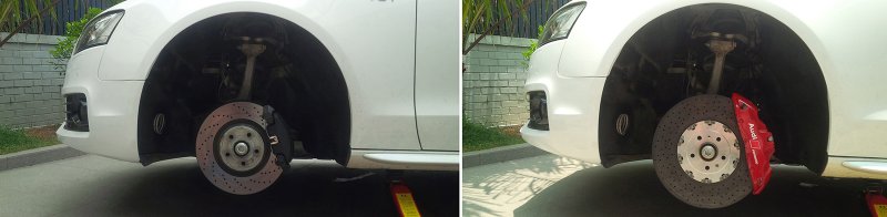

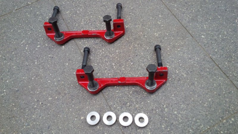

On the ceramic brakes topic:
My daily driver is a AUDI A5 3.0TDI quattro which has a standard AUDI S5 brake-setup on the front-axle: Single-piston 57mm / 2.25" on 345mm / 13.5" rotors.
I recently acquired an OEM Brembo 6-piston mono-cast which is fitted as option to the AUDI RS5, RS6 and RS7. This is the full Ceramic disc + pad-set which, when using a different Hat, is installed on the Lamborghini's and other exotics as well.
It came with an additional set of Titanium HATS (it's fitted on my AUDI with Aluminium ones) that looks like it may fit the DB9 [given the pitch]. Well, that's what I hope and at least I'm going to do a trial fit once my car arrives and will let you guys know my findings.
Needless to say that break-performance had quadrupled since converting from Steel rotors + ceramic Pads to Ceramic Rotors + pads: I'm only having concerns that my control-arms will soon tear-off under load.... Unsprung-weight has also greatly improved.
One last thing; the caliper just clears the inside of the 19" RS4-rim by 1/16" / 1.5mm. I'm keen to find out whether it will clear the standard 19" DB9 rim as well.
Pictures:
