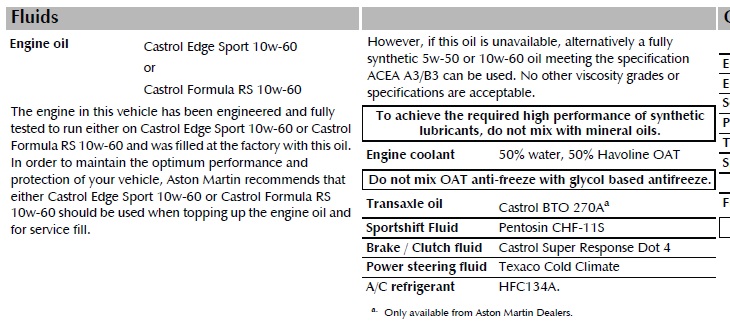

I'll stick with 10w-60 as manuf. recommends.
THe manual does state 5w-50 is acceptable however

Again, 007, the manual strictly states: "No other viscosity grades or specifications are acceptable". So why would you question the choice to stick with what's recommended or suggest for others to use something else because 10W-60 is too heavy?
Where did you pull this from? Everything I've seen in print states Castrol TWS (apparently now called Edge Professional). I've never seen any documentation saying Edge Sport, so I'm wondering where that came from!

The manual does actually say you can use 5w-50, see above post.

Yes, Chris, I was referring to using something much lighter than 5w50 or or 10w60.
