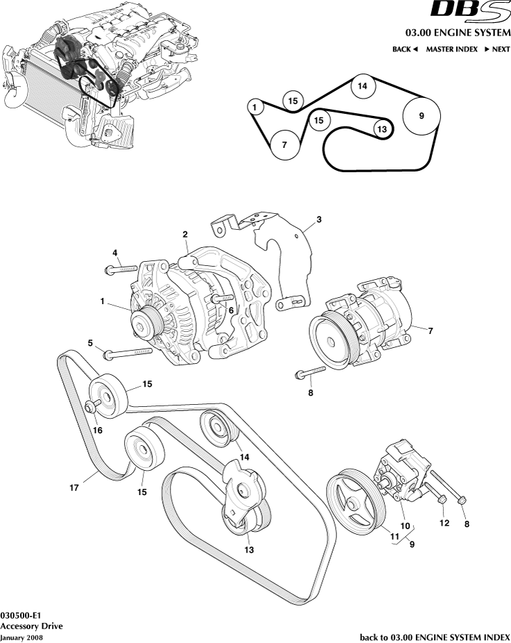

Engine layout on the DB9 is the same as the DBS. Looks like you can just take off the drivers side MAF and get to it from the top. Should be a simple swap and doesn't look like it would take too long if you have the right tools.
Item Part Number Description Quantity Remarks 1 8D33-10300-AA Alternator assy 1 - 2 8G43-10239-BB Bracket assy, alternator mounting 1 - 3 8G43-10A346-BA Heatshield alternator 1 - 4 702856 Bolt and washer, M10 x 97.5 2 - 5 W700454-S437M Bolt, flg, M10 x 150 1 - 6 703692 Bolt, flg, M10 x 45, alt brkt to cyl hd 3 - 7 6G33-19D629-AA Compressor assy, air conditioning 1 - 8 702557 Bolt, M8 x 100 6 - 9 4G43-3A696-AC Pump and pulley assy, power steering 1 - 10 4G43-3A674-AB Pump assy, power steering 1 - 11 6W93-3D673-BA Pulley, PAS pump 1 - 12 702558 Bolt, M8 x 60 2 - 13 05-85368 Tensioner assy, engine belt drive 1 - 14 1R12-05-10530 Idler pulley assy, groved 1 - 15 1R12-05-10488 Idler pulley assy 2 - 16 703702 Bolt, M8 x 24.5 3 - 17 4G4E-8620-AA Belt, engine drive 1 -

After some deep searching I did find the thread thanks to AMFixer...thank you for the help though Don...Doughnuts should have jumped off the page, but it took me a while to see the obvious title.
I am discouraged by the outcome and not looking forward to the cost of my 5 seconds of fun...I had just lost my brand new Aston Martin 100th anniversary cap during a 125 mph speed run and was whipping a u-turn to retrieve it...expensive hat indeed...LOL.
Bolts 8 & 12 are not easy to access, but I'm going to consider DIY on this one...and change all the lines since my car has the original lines which cause judder at low speeds on occasion...there was some kind of service bulletin on this.
The drive belt is easily accessed from the bottom, but I'm going to talk to my new AM mechanic friend and see if he can offer a reality check on the DIY idea.
