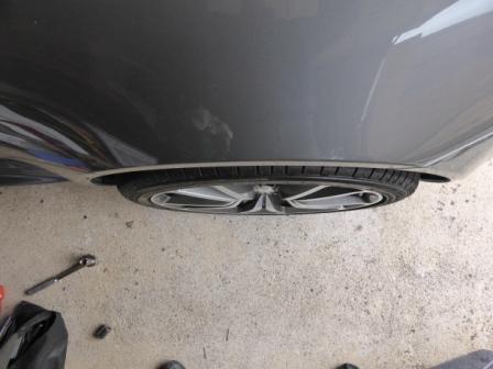

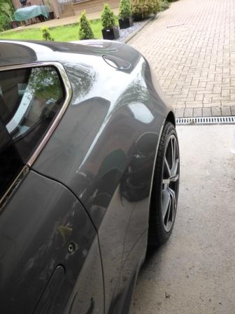

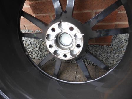

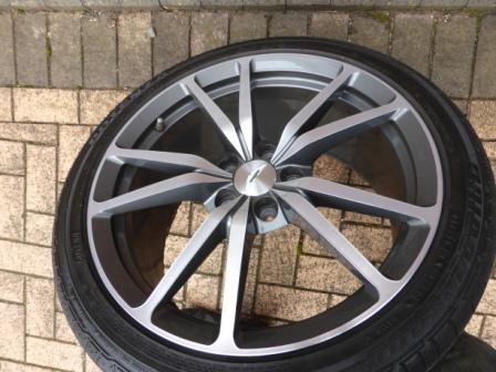

Are those the wheels in the 2nd and 3rd pics above? If so, then they are the same as mine. Those H&R rear wheel spacers that you have will go straight on, I fitted a pair to my car last weekend, and AM has thoughtfully put a hole exactly where the original studs stick through. Perfect.

Yup. Those are the wheels and I was planning on using my spacers. They also fit the old sport pack wheels without modification but just barely. Have you posted any pics of your car with the spacers yet?

Hadn't posted any pics until now - this is the car straight off the jack
ID:	380217   Click image for larger version

And these are the wheels
ID:	380221   Click image for larger version
