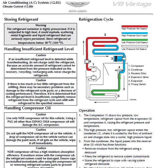

according to the shop manual you can't just add refrigerant you have to purge the system and recharge to the correct amount.

For the age of your car and wtv mileage, there's no reason why the system is empty unless it's leaking. Now either there is a mechanical/electrical issue here..or the system is low on R134a due to a leak, which will not allow the system to start to prevent damage to the compressor.
You can buy one of those diy kits but will cause more damage than anything..the system needs to be dry of moisture, if there's a leak, moisture is in the system and will cause damage to the compressor..depending on the leak there could also be dirt in the system with will require a new r-dryer and a flush of the system
Proper procedure is to fit a R134a pressure gauge to the high and low sides, see if there is pressure and what levels, that will determine weither it's a leak or mechanical/electrical issue to diagnose..
If it's a leak, the system will need to be filled with 250-300psi of nitrogen and inspected. Depending on local law..like my Province, I can get fined $500-2,000 if I fill a system that I "know" has a leak..also to fill an A/C system with R134a, some local laws require you to have a license to handle ozone harming refrigerant. The cans you buy in the store for the diy jobs are not R-134a, they are just 134a, which means there are not refrigerant, no license needed..
I know it's easy to buy a diy charge can and see what happens, just the cars I've seen from these diy cans require a compressor in due time because of the moisture that was left in the lines, compressor's for a DB9 are starting around $1,200..so I would suggest visiting your dealer to see what direction to go in..mechanical/electrical/leak. You can try indie shops to diagnose the system, but they will not be able to scan the body computer of the vehicle to diagnose the mechanical/electrical side of things, they might be able to "figure" it out but after how many hours of labour?!
