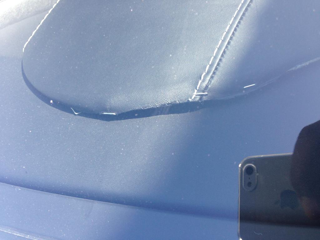

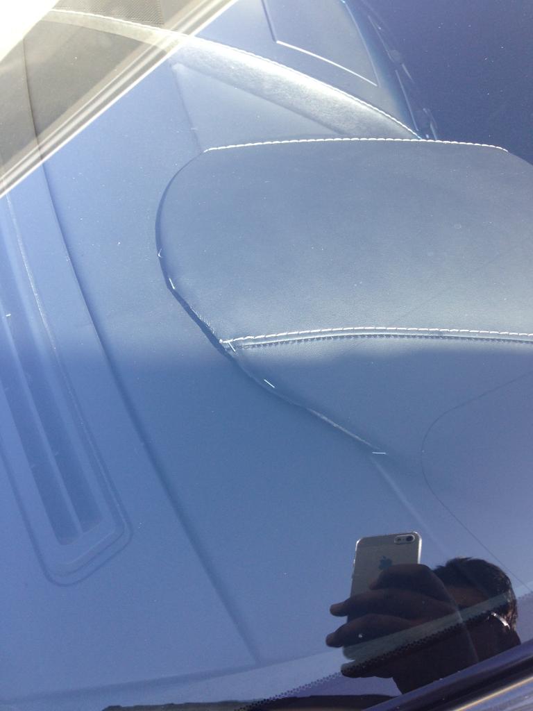

My leather trim is falling off. Please see pics.
Itsa above the steering wheel.
How to you take this piece off? I would like to take it to a shop and get them to re staple it But id like to take of off myself.

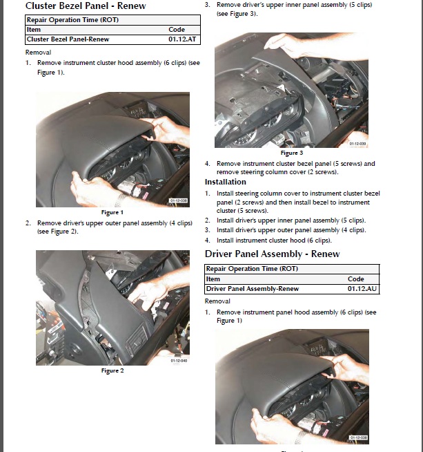

according to the shop manual, only six clips hold it in place, here's the page, not terribly helpful, but perhaps karl can chime in on this.
and here's a thread on options for replacement: https://www.6speedonline.com/forums/...ter-cover.html

It literally lifts right up. Just use a proper automotive trim tool and protect the leather from scratching. This should be an easy repair for any qualified individual to make it look as good as new.

I'll take it out (by lifting straight up) and take it in and get it re stapled.

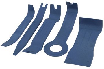

I keep meaning to buy a set of the plastic trim tools as you suggested in one of your threads and have yet to get around to it!
Karl, do these tools like they'd do the job?
Amazon.com: 5 Piece Automotive Body Work Trim and Molding Removal Tool, Non Marring No Scratch: Automotive Amazon.com: 5 Piece Automotive Body Work Trim and Molding Removal Tool, Non Marring No Scratch: Automotive

Yes, those will work fine. You can also find to set at Harbor freight for pretty cheap if you happen to have one of those stores near you.

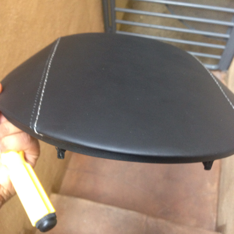

All fixed! Thanks guys for help. Upholster shop did it. Name:  image-4223844363.jpg
Thy had to take out the whole leather and move it up as there was spare leather below.
Can't believe they charged me $45. I'm sure if they knew it was for an Aston it would have been $145. Lol
