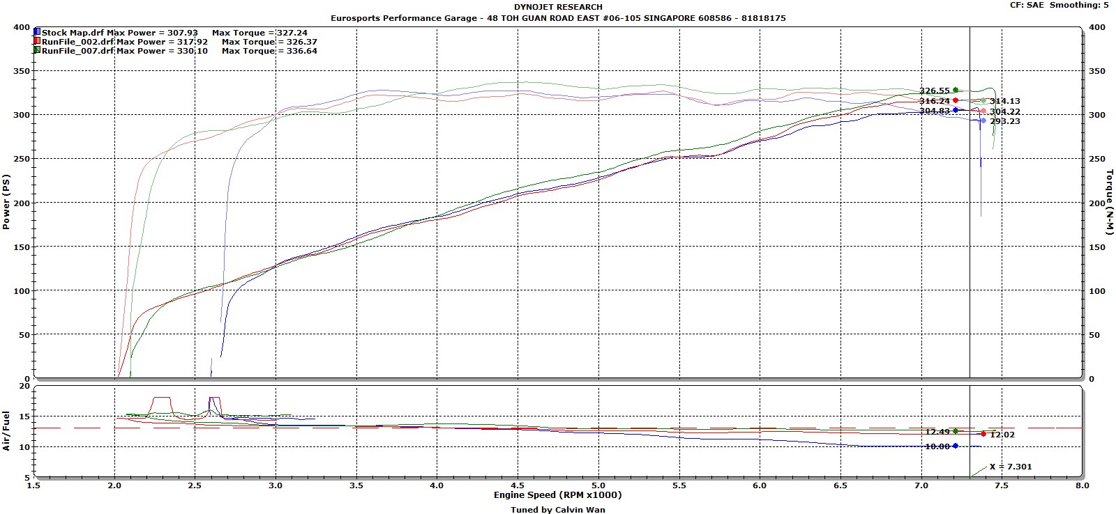

Dyno results
From Stock (Blue line) to headers, decat, filters & ECU (Green Line)
Peak power went from 304whp to 330whp.
Red line is only ECU tuning.
Torque seems to down in the 3-4k range. Anyone with same experience?
The headers change the sound of the exhaust note and combine even with the stock exhaust it makes a lovely sound
Will post some sounds videos when I have the time.
Name:	aston dyno 3.jpg
Old Jul 21, 2014 | 08:09 AM
biggynuts01's Avatar
Joined: Nov 2008
Posts: 90
From: Orange County
biggynuts01 has a spectacular aura aboutbiggynuts01 has a spectacular aura about
What mods are done with the red line?
Only ECU tuning.
A stock 911 2006 C2 did 273whp on this dyno
The mileage between the base line and final dyno (green line) was about 300miles
