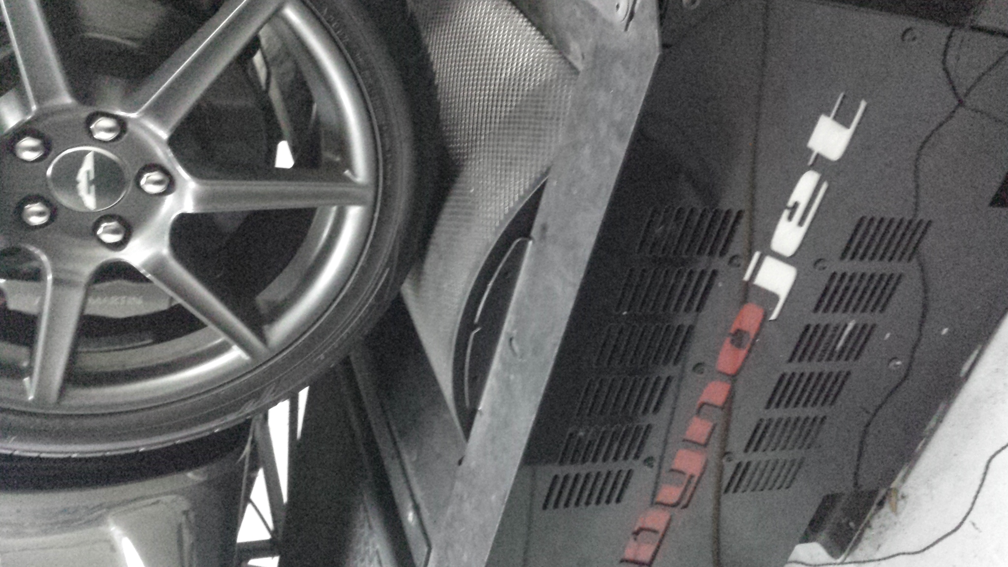

I just got a set from Stu. Looks great and can't wait to get it installed.
I have already done a base line dyno to see the power gains.
Anyone with installation tips for the headers?

Awesome, can you post baseline numbers? Curious to see what dynojet numbers are for bone stock car.
Are you running headers with stock cats? Or do you already have aftermarket cats on the car?

that picture shows the mini dynojet. (not the benchmark, 248e) But, still would like to see the dyno numbers for baseline

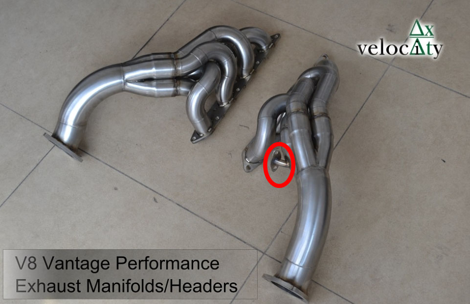

Help help!!
I sent my car in to get the headers installed and when trying to fit the right hand side header, the mechanic found that the EGR pipe is missing.
The car is on the hoist and the mechanic has asked whether I want to seal the EGR pipe and install or abort the install and wait for the correct part to arrive.
What do you think I should do?

Are there two versions of the headers? Did maybe some years had EGR and others did not. Check with Stuart to see, maybe they just sent the wrong one and it's an easy switch

Wondering if the CA cars had EGR and ROW did not...(ROW=Rest Of World)

It looks like the Singapore cars have EGR as well. Will the car still work properly if I don't connect the EGR pipe to the exhaust?

It may work properly, but will probably show emissions fault light constantly. I am assuming the EGR on the car is electronic. Years ago they were mechanically actuated by vacuum dashpots and you could disable them on certain models without any check engine lights. Pretty sure that's not how they are now though.

You need to have the right set, otherwise EGR fault will be continuous as Art suggests

Thanks for the help.
Stu is going to send me a new set.
