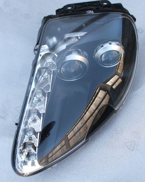

can you post the pics of the two types of LED bezel light styles?

Here they are. The ebay image is the newer style headlight bezel style. It's nice, but I do like the older style a little better.

FYI: There is yet another style not mentioned here so far. Both the V12VS and the GT have black bezels instead of silver.
