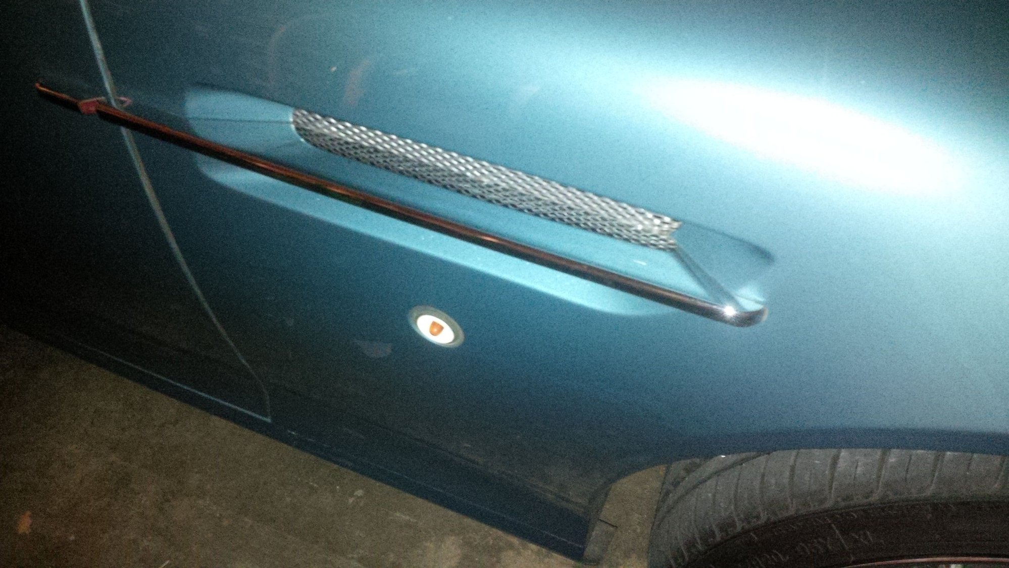

This fell off sometime today. What is the exact name so I can order a new one?
Thanks in advance.

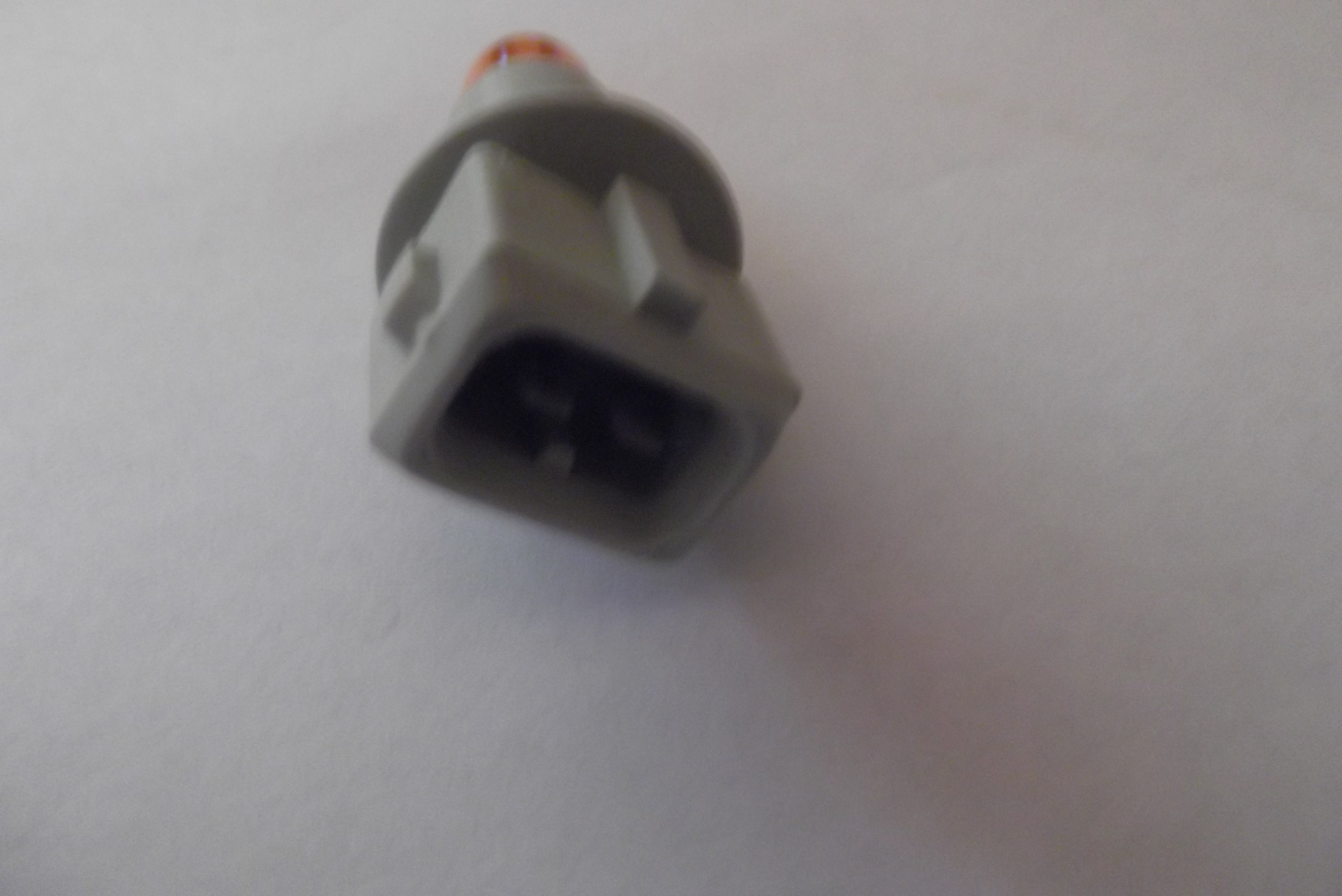

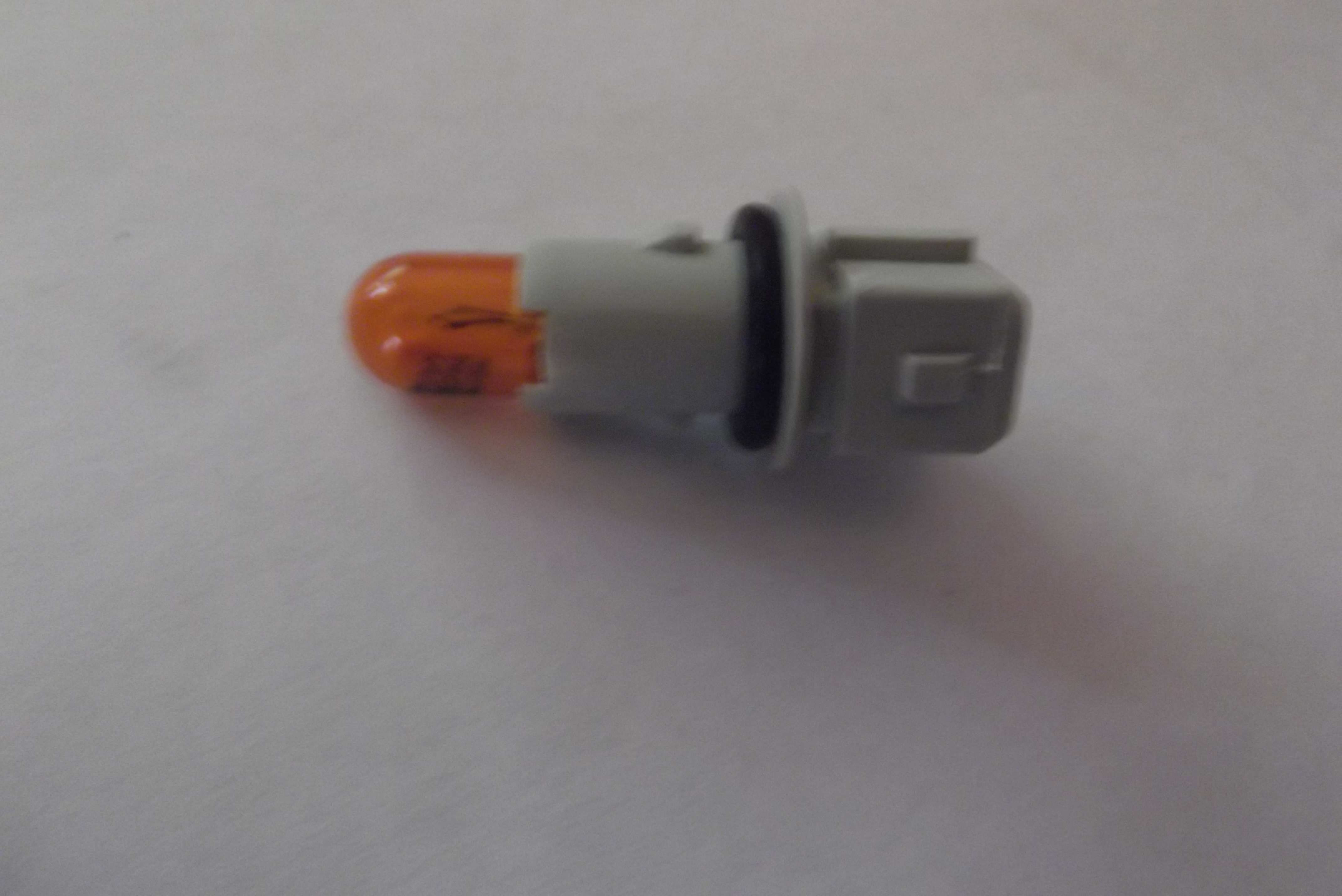

. IF your very lucky ! I have heard of someone being lucky enough to get the white plastic to easily turn and be removed from the outside of the fender. There is not much to hold onto, see pic of grey piece ( with bulb) that's attached to the white cone. I believe you risk damage using tools to attempt to grip it from outside. The white exterior plastic piece can be VERY HARD to twist. Get your new parts first to look at configuration. Take your time, Good luck.
