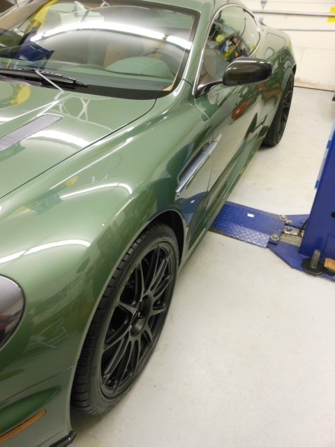

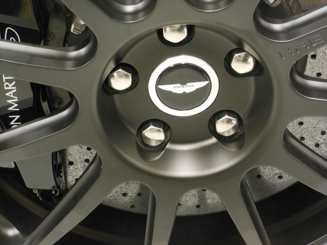

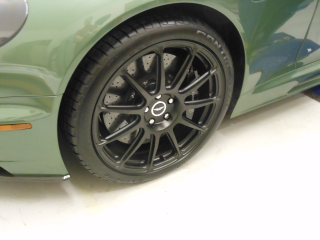

Old Oct 3, 2014 | 01:11 PM
XJRS Owner's Avatar
Joined: Jun 2009
Posts: 2,161
From: Northern CT
Rep Power: 144
I'm selling my black 20" HRE P43SC wheels; decided they really weren't for me. They are in excellent condition and I'll let'em go for a really good price (PM for details).
8.5 x 40 mm and 11.0 x 39 mm
Custom machined aluminum wheel caps are available as an extra, otherwise they come with the stock HRE caps. AM OEM caps don't fit, but the stock lug nuts do.
