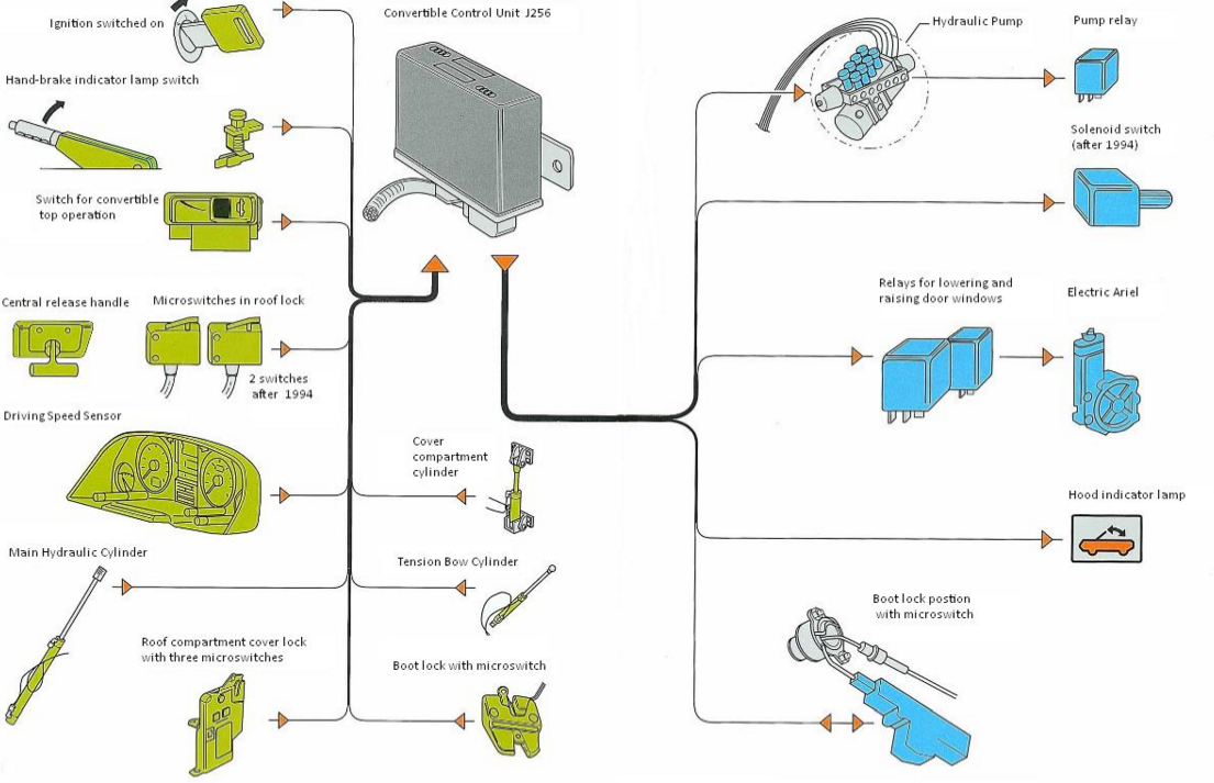

This is a simplified version as to what is connected to the CRM.
Where and how did you get this info ?

http://www.audifans.net/ftopic-34798-0.html
Other vehicle Convertible Roof Modules operate very similarly to that of the AM.
Additional detailed CRM information is in the website for those whom may be interested.

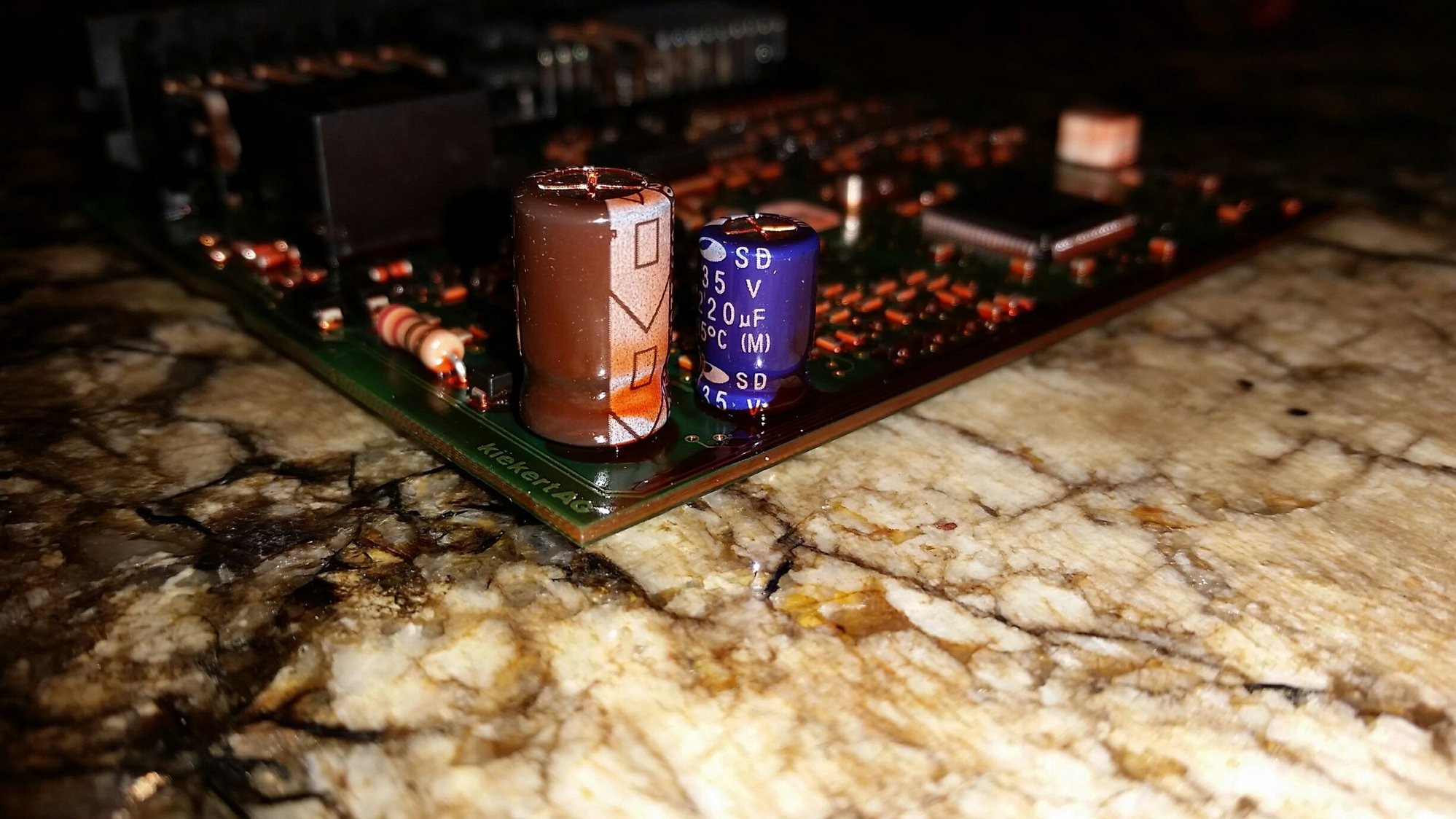

I replaced the two round capacitors (220uF as shown) and one resistor to no avail. The problem with failure is apparently in another conductor. I intend to evaluate the CRM circuit board. (note: I am a true layman at electronics).

I replaced the resistor. (just to the left of the capacitors)
Note: Although different sizes, the capacitors were the same, 220uF.
(Can someone please explain that to me?)
Again, this was no help.
Thanks.

I have a friend with descent knowledge of PCB repairs, when he looked at the CRM he thought it will be almost impossible to repair, as testing the circuit to find out what's defective is very difficult
