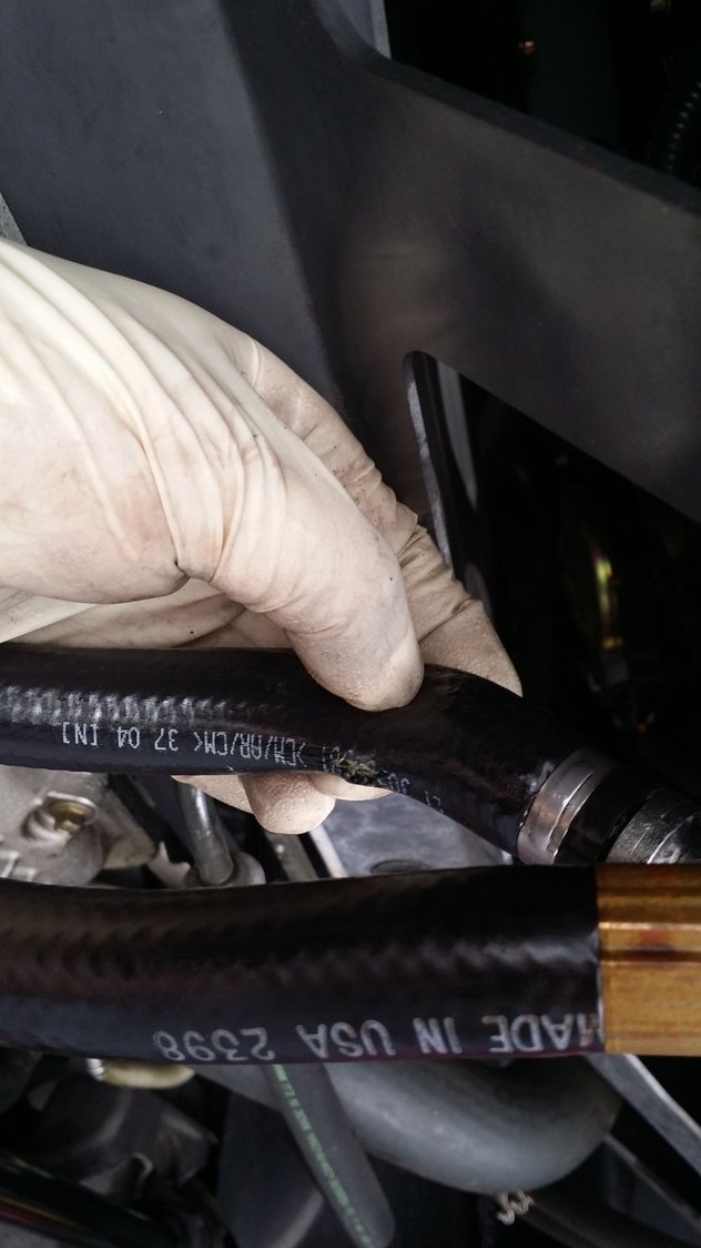

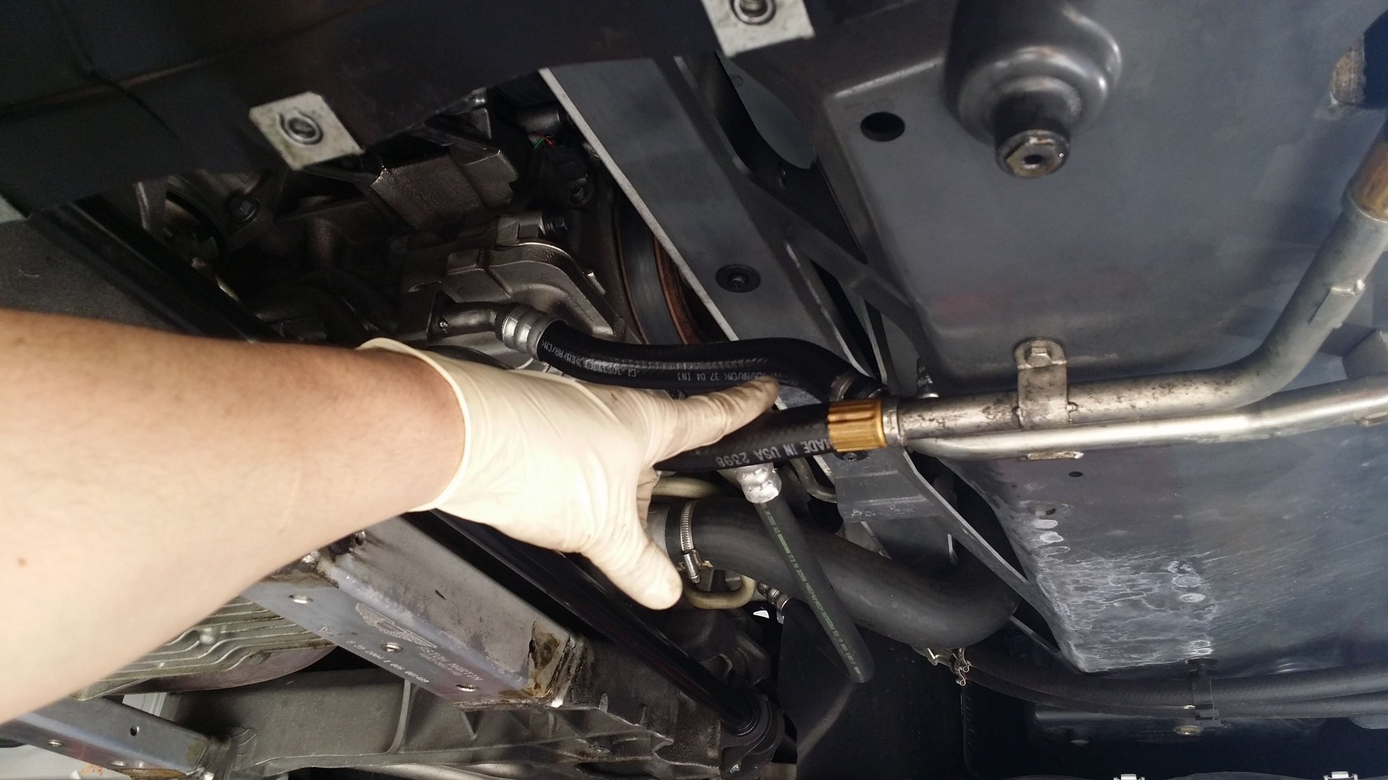

The Service Manager's note: On the first picture, you can see very clearly, just below the technician's thumb, where the line ruptured. This is the forward section of the cooler lines, near the radiator, just under the front of the engine block.
I'll share other explanations from the mechanic & detailed cost information tomorrow.
Below are the pictures. My initial thoughts are:
  • Big mess for a little hole
  • How does the hose fail?...car is garaged & had just 30K miles on it...although it is 10 years old. I've had many other cars with many more miles & similar years never have this issue...including Fords
  • Is 8 hours of labor the norm?
  • Is the hose fail a symptom of an old or faulty hose, or caused by a pressure problem?
  • Can this at all be related to the oil change & brake fluid flush performed right before the hose failed, or just a crazy coincidence?
  • What can other Forum members do to avoid the problem?
  • What other hoses should be replaced in a 10 year-old DB9?

Yep that's a common place where they fail. The reason that hosed failed is because of a couple of different reasons: galvanic corrosion, cheap supplier, and no flared ends on pipe work. I would strongly suggest both hoses get replaced otherwise the other one will fail in the not to distant future. AM really dropped the ball on the transmission cooler lines and it really was an elementary mistake that should of never happened! Good news is, once the hoses are fixed these cars are bullet proof. Thank your lucky stars you didn't damage the transmission when you lost fluid, the Aston gods must like you! Now would be a good time to purchase a lotto ticket because luck appears to be on your side.

My thoughts, though I'm coffee deficient so I apologize if I'm off or restating the obvious:
  • Big mess for a little hole Not surprising it'd make a mess - the coolant is under pressure when at operating temps and when that hose ruptured it'd spray out.
  • How does the hose fail?...car is garaged & had just 30K miles on it...although it is 10 years old. I've had many other cars with many more miles & similar years never have this issue...including Fords It shouldn't fail, that's for sure! Especially in that specific spot on the hose. Very odd.
  • Is 8 hours of labor the norm? Looks like they have to replace the hard lines as well, plus refill the coolant afterwards. 8 hours is a long time, I'd assuming removing the hard lines and refitting new ones take up the bulk of it.
  • Is the hose fail a symptom of an old or faulty hose, or caused by a pressure problem? Seems like a faulty part to me. Age shouldn't matter on that, especially if it's only 10 years old.
  • Can this at all be related to the oil change & brake fluid flush performed right before the hose failed, or just a crazy coincidence? I'd say coincidence, unless the hose was damaged while they did that - but since it's happened to others I'd rule that out.
  • What can other Forum members do to avoid the problem? If AML fixed the quality issue of the part, you should be good. If not, a good shop can replace those rubber hoses with braded stainless.
  • What other hoses should be replaced in a 10 year-old DB9? Not sure, sorry

The hose marked "made in USA" is an aftermarket repair, if you look at the crimp fittings they are copper instead of aluminum. The issue was present before with hoses leaking. They still should have informed you of additional repair needed with the last engine oil change. Those are things people that know the vehicle look for. On the repair invoice it looks as if you just got hoses done, no oil cooler replacement? 10 hours or even 8 hours is too much. Should be 4-5 hours. Did they top up the coolant that they didn't check on the oil service?
Spot on
Labour might be right considering all the under tray has to come off and go back on after.
I'd be changing them all to braided hoses
We have the same issue with oil leaks on air compressors in our business
Braided hoses are the way forward for hot oil at pressure.
